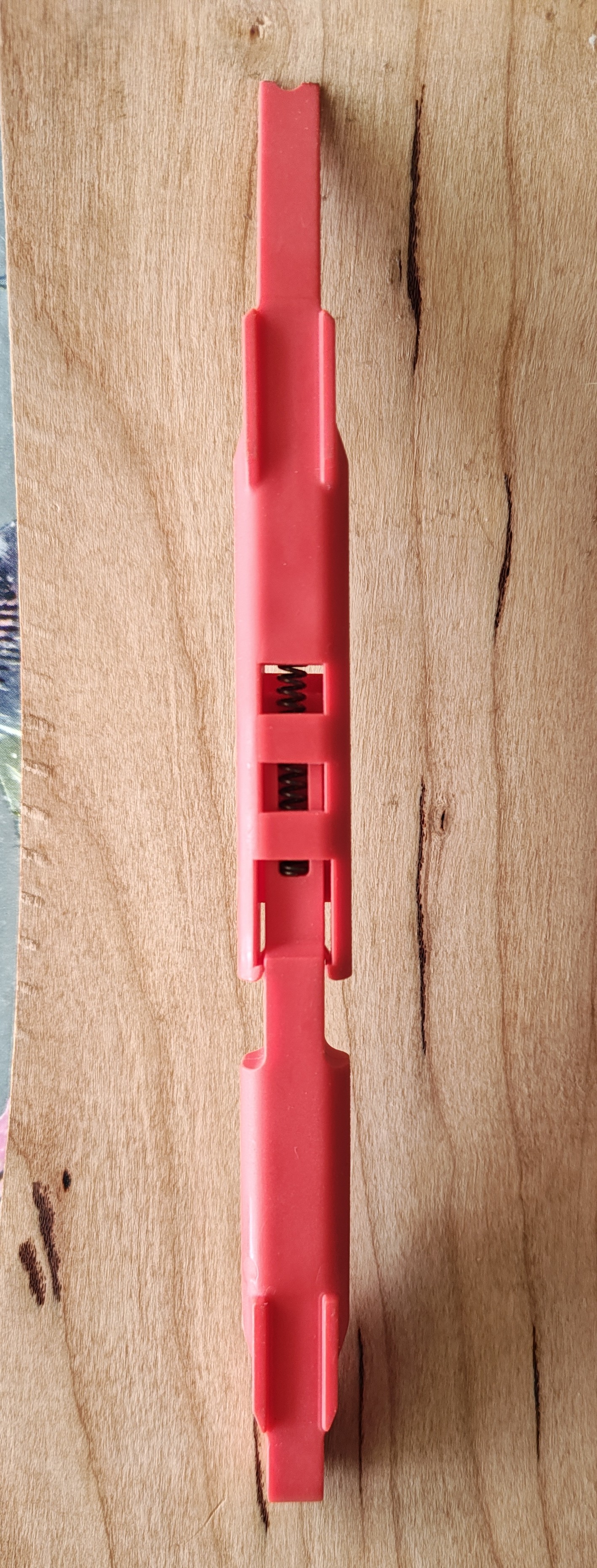

  • Posts: 6,140
    I used this gizmo occasionally to smooth out some spots. It works surprisingly well.
    Posts: 502
    Hmmm, I have absolutely no idea what I'm looking at Buco! Tell me more please!

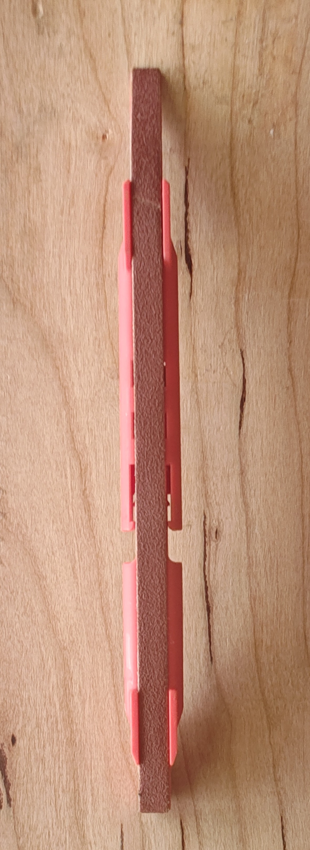

  • Posts: 6,140
    Jangle_Jamie
    Posts: 132
    These pictures are very pleasing. You have a wonderful eye, Buco! Did anyone else know this about him?? What other secrets do you hold??
    Posts: 502
    Ahaaa, thanks! I shall have a go at making my own version with the correct profile.
