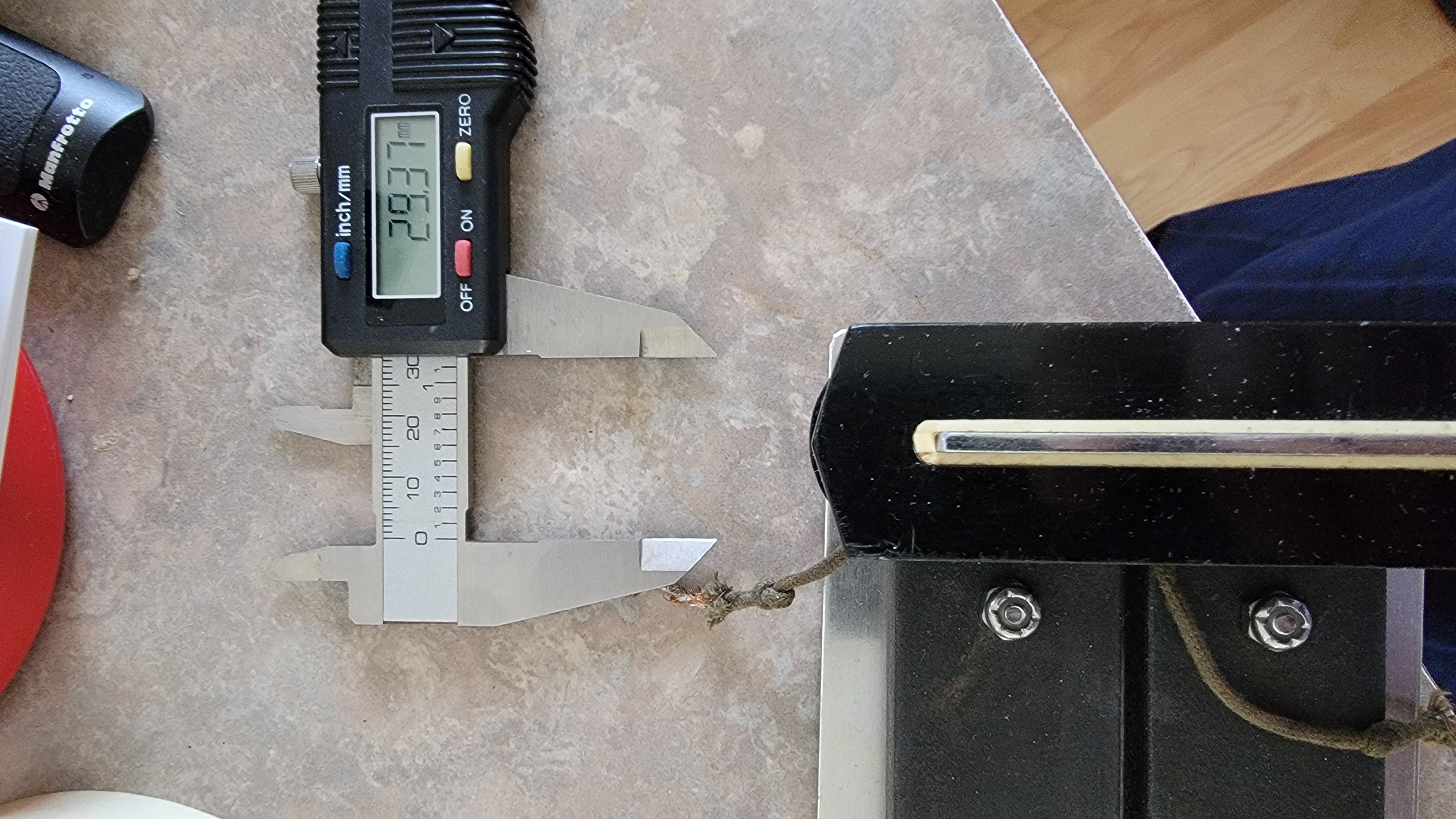

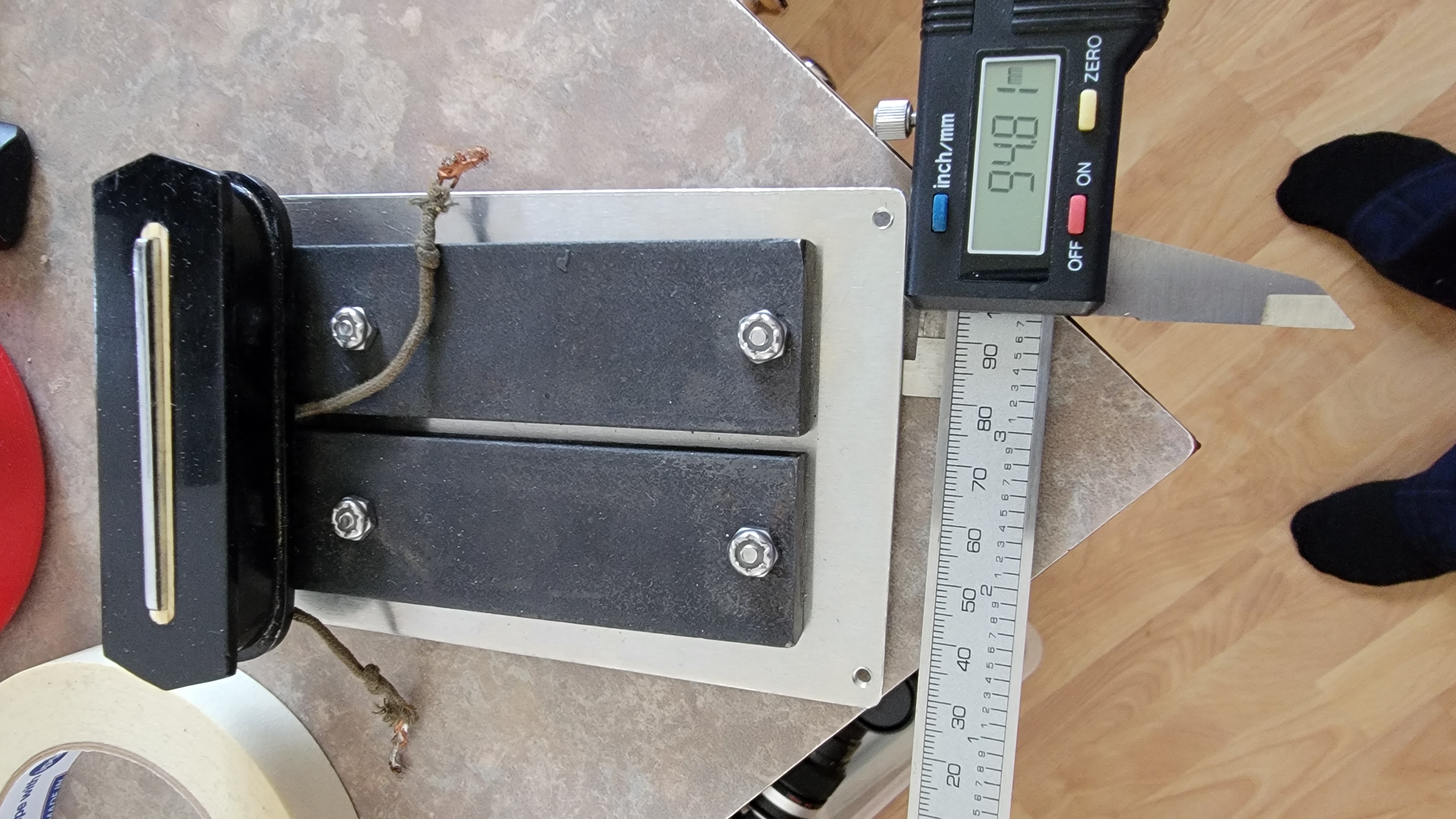

The pole blade is about 2.5" wide (63.5 mm) and 0.097" (2.5 MM) thick.
The hex-shaped bobbin is 3.73" (94.8 mm) wide, point-to-point, and the 'height' I might not have memorized. a little over 1-1/8" (29.4 mm) tall IIRC.
Oh, I have photos. The caliper width looks small compared to the bobbin height because the caliper is on the table after the measurement, about 1-3/4" (44.5 mm) lower than the bobbin.
