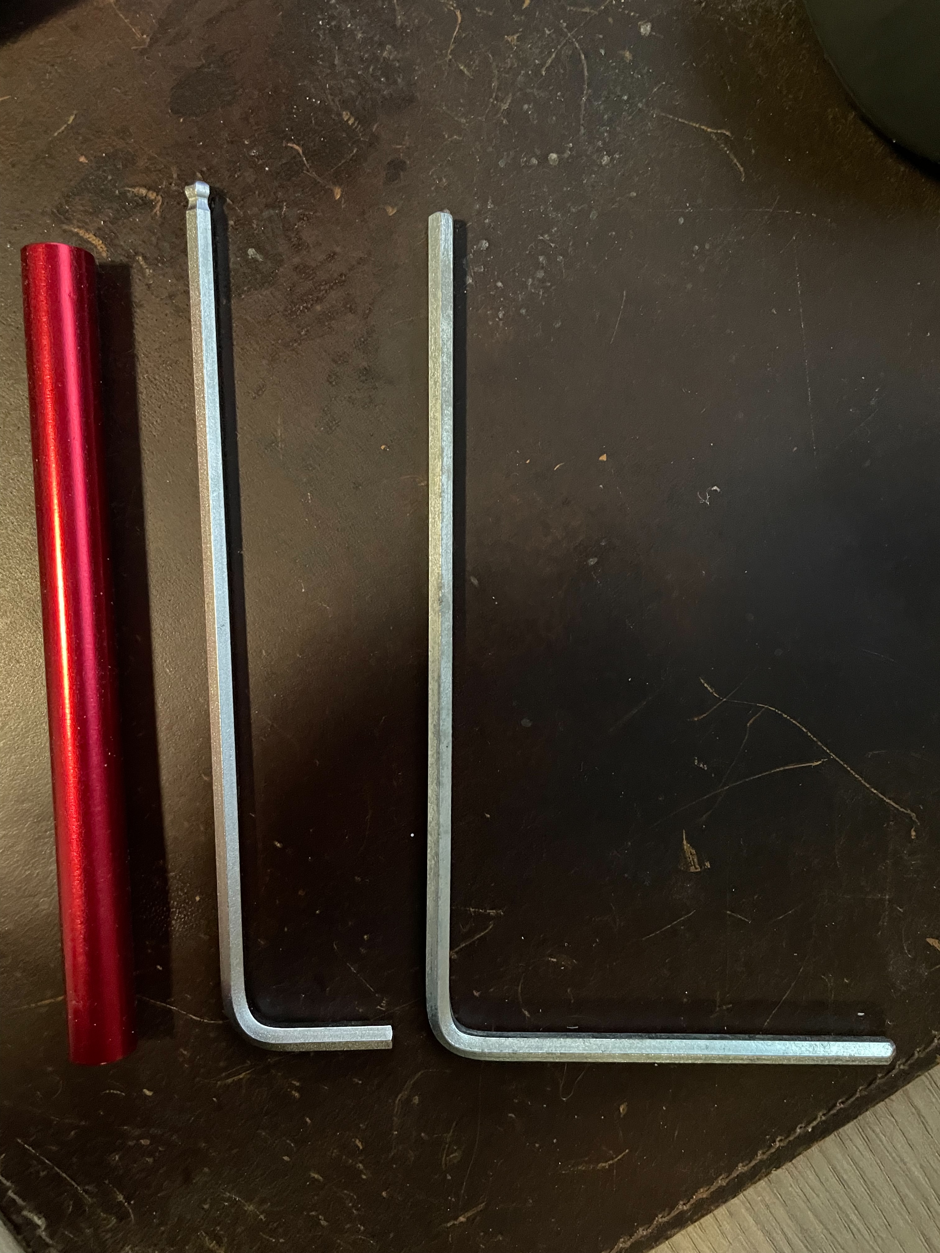

    Here is a photo of the DuPont truss rod wrench next to a standard ball end wrench you can get from a hardware store. Also included the bit of pipe I use on the end for leverage once the wrench is engaged. The length of the long end is 5.5 inch (the part you will need to pass into the hole in the upper traverse brace and then into the truss rod).
    While I agree with the above statement for adjusting relief, you should be able to tell if it worked for the rattle instantly. Some rattles cannot be solved this way and will been to be fixed by a luthier, usually by drilling out a fret marker and injecting something into the cavity that houses the rod.
