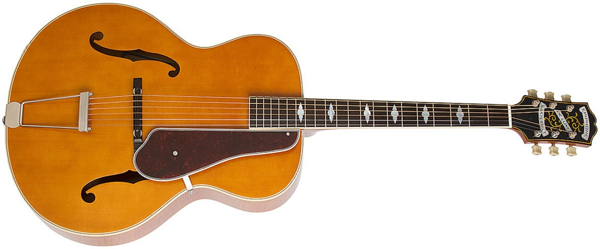

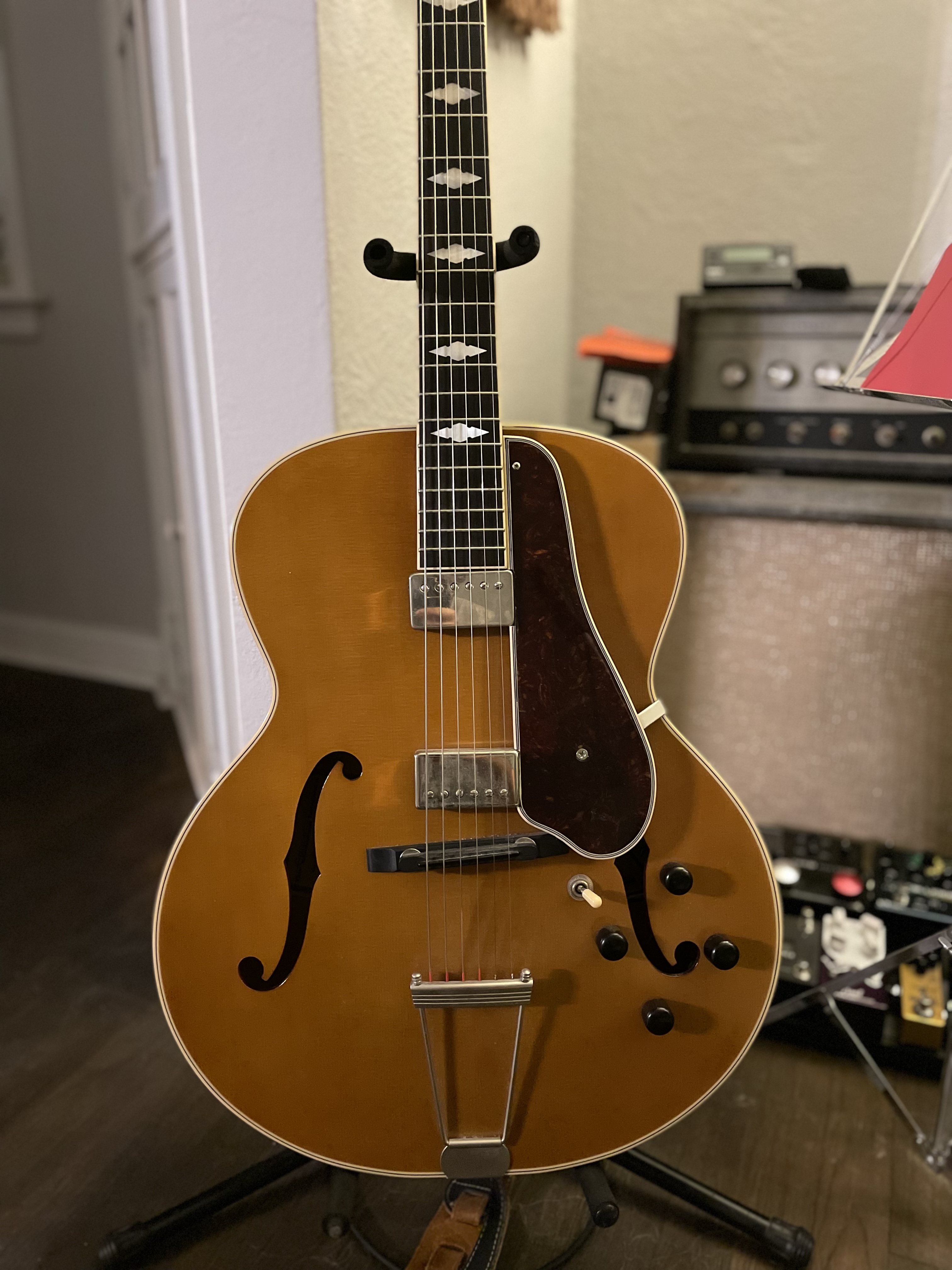

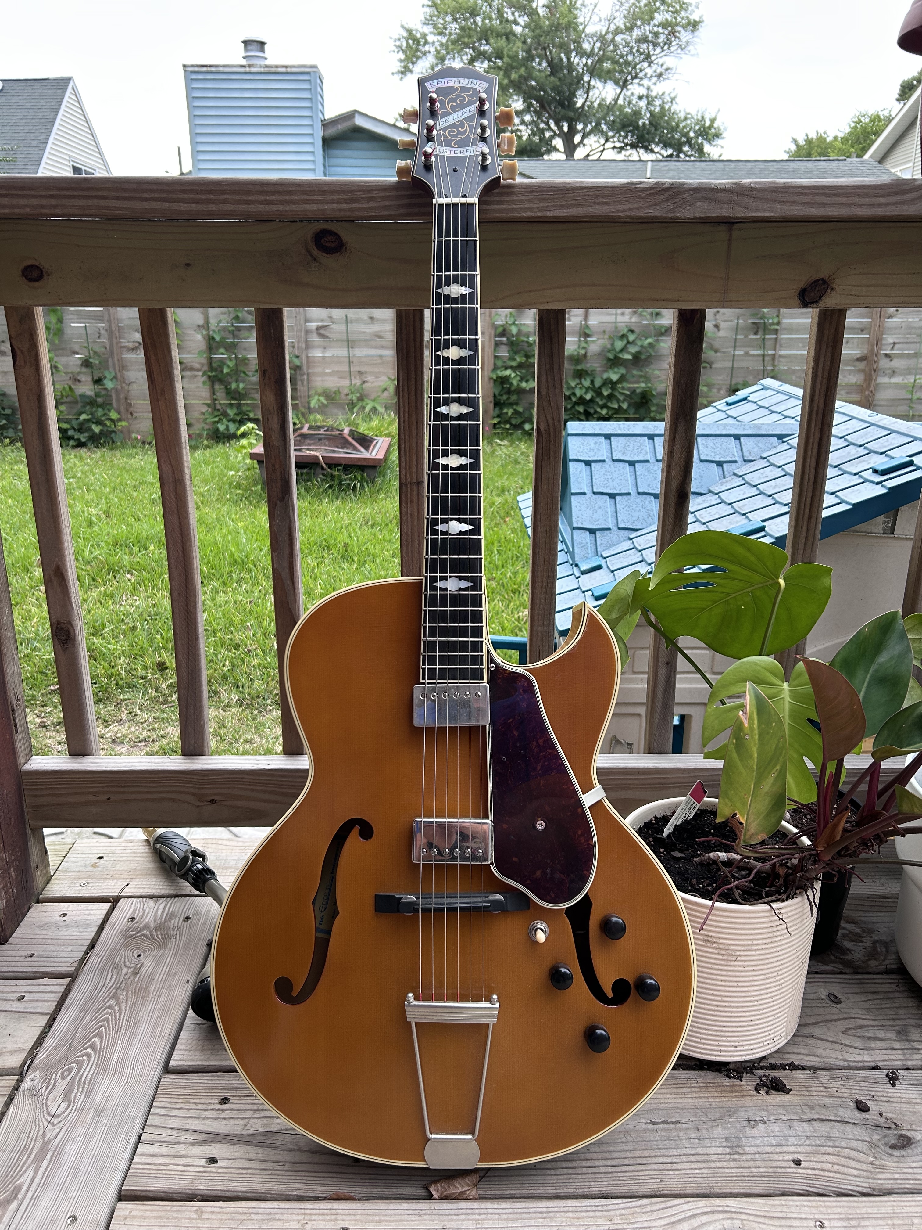

Just wanted to show you guys my modded archtop. It started as a regular Epiphone Masterbilt DeLuxe. At the time I was a touring musician and needed an acoustic for an unmiked encore but also an electric for the regular set. I added Kent Armstrong floating pickups but got into Pasquale Grasso at the time and then changed them to PAFs that I modded by making them floating. After a few years I found I wanted more upper fret access and the guitar had devalued some so I made the decision to give it a cutaway. It plays well, sounds alright acoustic but isn't super loud (all the mass of pots on the soundboard even though the pickups are floating), and I've been able to use it for a few recordings so far. It still has the crappy piezo bridge and electronics inside but that never gets used.
How it started:
Mid Process:
How it is now:

    No, it's not a great sounding archtop but the tone is noticeably diminished when I tested the pickups touching the top. I just also like modding and building electric guitars, thus the customizing. This was a good way to learn how to do wood bending and Florentine cutaways which I hope to eventually do when my kids are older and I have more free time. It has a cool thuddy sound on the low strings unplugged, which I've actually used for recording in a more percussive, palm muted way for my rock band. Kinda like tic-tac for power chords and little lines. It's an interesting sound.

    It's ok, had a long day. It really only gets used for my hack jazz recordings that my friend sometimes recruits me for, or playing unplugged at home. When I did have to bring it out into the crowd for those encore things it never was loud enough (shoulda gotten a GJ guitar back then 😉).
    The neck pickup especially is fat because it's jammed right up against the end of the fretboard.
