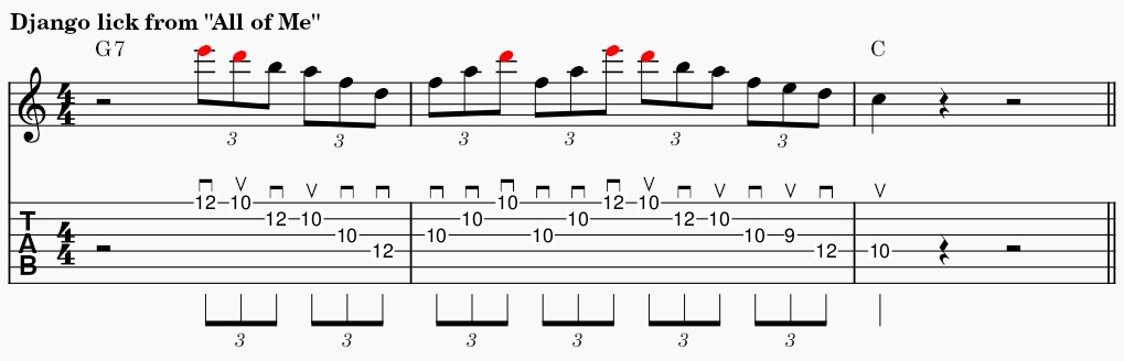

OK, so I transcribed Django's version of All of Me a while ago. All the solos. It may not be a perfect transcription but basically I'm being content with it. But there's that super fast guitar lick in the last chorus (bars 111, 112 and 113) that I have a real problem with. If you listen to the last chorus once you'll know what lick I'm talking about. I came up with something that kind of fits but I can't play it. Has any of you played that lick and what are you playing there? I'm trying to practice what I've written but I don't seem to make progress.
Anyway, here's what I have currently written down for it (Note: the red coloured notes mean nothing, it's some Musescore quirk):

    I'd try going 12 on E and 15 on B for the first two notes and play it up a position (1st finger on 12th fret). It might help with the double downs you have on that first part.
    Just a thought.

    and start the first note with an upstroke.

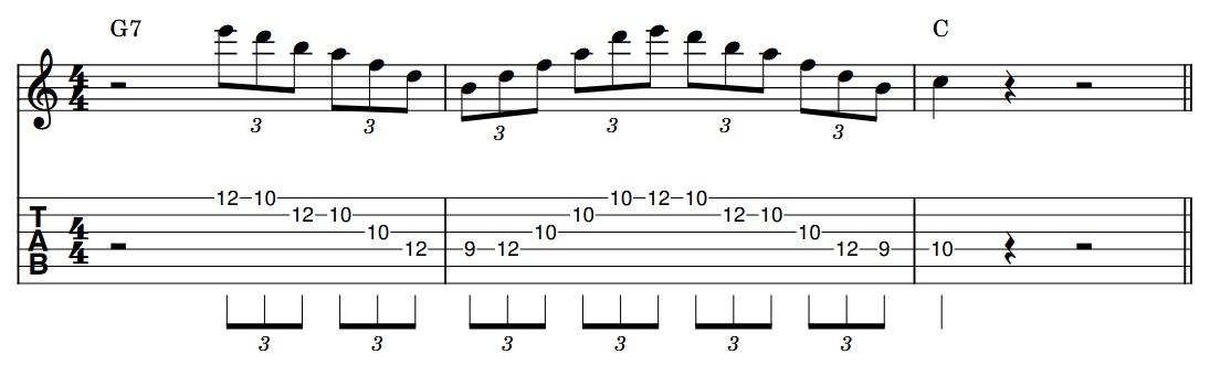

    That's an interesting one! I've just transcribed it myself, and here's what I came up with:
    We arrived at some different conclusions. πŸ˜„ The fingering throughout (strings/frets) is up for debate, but I can definitely say you got the last two notes of bar 2 wrong. They're clearly D-B, an enclosure around the final C note.

    Like you, when I slowed it down to the granular, I didn't really hear anything but clicks in those 2 middle notes. However, when I play it at regular tempo, my ears fill in the blanks with an E and back down to D again before the B. As far as the mechanics of the lick go with my fingers, that seems to keep the momentum of the phrase and is easier to play for me. As a musical idea, I like the symmetry and repetition of the two same descending phrase patterns, though one starts in the middle of the bar and the second is displaced one triplet note to the left of beat 3 in the next bar. Seems like something Django would do, getting mileage out of a simple arpeggio idea by altering its starting point. Just my 2 pennies.

    @Buco Thank you very much to you too, Buco! So this is how you play it:
    You guys helped me out of the corner.
