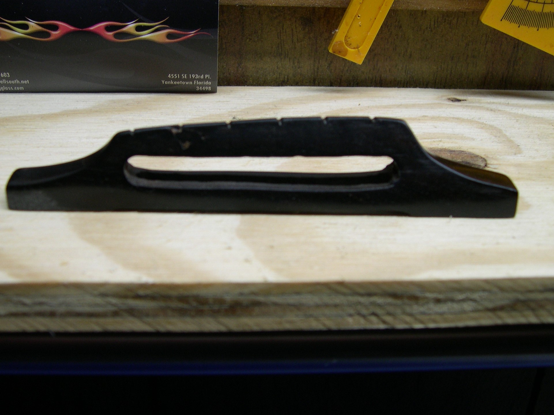

    I made many bridges for my Favino, like this one, and then another like it where I removed even more wood. I also made one with a foot in the center and all the surrounding wood removed, fitted a bone saddle, etc. Usually ebony but sometime rosewood. Most were not what I'd call successful, that's to say they did not improve the guitar in the way I was looking for. This one did, it aired out the natural dark sound of that guitar in a way I really liked. Things like a bridge might change a small aspect of the sound, but not the essential character of a guitar
