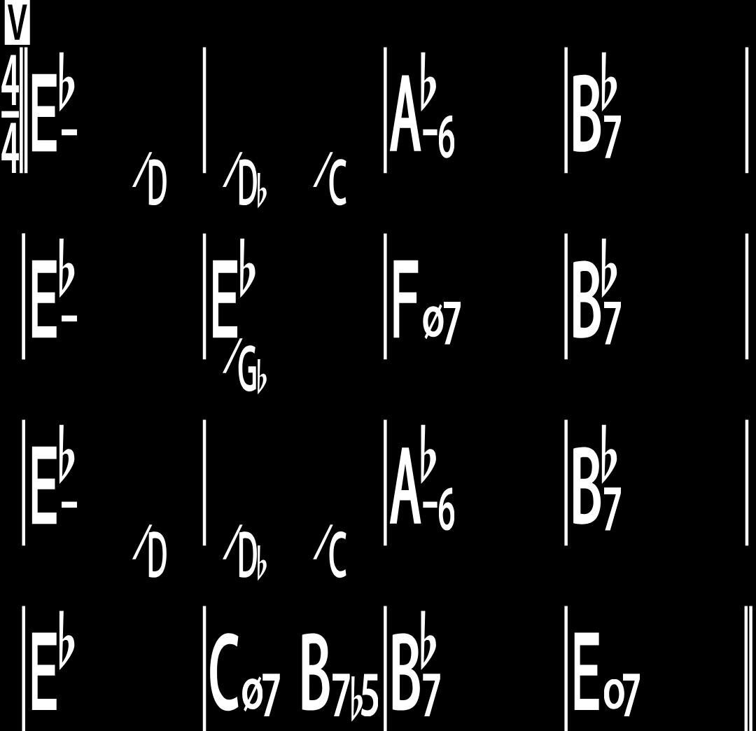

  • Posts: 6,171

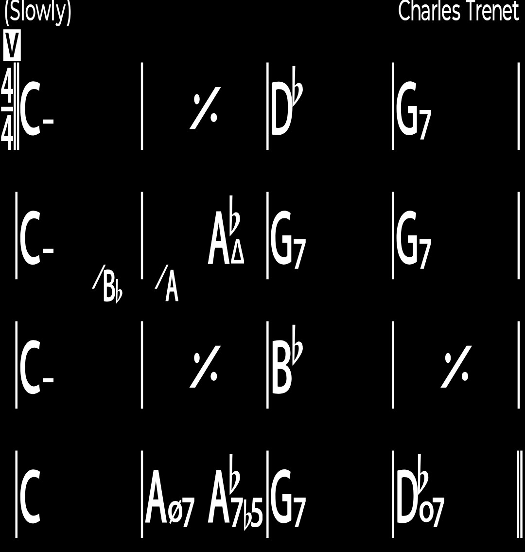

    I've used this below although I've done what Wim mentioned when I forgot these changes

  • edited August 8 Posts: 6,171
    I went over this live version and this is what I heard.
    I'll be doing it this way from now on. The Db after C- in the opening gives it a really nice lift
