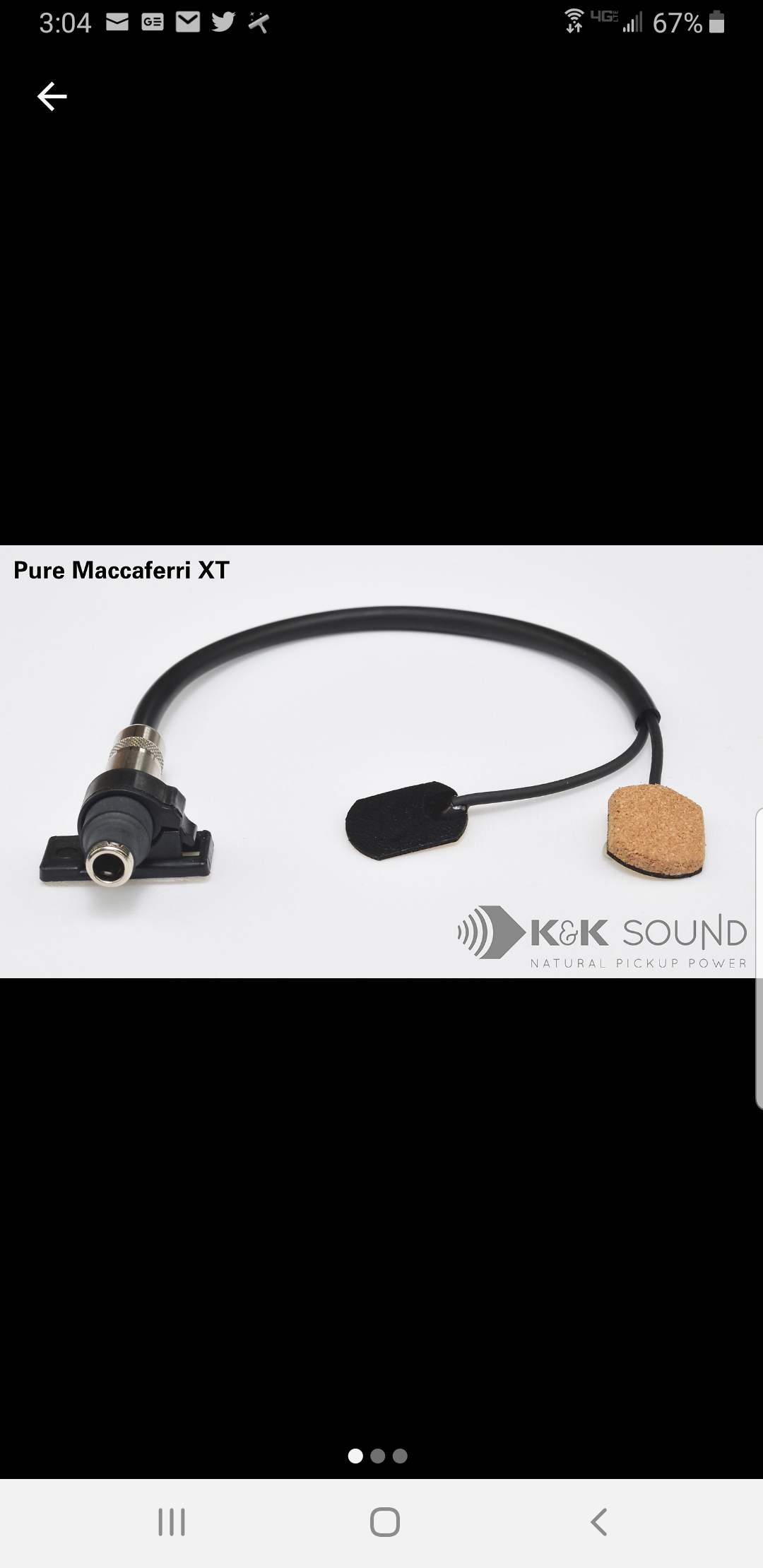

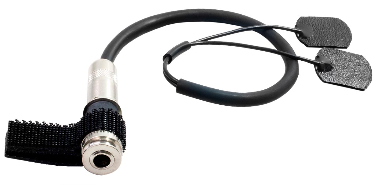

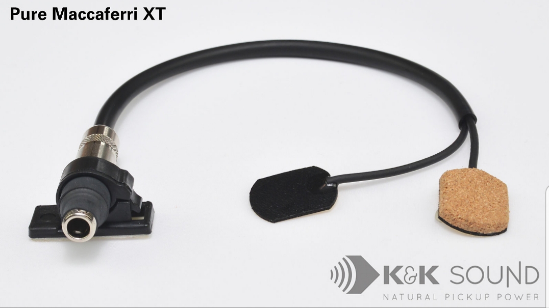

    So tried and I love the natural sound the K&K pickups strive to capture. I can get what I want using two models of external archtop pickups.
    But I have to make a bridge a with wider base. The wider feet or base of the bridge I have almost finished can accommodate all of the piezo.
    I am almost finished with a one piece ebony bridge. I made one purposely to use two K&K types of under-bridge pickups That is three under foot and one piezo is supposed to go on the guitar top.
    I can use volume, tone, effects and playing styles to get diverse sounds from these two.
    This is one K&K Archtop underfoot model I use in my gypsy. It is natural, mellow and rich and easy to install (entirely external).
    Th Pure Maccaferri, also an external, has more highs and mids. But still has a natural sound.
