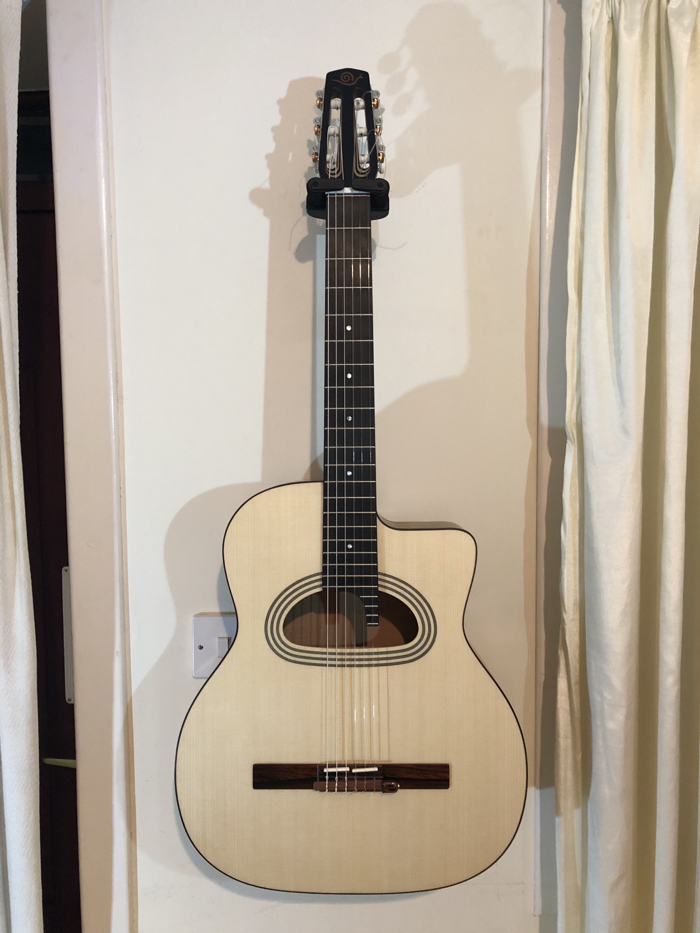

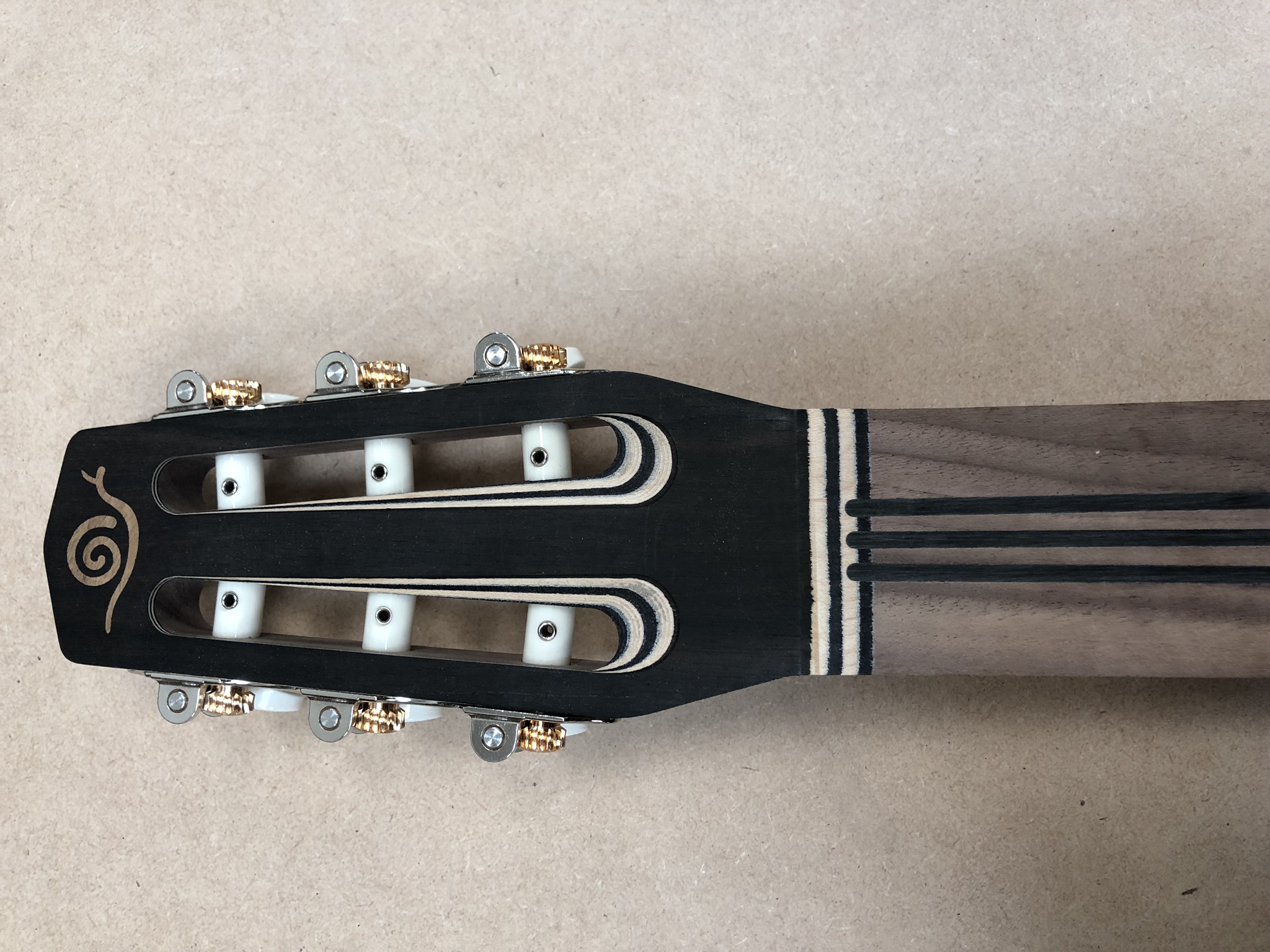

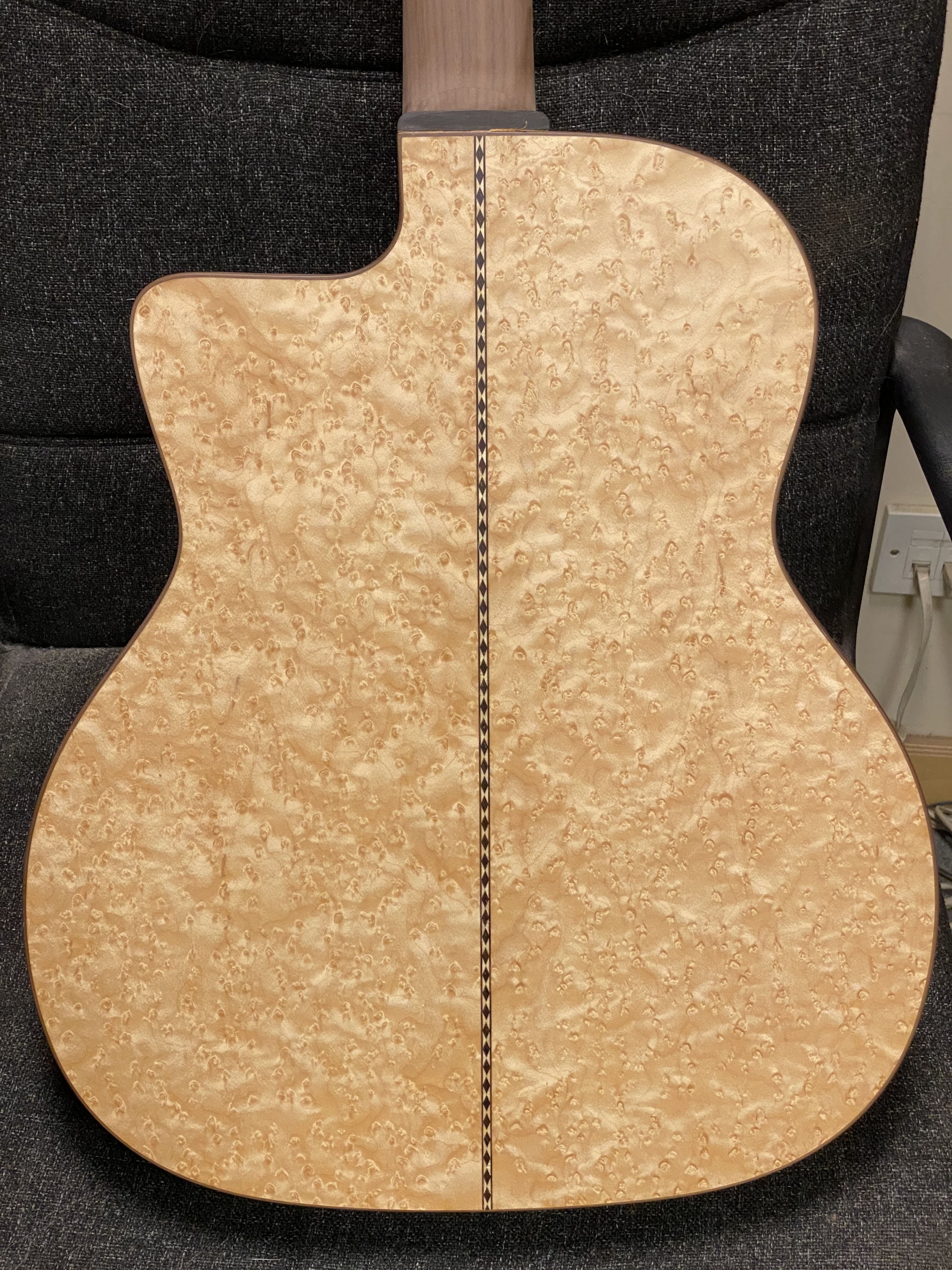

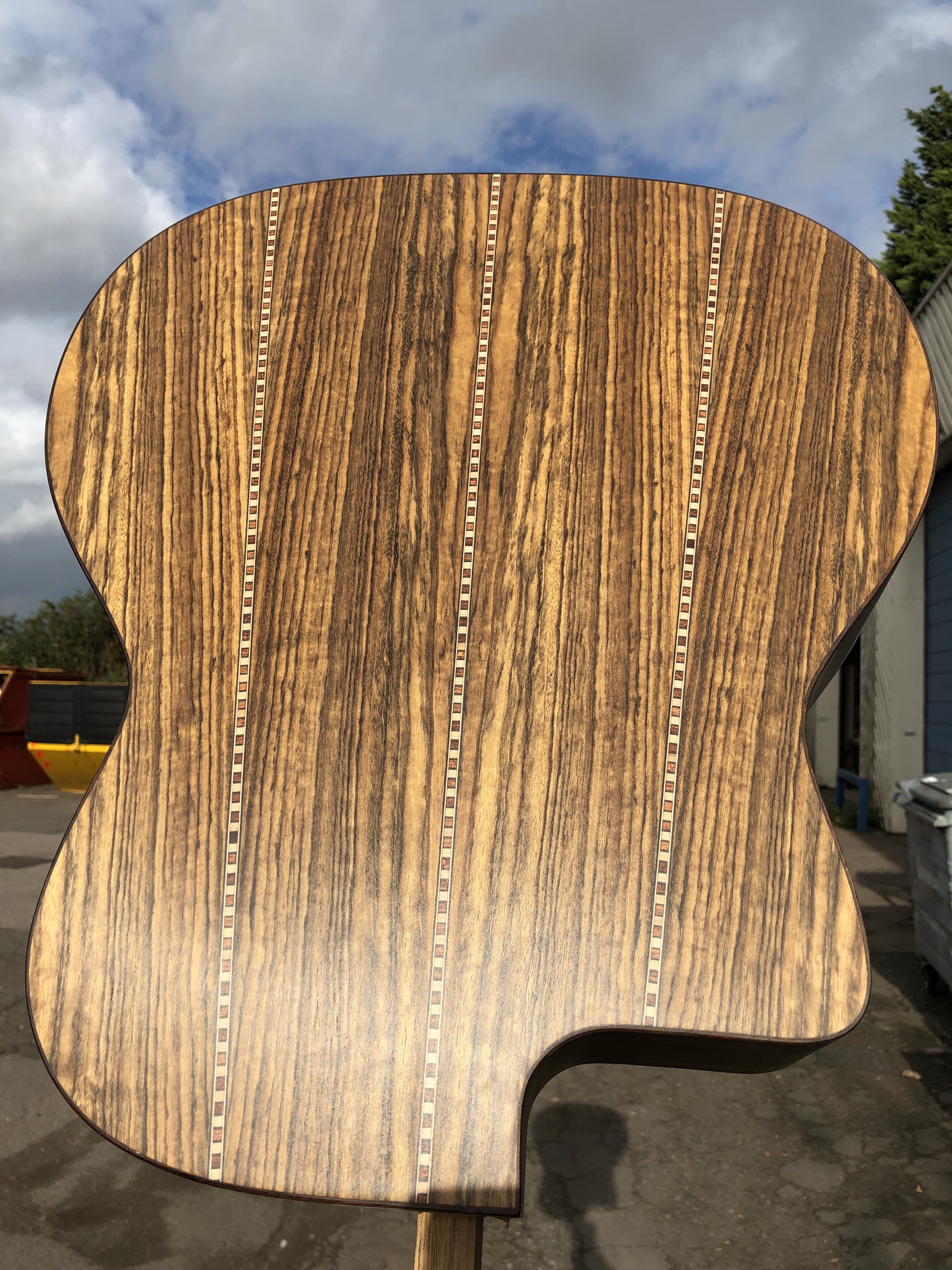

  • Posts: 20
    Sorry I went a bit quiet on this project but here ares some pics of the finished guitar. How does it sound? Well I need to spend a bit of time on the frets and I think the bridge could do with being about 0.75mm higher to cut out a bit of fret buzz on the bass strings but I think it will be pretty good once these issues have been addressed. I have one other Concert model in birdseye maple which I am making but I have been mainly working on a petite bouche which is nearly ready to lacquer and I'll post pics of this under a different topic.
