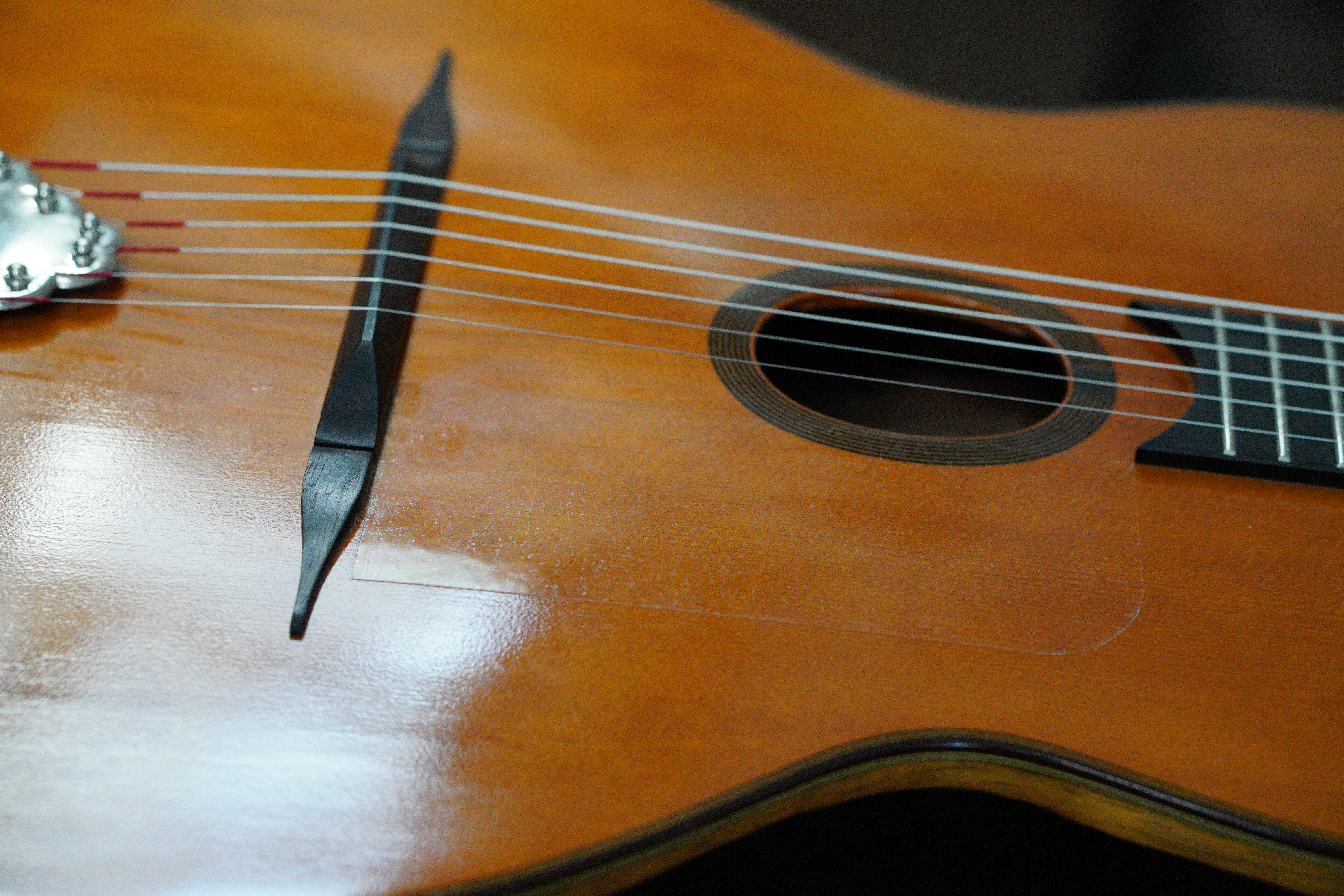

    Hey @V-dub, I agree that it doesn't look bad, but I also agree that it gets under your skin (mine does too).
    The guy with a store in L.A. gave me two things to help deal with it on my guitar:
    1. Clear, thin Mylar pickguard that can be removed without hurting the finish (and still shows off the guitar)
    2. Bottle of cream polish
    The pick guard is only seen if the light hits it just right, but protects from scratches (though I wish I had adjusted it's placement based on my picking). The cream polish helps add back a bit of finish that I wear off with picking, keeping my guitar looking as close to new as possible. Honestly, you'd be able to see the pick-wear much more easily if I didn't use the cream polish every time I swap strings.
    Below are some images I just took of my guitar, being my daily driver since July of last year. For reference, I had an Eastman for less than 1 year, and had very clear pick wear on it. You can't really see the pick wear except in the last photo. It's also hard to see the pickguard without light in the right direction.
