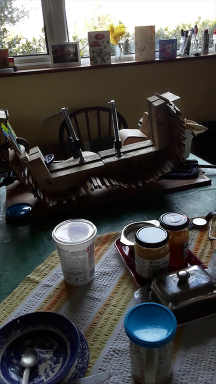

    This looks more complicated than it ended up being. I had the brainwave to do it on top of a hot radiator but it turned out that because that's an oil-filled radiator, it didn't work on its side! so we unplugged it (as the keen-eyed among you would have noticed!).
    So basically all it is is the 2 halves of the top on a flat surface with a beam clamped across 'em, with another couple of slabs of wood shoved under the 'lip' to push it up..
    Then there was lots of hot water and even a blow torch along the metal beam in the centre (in case you can't quite see it, that's a rusty old gate hinge with a bed headboard upright clamped on it!)
    I proudly managed to avoid scorching the wood with the torch but the rust from the rusty old gate hinge travelled, with all the hot water, into the fibres of the spruce.. :/ - but fortunately, it's 'inside up' with this method so you cannae see it now!
    This was the method detailed by Craig Bumgarner in this post (https://www.djangobooks.com/forum/discussion/6010/byo-the-pliage/p1)
    (We are seriously indebted to Craig for information we've gleaned from his posts - as well as to everyone else who has taken the time to offer answers to my numerous questions. Sincere thanks to all of you.)
    I thought it best to bend them next to each other like that so as to form a contiguous pliage line through them both that would be a straight line across the top when joined - I used a set square to position them and the cross-brace..
    I figured there must be a good reason most people don't glue them first (probably all the hot water [or steam in other methods] would compromise the glue joint), so we didn't.. After bending, I clamped a couple of beams on the bench angled like this / \ and we cut a similar angle on the sides of the 2 halves of the top - then we pushed them into the wedge shape between the two beams to clamp the glue joint (neat little trick I stole from someone or other on the internet)
