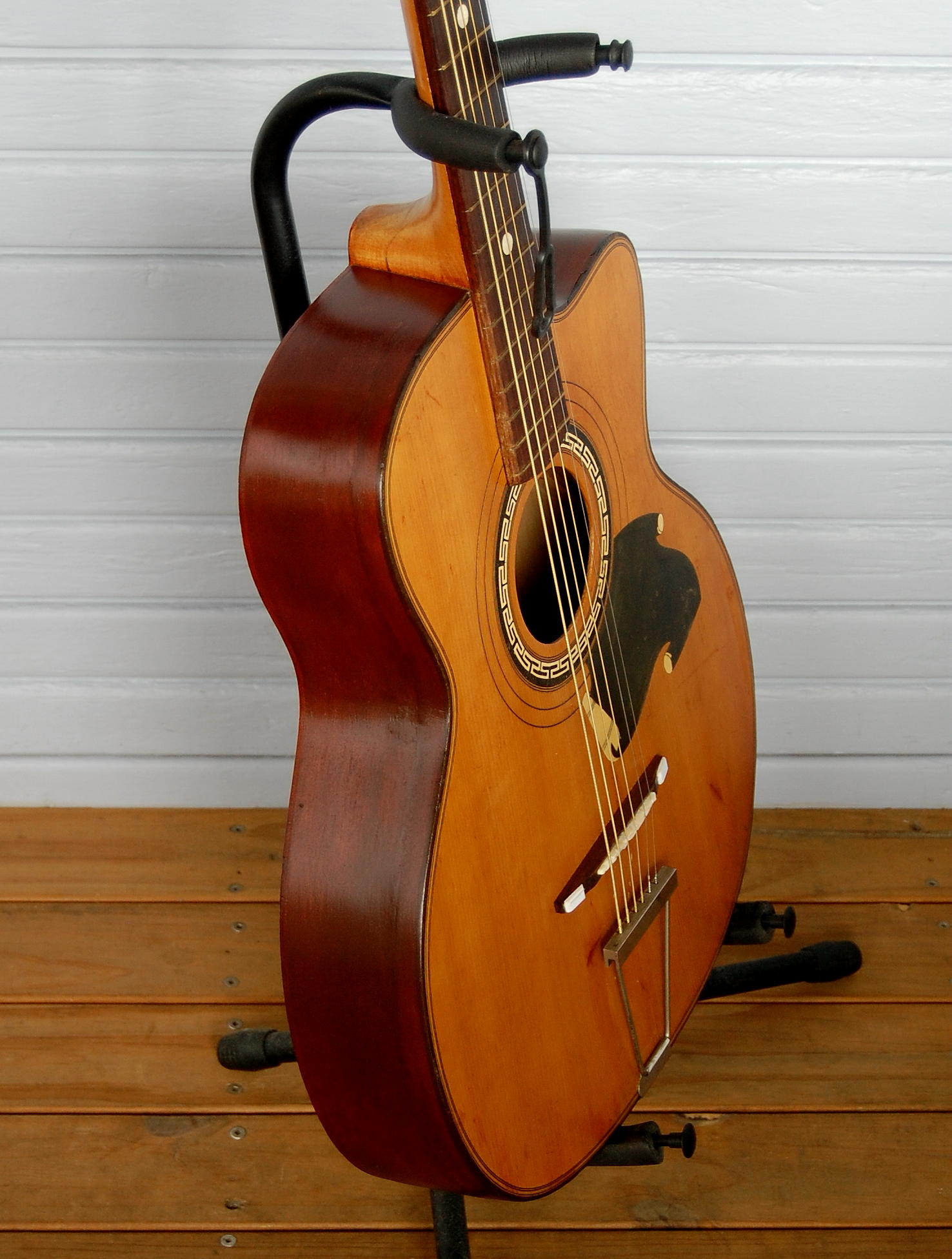

    So I finally got that Jose Sanchez by Leone Musikalia cleaned up but now I am investigating its identity problem. Identical to the Musikalia AndyW has previously posted and typical of their designs there seems no doubt this was made by the Leone factory in Catania who still make and sell under the Musikalia name today.
    Jose Sanchez on the other hand seems to not have ever existed. In the past I have seen many guitars with a Jose Sanchez label claiming to be made in Valencia, Spain for the Gaillard et Loiselet shop in Lyons. These appear to have usually been made for G&L by the regular suspects; typical of the more basic models from Di Mauro or Castelluccia or some Sicilian supplier like Carmelo Catania or in this case Musikalia.
    Why G&L chose to come up with a fake luthier and then claim him to be Spanish is a mystery we will probably never know, maybe just someone's idea of a marketing trick, possibly some in France thought Spanish made guitars had a better reputation? Ok, maybe, but then this one turned up with the same name - Jose Sanchez - but with the pretence 'Fabrique de Guitares' written in French with no claim to being Spanish. And all this on what is obviously an Italian guitar. I am researching as much as I can find about the Sanchez brand, but I suspect it will be another Sonora type mystery.
    Anyway, this one was all a bit tatty, had a split in the (upper) side a lot of scratches and chips and the nut and bridge were missing. The damages were fixed up and touched in such that the main body now looks a lot better, and I fitted a new nut and made a bridge from some old spare parts in the typical Italian style including the little white plastic decoration on the ends. Also the tuners were history, but the originals had a hole spacing of 33mm, not the more common 35mm, so that needed some filling and redrilling to fit modern replacements. The tailpiece is the original one. The neck is straight and the frets only needed a quick polish.
    Initially with a generic set of phosphor/bronze light gauge strings I will see what it can sound like and maybe try some Argies later to compare.
    First, the 'Before' photos:
    And how it looks now:
