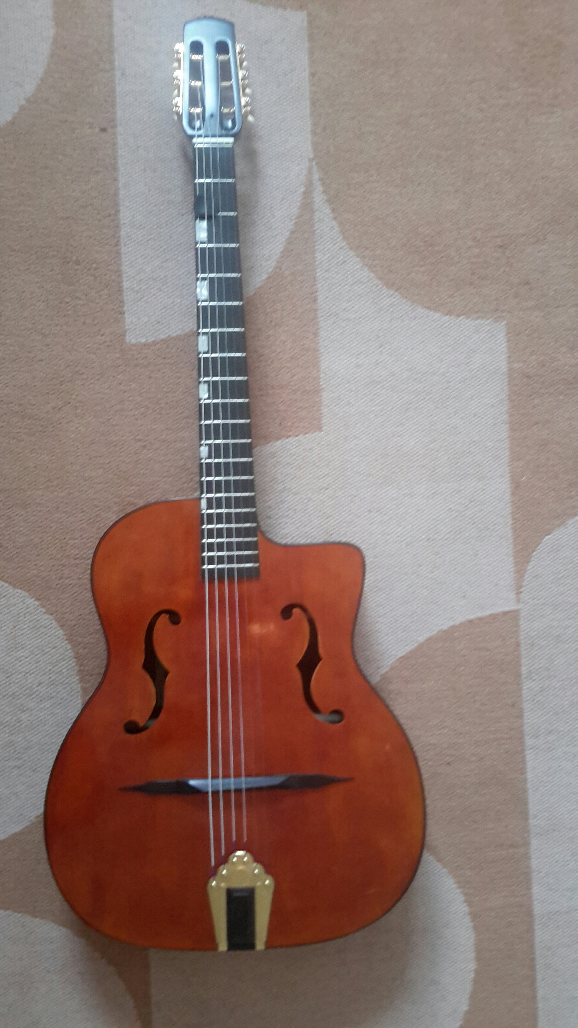

    After lying around at the customs in Frankfurt for a whole week, the tailpiece finally arrived. I think this was worth waiting:
    Old one:
    New one:
    Tomorrow I will change tailpieces with my old guitar after visiting my luthier, there has a bigger hole to be drilled into the Altamira tailpiece and I can't do that by myself.

    Hey Willie, does it sound better? Did it bolt on without issues? It looks pretty nice!
