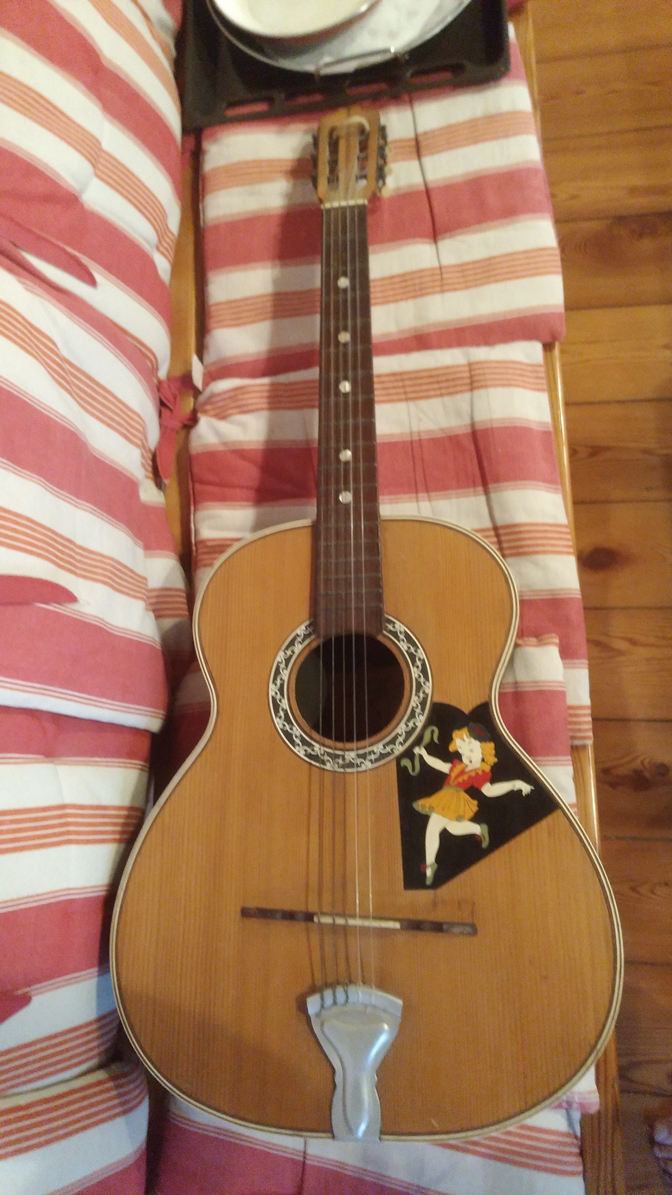

    That picture of a Caponnetto came from the internet somewhere, mine is the big black one with the soundhole rosette . I'm pretty sure your guitar originally would have been like the one pictured above, and the pickup & wiring were added years later.

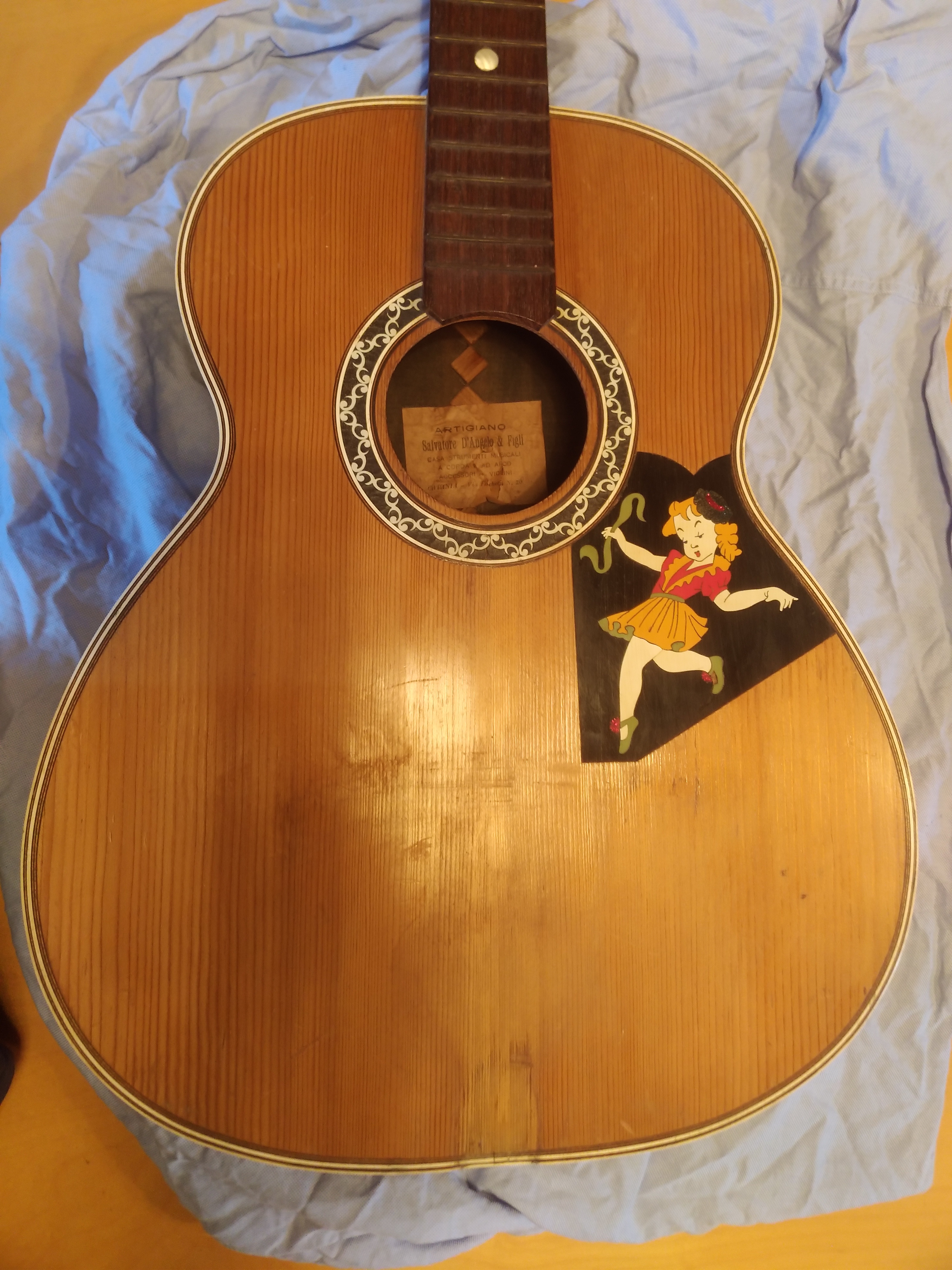

    Good afternoon everyone!
    Recenty I bought another guitar which has the exact tailpiece I needed for my Caponnetto.
    It's a Salvatore d'Angelo, one of the numerous luthiers based in Catania.
    The guitar has two major cracks in the back, just like the Caponnetto but it's its only problem. Tuners are alright, just dirty and a bit rusted;tailpiece is ok and also the bridge is good.
    The pickguard with the dancing girl needs to be reglued on a little spot ( the front leg it's lifting a bit). I was thinking of swap the tailpice, adding this one on the Caponnetto and buying a vintage one for this one.
    It's a quite large guitar, I wouldn't say a Jumbo but it's pretty big.

    Nice, and another good example of a colorful Catanian pickguard. That split in the back should not present a great problem, a clean break along the grain is an easy fix, otherwise it looks good. If you use that tailpiece on the Caponetto then you can get a cheap replacement by using one of the many Asian made copies of the resonator style, they are a similar shape. Look on ebay for ' resonator tailpiece '.

    Ciao Elianu, -<edit> funny, there's a picture of a Salvatore d'Angelo with the dancing child inlay on page 15 of this thread - is that the one you bought??

    Hello Andy, yes that is exactly the guitar I bought! I didn't know it appeared here before. I'm in contact with Ivan Rinaldi since a month or two, when I first go my Caponnetto: I've contacted him if he knew something about my model, and also if he had more tailpieces ( that photo you posted with the tailpieces he sent me it on whatsapp, i was thinking of getting the first one from left ).

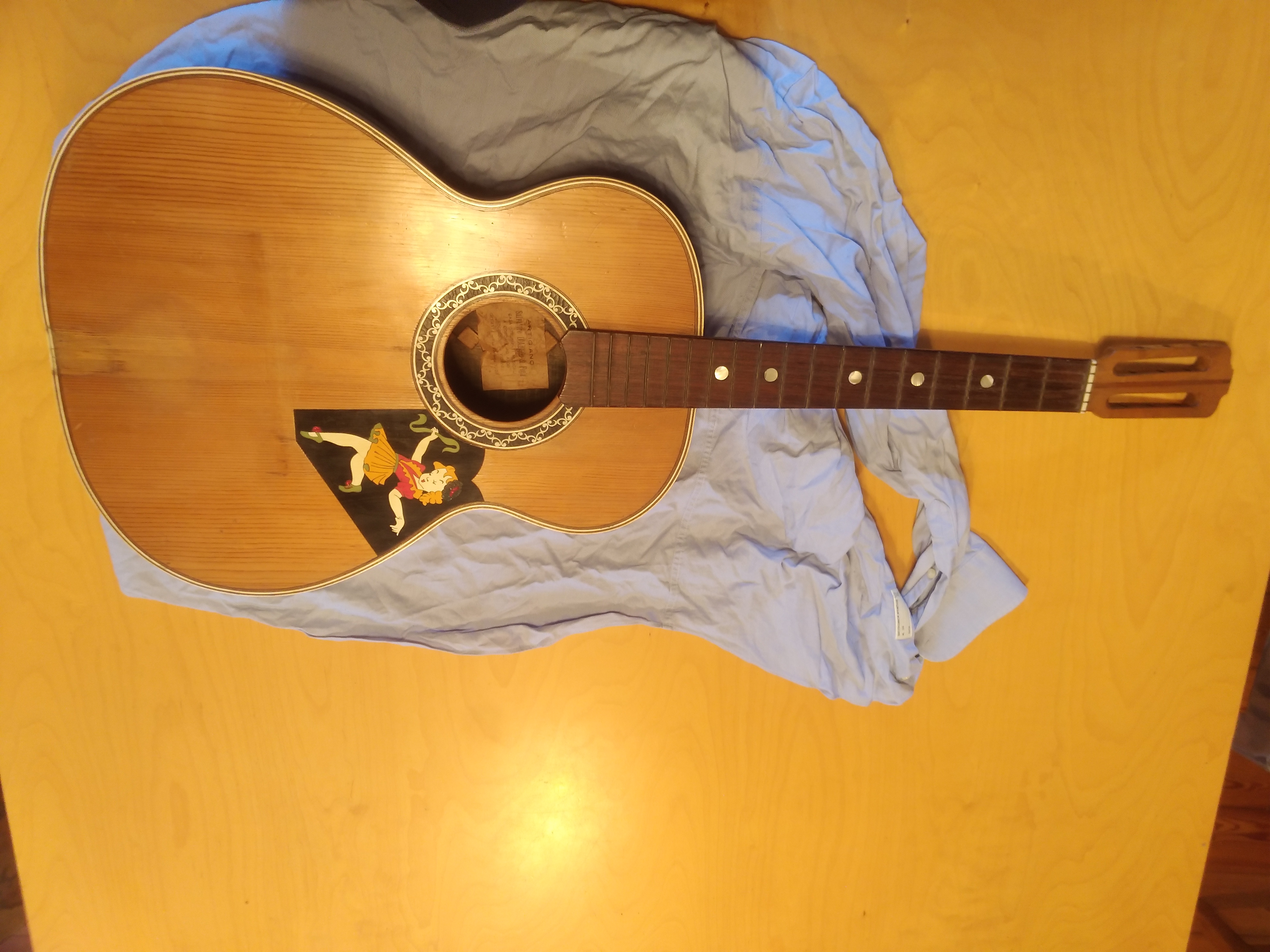

    Hi everbody, I was studying the Salvatore d'Angelo guitar before start working on it and I was wondering If it was better to remove all the back (with iron/steam), regluing all the pieces togheter or If it was better to reglue the cracks right on the guitar, so clamping and squeezing the guitar.
    I ask to you since I've seen pretty works here on the site and tought taht someone could advice me the best.

    Personally , I'd remove all the pieces of the back and reglue them together with extra strengthening 'cleats' .
    Might be a bit tricky as it looks to be curved / domed.
    You should check & measure the neck-to-body angle before you remove, as taking the back off might change this angle and you will want to reset it before you glue the back on.
    Other more experienced luthiers & repair folk might disagree - Good luck
    Posts: 1,036
    Agreed with AndyW. I have done similar repairs that way but care is needed. Hopefully it is held together with the original hide glue which is easier to separate than later chemical glues. If so, I use an electric clothes iron set on medium heat but place a towel over the area to be heated to prevent damage to the finish. If you move the iron around a given area slowly you should get enough heat through without burning the finish. Then probing gently with the corner of a paint scraper it should start to come off. That part is easy, all you need is patience and care.
    Next, to glue the pieces together with cleats at least every 2 inches (50mm) along the crack.
    Once that has set, give it at least 24 hours before handling.
    Now the tricky bit. Removing the back will have left the sides free to change shape and as AndyW said, the neck angle will be free to move up and down relative to the top. Of course it is important the back goes on keeping the exact same shape and how you manage this requires a bit of thought. You could try making a template by cutting some pieces of board or mdf to the exact profile BEFORE removing the back; at least two pieces for each side, then these can be glued to make a temporary mould with small 1 or 2 inch blocks to space them apart which can then be screwed to a workbench or base plate board and the used to hold the exact shape while regluing the back. There are probably other variations on this method but basically you are taking a mould off the complete guitar before removing the back.
    I have done it that way before but if it is all too tricky you can try using many clamps or even a ratchet tie-down strap, (the type you use to hold things down in the back of a pickup or trailer) with various wedges and blocks as required to keep the shape but this does need a slow curing glue as it will take a long time of fiddling until you have adjusted all of the clamps to match the profile to the back.
    Well writing all of that turned out a bit longer than I expected but if it makes it sound fiddly, well yes it is.
    Good luck.
