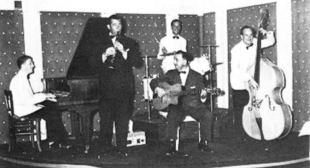

    Here's Django in 1949 with a different screw-on pickup, you can see the small amp next to Django which is probably similar if not the same one he used in 1947.

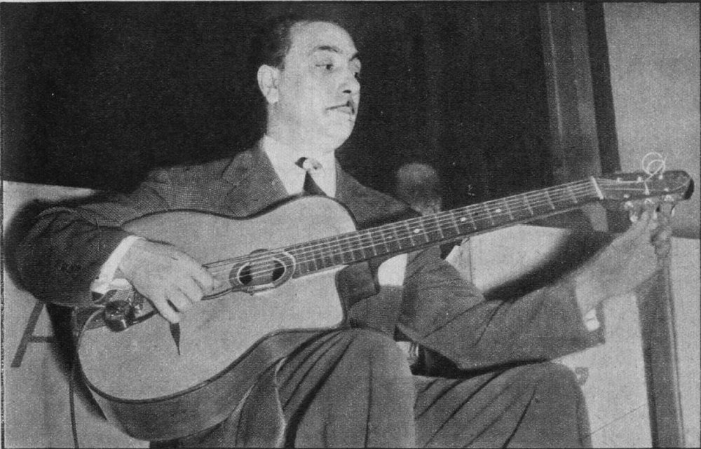

    It's a DeArmond "Monkey on a stick" pickup. The ones made after 1945 had two slots in the pickup cover, so Django has one of these earlier ones. There's a comparison video of different pickups here and you can instantly compare the cleaner sound of the Stimer with the more distorted sound of the DeArmond. https://www.youtube.com/watch?v=b__7Ty9JNh4
    I've tried to find the amp on google images but haven't been able to. There are similar models from RCA, Telefunken, Knight, and more. The 1949 one seems to have a tube cage on the top part. In 1944 he was spotted using using another one, similar with the same small rectangular form factor but with vents instead of a tube cage.
    I don't think they had internal speakers, they seem to be PA or microphone amps since the controls are on the front, and Django is probably connected to an external PA system, at these concerts anyway.
