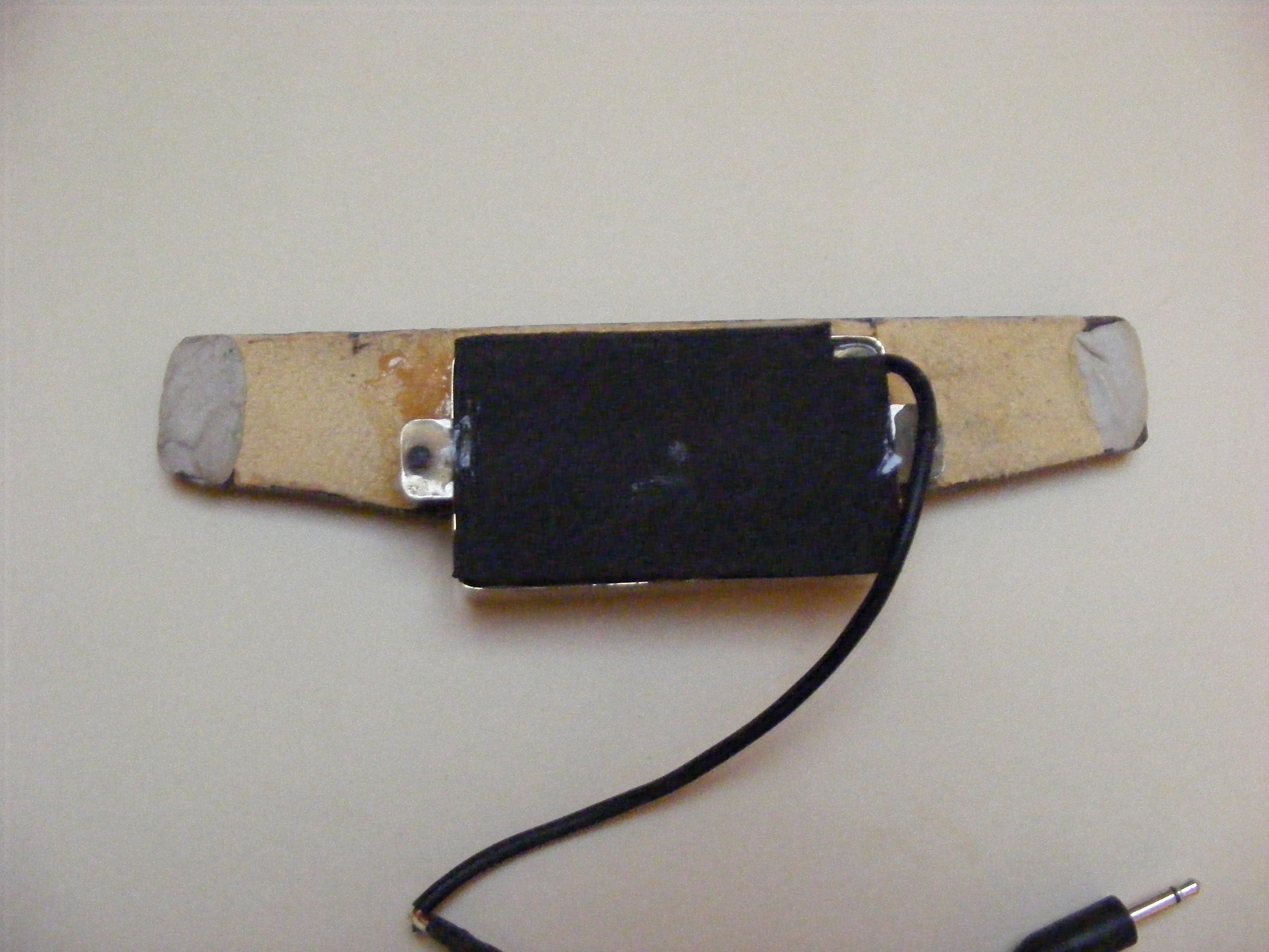

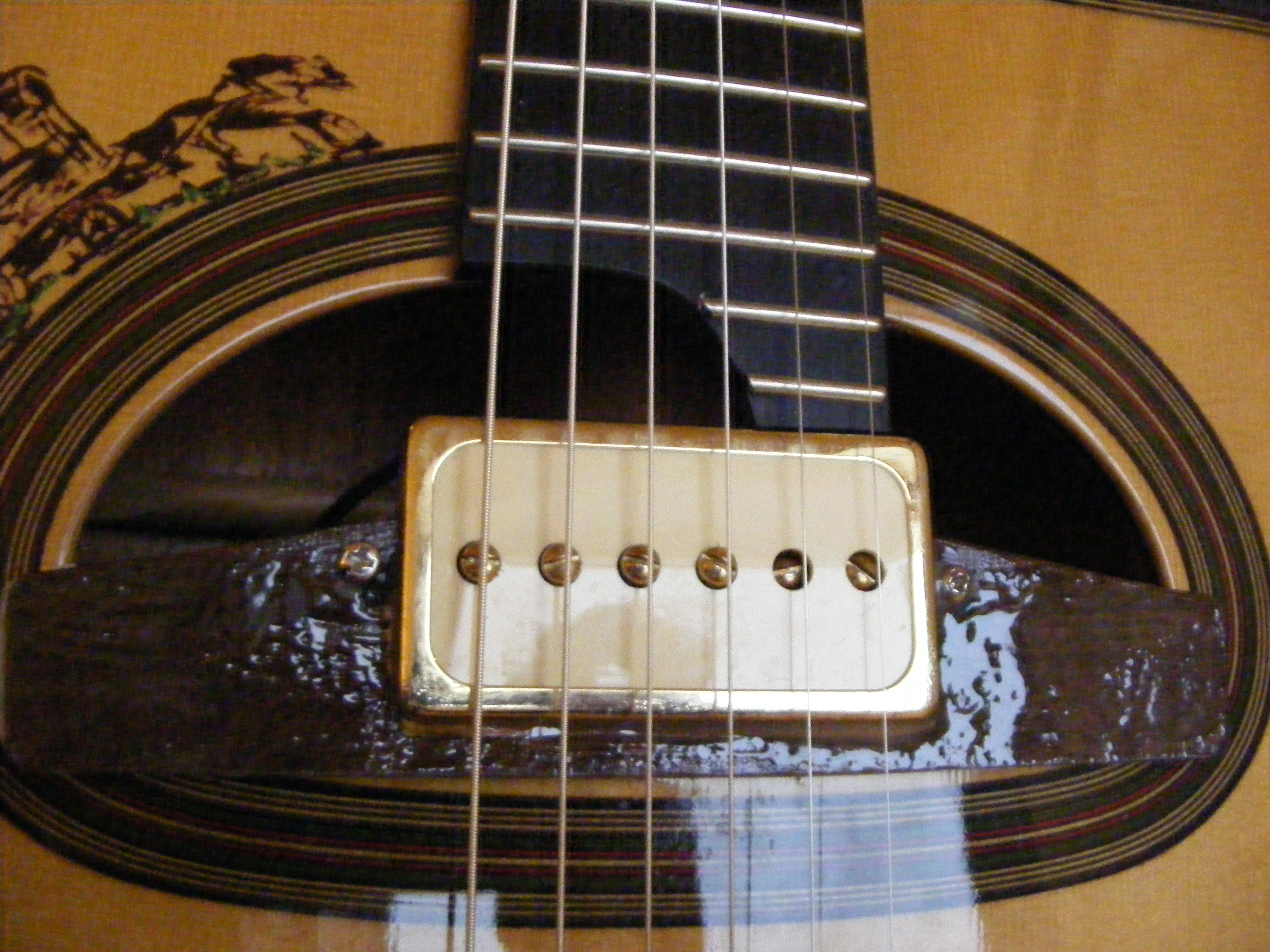

    @crookedpinky@crookedpinky I'd love to see the picture of your solution for a humbucker mounted on a D-hole.
    Posts: 939
    I got it wrong it's a humbucker sized P90. I'll post a picture tomorrow.
    always learning
    Posts: 939
    Here are some pics of my pickup hack. The frame is made from a piece of bog oak, the wiring is mounted internally to an end jack socket - you can see the internal socket the pickup plugs into in one of the pics.
    BucoBillDaCostaWilliams
    always learning
  • Posts: 5,755
    This is a great solution. I always figured something like this can be done. Still surprised there's no commercial solution along the same lines. Something universal, like a phone car brackets only for pickups that can go in D-hole guitars. Thanks for pics.
    Posts: 1,731
    I've seen Angelo play a guitar with a roulotte decal like that on your guitar. What's the story with yours? Is that painted on or some sort of sticker?
    Posts: 939
    To be honest It's a smaller copy of one from Angelos guitar. I did a bit of photoshopping on a jpg and then printed it on decal paper and put it on the guitar. Simple but effective.

  • guitarmikeguitarmike Montreal, Quebec✭✭ Old French Gypsy Guitar
    Posts: 118
    My set up.
    A steel saw blade ( grinded teeth )
    And everything hold with blue potty.
    To adjust the height ?...........just bend to blade according to the desired height.
    DoubleWhiskyBuco
  • Posts: 5,755
    @guitarmike And you solved the b string imbalance too! I was thinking just the other day when this came up again as it does every so often, along the lines "it shouldn't be that difficult to make that spot a little less magnetic". The solution? Give it a few wraps of electric tape. Genius haha
