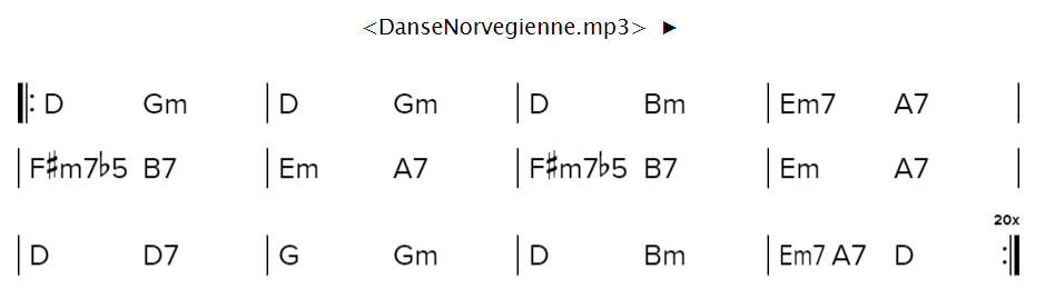

    • I really like the fact that you can use the full power of a desktop computer to make the cards (with MP3s, screenshots, PDFs), and then just sync them to the phone for review on the go. Stuff like:
    Question: Danse Norvegienne chords ?
    Answer:

  • AzazzellAzazzell CanadaNew
    edited June 2023 Posts: 201
    Anki just stores text, mp3s and images, so you can make up your own cards whichever way you like. For ex, you could break it down something like:
    Card 1: Danse Norvegienne Bars 1 and 2
    14, twice
    Card 2: Danse Norvegienne Bars 3-4
    1625
    Card 3: Danse Norvegienne Bars 5-6 and 7-8
    251 in Em going to 5 of root, twice
    Posts: 1,647
    Where did the F#m7b5 B7 Em A7 thing come from?
    To me it sounds more like Adim7 % A7 %
