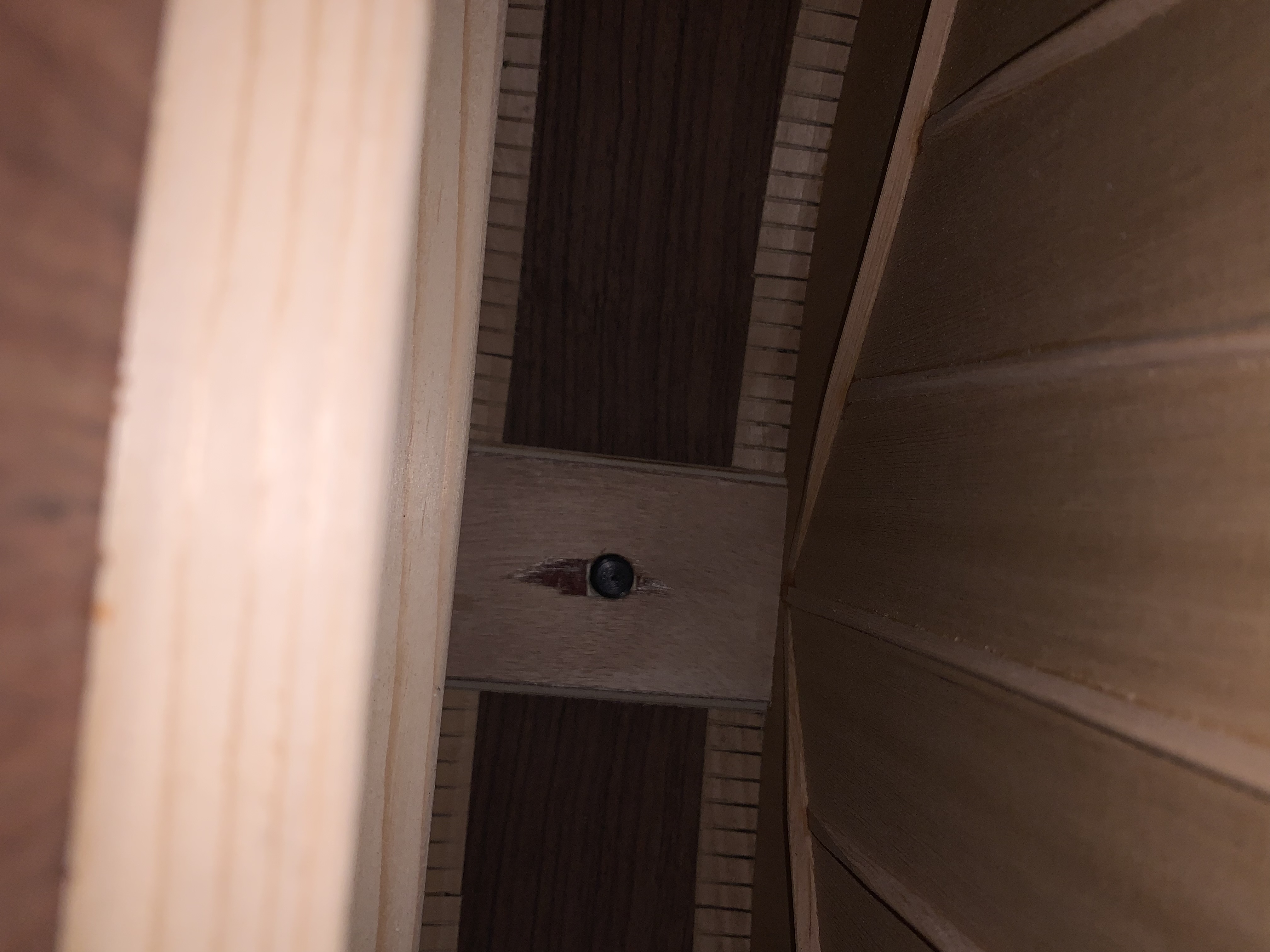

I am trying to install a Baggs pickup system into a Dupont MCC-100. The new endpin jack will replace the factory-installed strap button in the tailblock.
The current strap button doesn’t seem to be affixed with a screw, so maybe it’s a threaded type (threads bite into the drilled tailblock).
Has anyone removed this type of strap button? Was it glued in?

    Update, I shined a very bright headlamp into to the (exterior) strap button’s hole and there’s a tiny phillips-head screw. I missed it before because it’s very small and slightly stripped/furry. And thanks DragonPL, I will be using the dowel method to get the new jack in.

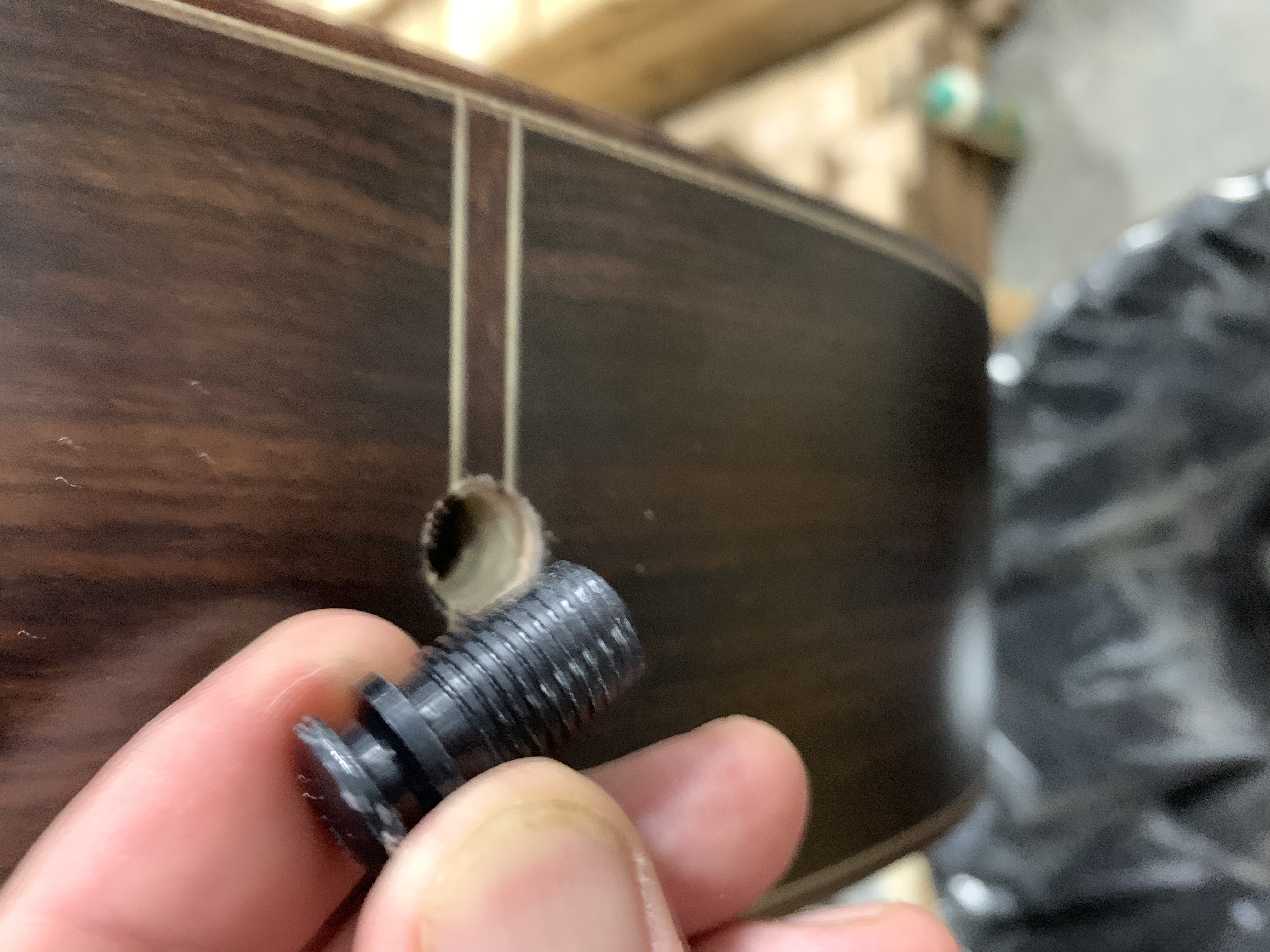

    Update 2: Since the (obviously) phillips head was stripped, I used a hand screw extractor, and was able to unscrew the unit. No glue used. I could have used nylon jawed pliers. Ref pic if anybody someday cares:
