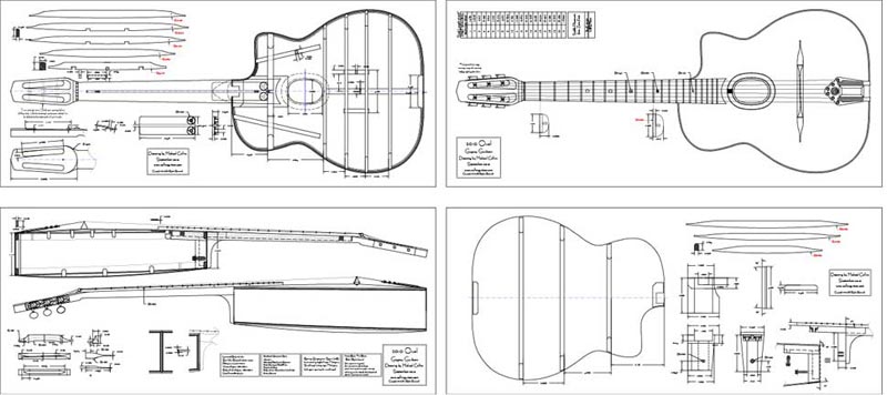

    It would be interesting to know if there are two braces underneath the top near the bridge..! It would certainly help preventing the top from sinking.

    @MichaelHorowitz Do you know if Busato guitars always have 2 braces underneath the top near the bridge?
    I think the size, shape, number and the exact place of the braces play an important role in whether a top might cave in/sink or not. The vintage gypsy guitars i have that still have a perfect bombé top have big pointy triangle shaped braces, I think they have just 3 braces in total but I should recheck this... .
    Posts: 6,236
    @PJD All Gypsy guitars do

    @MichaelHorowitz That's interesting, so far I have only seen vintage gyspy guitars with a total of 3 braces underneath the top.. The 2 Carmelo Catania's I own have a total of 4 braces (2 underneath the fretboard part of the top).
  • PJDPJD New
    Posts: 68
    Not all vintage gypsy guitars have this Selmer bracing. There are a lot with just 3 or braces underneath the top, with just one underneath the bridge. I read that (a lot of) vintage Castelluccia's have a total of 3 braces underneath the top, so also just one brace underneath the bridge. Some Couesnon's only have 2 braces. I saw a post on this forum with a photo of @AndyW 's Gérôme with 4 braces which he changed. It would be interesting to know if and or how this operation has changed the sound of his guitar. My Joseph Di Mauro also has just 3 braces underneath the top (and one brace on the back). My Vincenzo Miroglio same, another mystery gypsy guitar i own also has just 3 braces underneath the top.
    edited February 2024 Posts: 6,236
    @PJD sorry, I should have clarified my statement by saying that all Selmer style guitars have that sort of bracing. As you mentioned, there are many other variations by lesser known makers,
