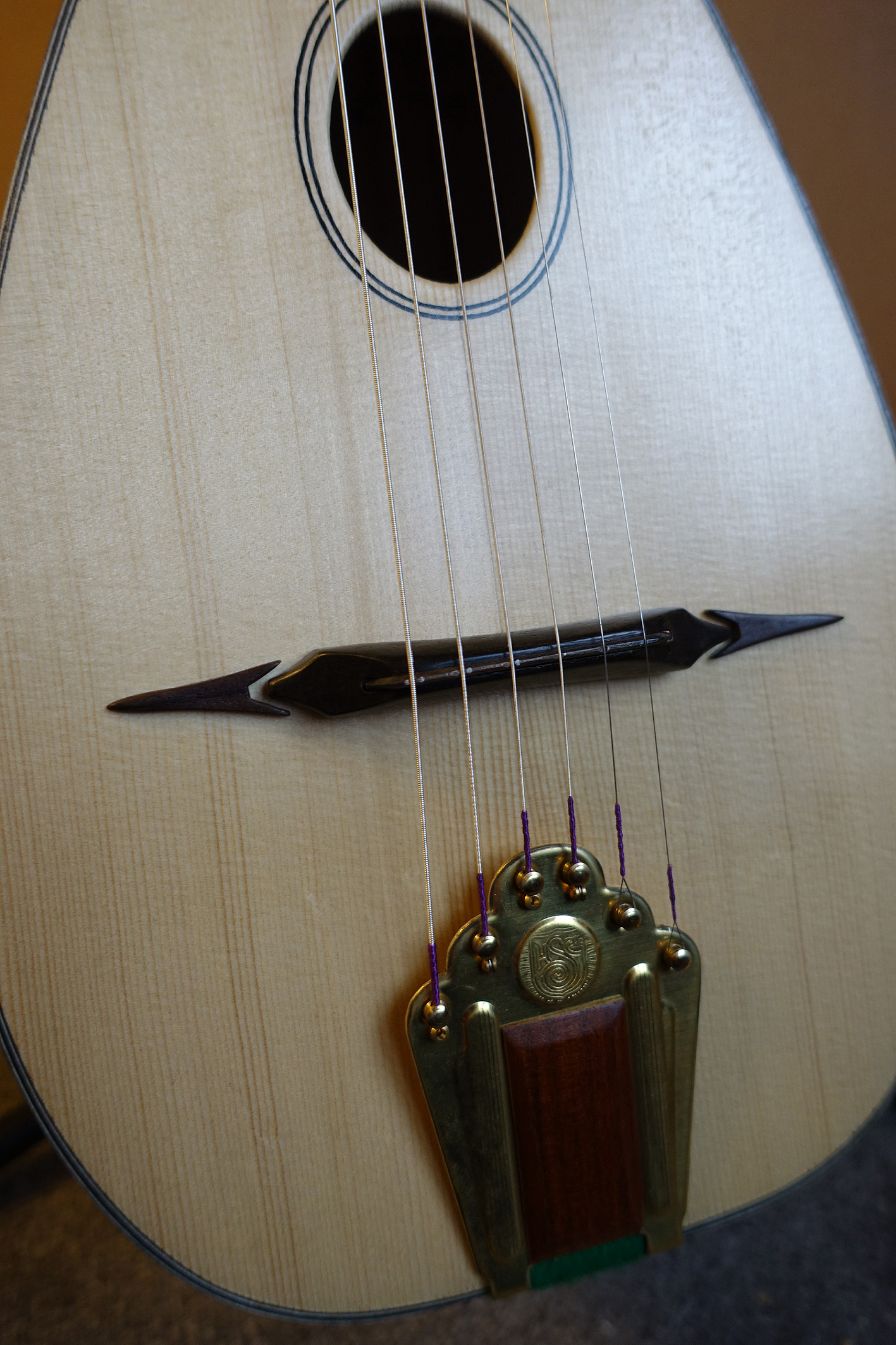

    Thanks for the suggestions!!! I've been out in the hills today so not managed to play it/tweak it/photograph it etc yet. Hopefully tomorrow. You're right Jason, I need to be tuning it up a fifth I reckon. The strings are coming off and I'm going to file the frets down a bit. They're very high at the mo. The other issue is that the tuning machines are horrible!! - the strings don't go through holes but just rest in slots - is that common on electric guitars? I will be looking for some replacements (or might poach my Peavey Predator electric machine heads).
    Posts: 184
    Is there a hole in the middle? On that style of electric tuner you poke the string down in the hole and then wrap it using the slots, if that makes sense. That's how Fender tuners usually are.
    Jangle_Jamie
    edited November 2024 Posts: 455
    Yes, a hole in the middle of the tuners. Ooops, I didn't know you poke the string in there and get winding! The prob was more to do with the lack of any angle of the headstock, so the low E was barely resting on the nut. Solved by drilling a hole through the post and re-routing the string. These photos were before I did a couple of mods - took some height off the frets and gave a nice polish. I've tuned it up 3 tones now and it's a lot easier to get it sounding in tune across the whole range. It will probably go to 4 up but I'm just letting everything settle down. I'll then lower the action a little (I've made an ebony bridge insert which sits on top of the Bigtone in a slot in the bridge. Tone is quite pleasing - like a soft banjo. The recording is the Saz for the chords and meIody. I present my.. Sazz Manouche:

    Posts: 184
    Nice man! I love that bridge design. Very cool project I've had fun following along
