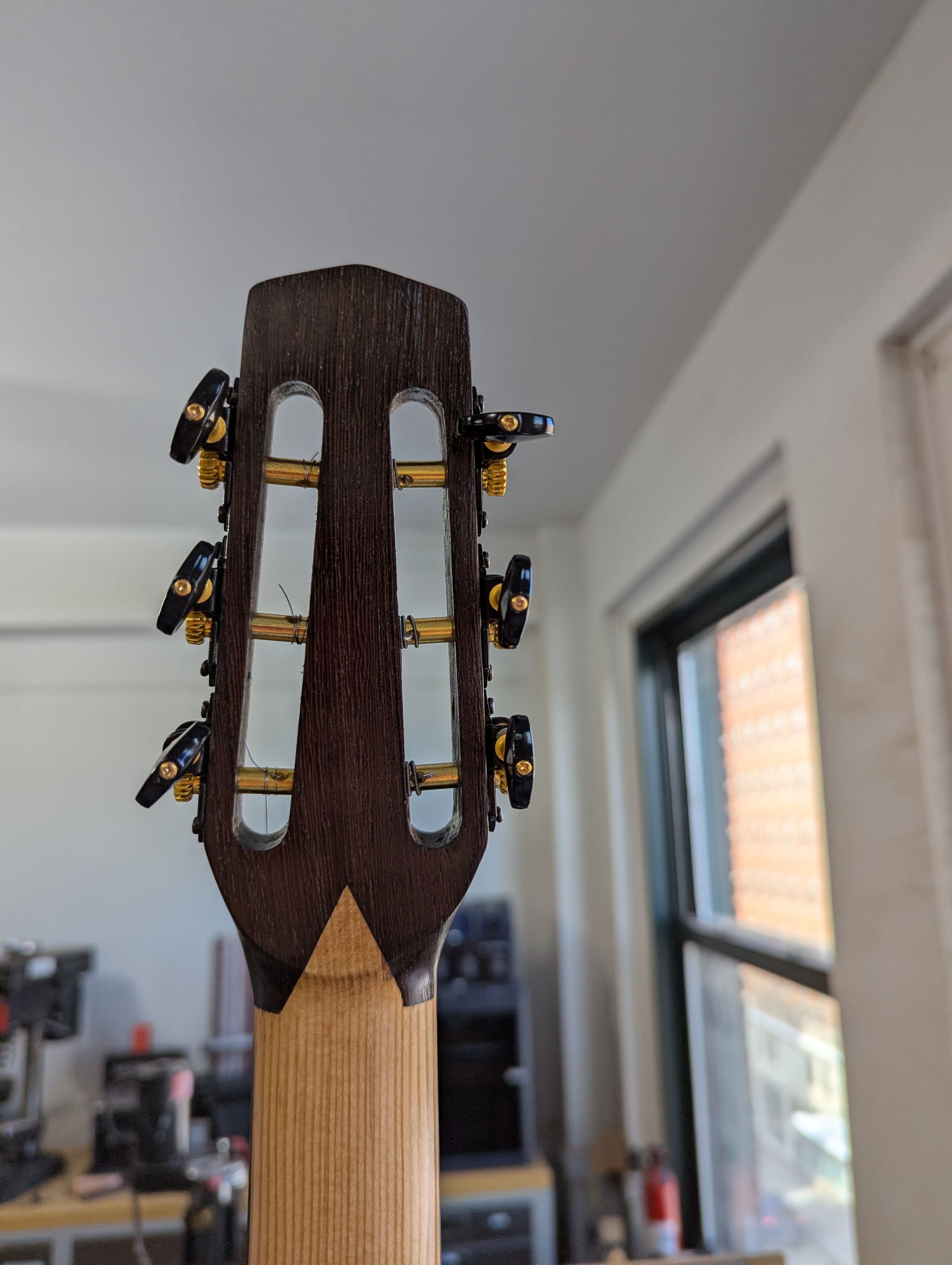

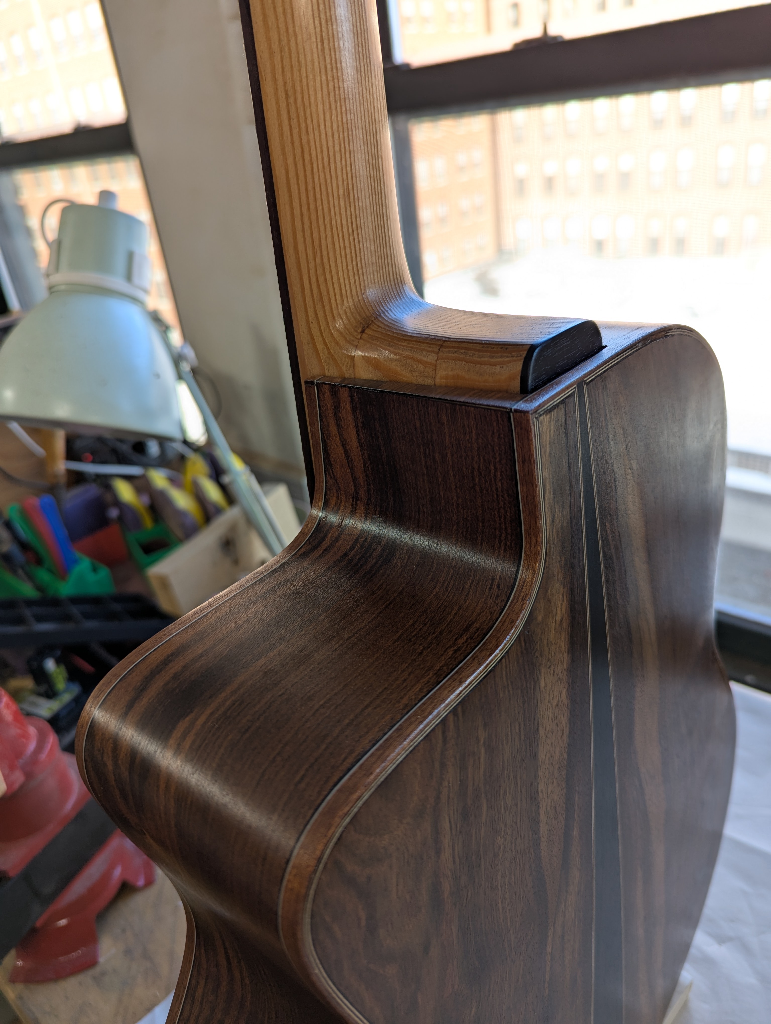

    This is the last of my batch of 7 from last January (well there is a retopped classical).
    I just did a quick string up to get it set up and took some pictures. Better pictures later.
    This is a multiscale, 670mm on the Low E and 660 on the high E. Top is Sitka and the back and sides are Chechen. The neck shaft is Douglas Fir and the headstock is Wenge with a Rosewood headplate. Fingerboard and bridge are Wenge also.
    I gotta work on these tailpiece ties. I made them out of dyneema because it's crazy strong and supposedly doesn't stretch but the knots stretch...oh well. Back to the drawing board.
    Like all of these guitars from last year, this one has some cosmetic issues, mostly because of one kind of hard to explain mistake I made on all of them. Oh well, they are all cool guitars and I like them. There's no hiding it.

    Great details on the headstock joint and that back strip!!

    Posts: 1,734
    Agreed. Love the aesthetic of the wood grain aligning with the black back wedge and also how the headstock join mimics the arrow of that back wedge. Also, the choice of black tuning buttons is cool.
