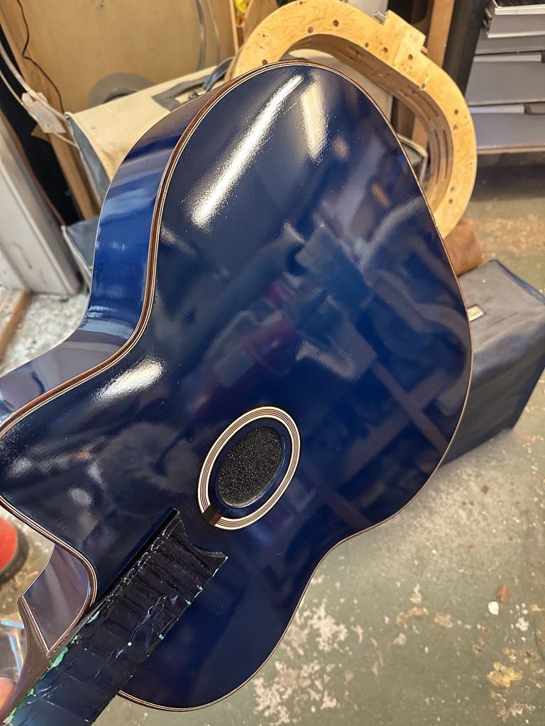

    Speaking of Blue Guitars....Ari at AJL is making this Gypsy Fire for me based on the color of a Gibson ES-137. I should have it in the next couple of weeks.
