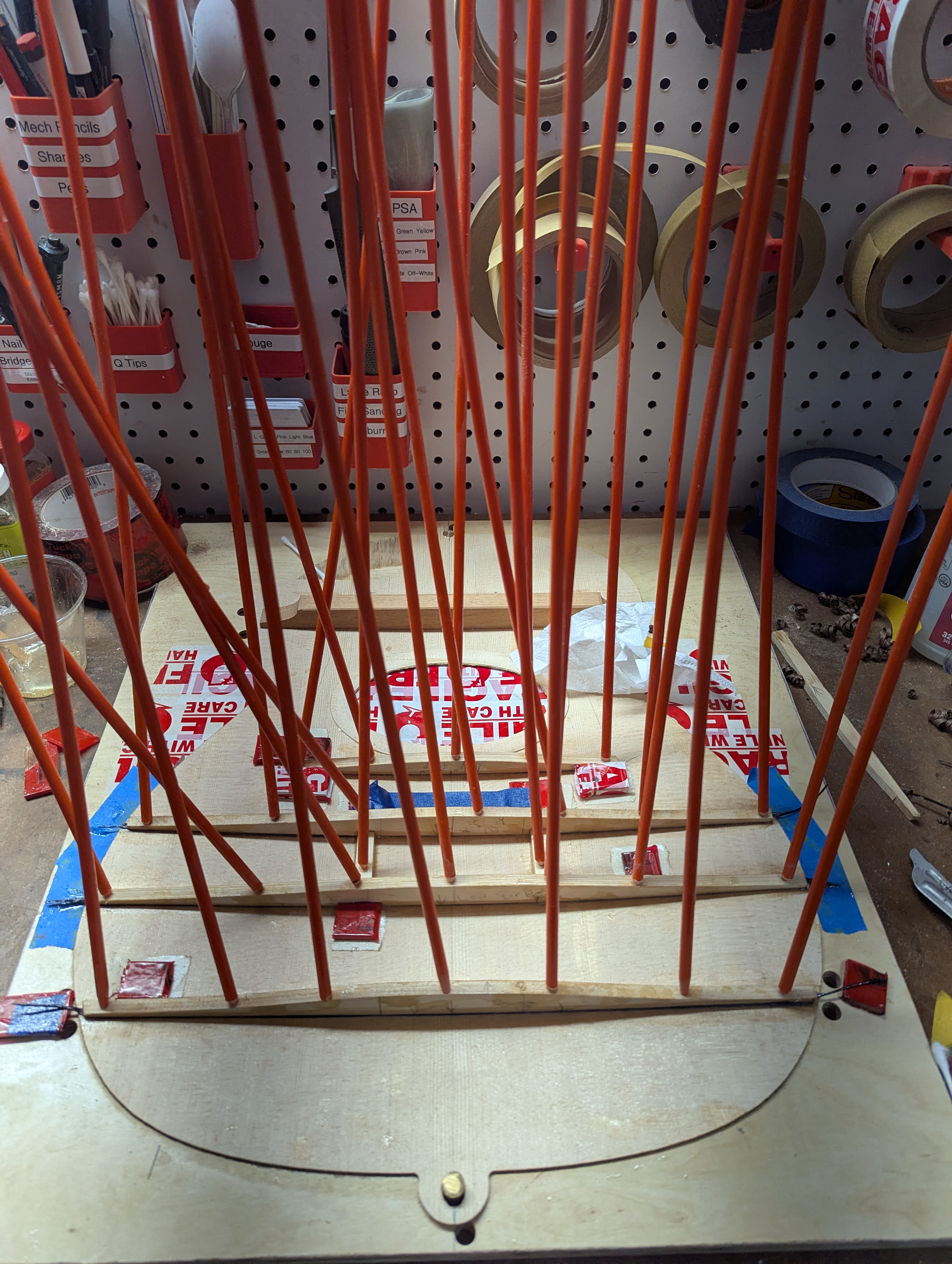

    You can't really see it but I put all these braces on with carbon fiber underneath. I'll preliminarily shape the braces and then glue the sides on...after that I can check my deflection on the top and take the braces slightly below where I want them, then they will get carbon fiber on top which will make a little I beam. The idea being a brace that is less mass than the equivalent Sitka but the same stiffness.
    I've experimented with this on several of my last guitars and they all sounded good/great but I have a really good idea what I'm shooting for this time and how I'm going to measure it. We will see.
    I have one guitar in this batch that will be wood only braces so I can compare. I don't think there will be a huge sound difference but the CF should help make a more durable guitar with less chance of the top sagging over time.

    Does this image signal the end of the vacuum experiment?
    Posts: 662
    Not sure tbh. It's not the panacea I was hoping for. Mostly because to do something with epoxy would mean I'd have to run the pump for 6 or more hours. I have limited electricity in my shop so it means I can't do other stuff that draws a lot and I don't want to leave it running overnight.
    So far it's good for doing sides.
    I also just bought new go bars, which are 1/4" instead of 5/16" and they are like half the pressure of my old ones. The old ones were too strong and sometimes would crush wood fibers.
    But I like the vacuum pump idea. I will def use it on classical guitars with lattice tops and I'm using it on my sides.
