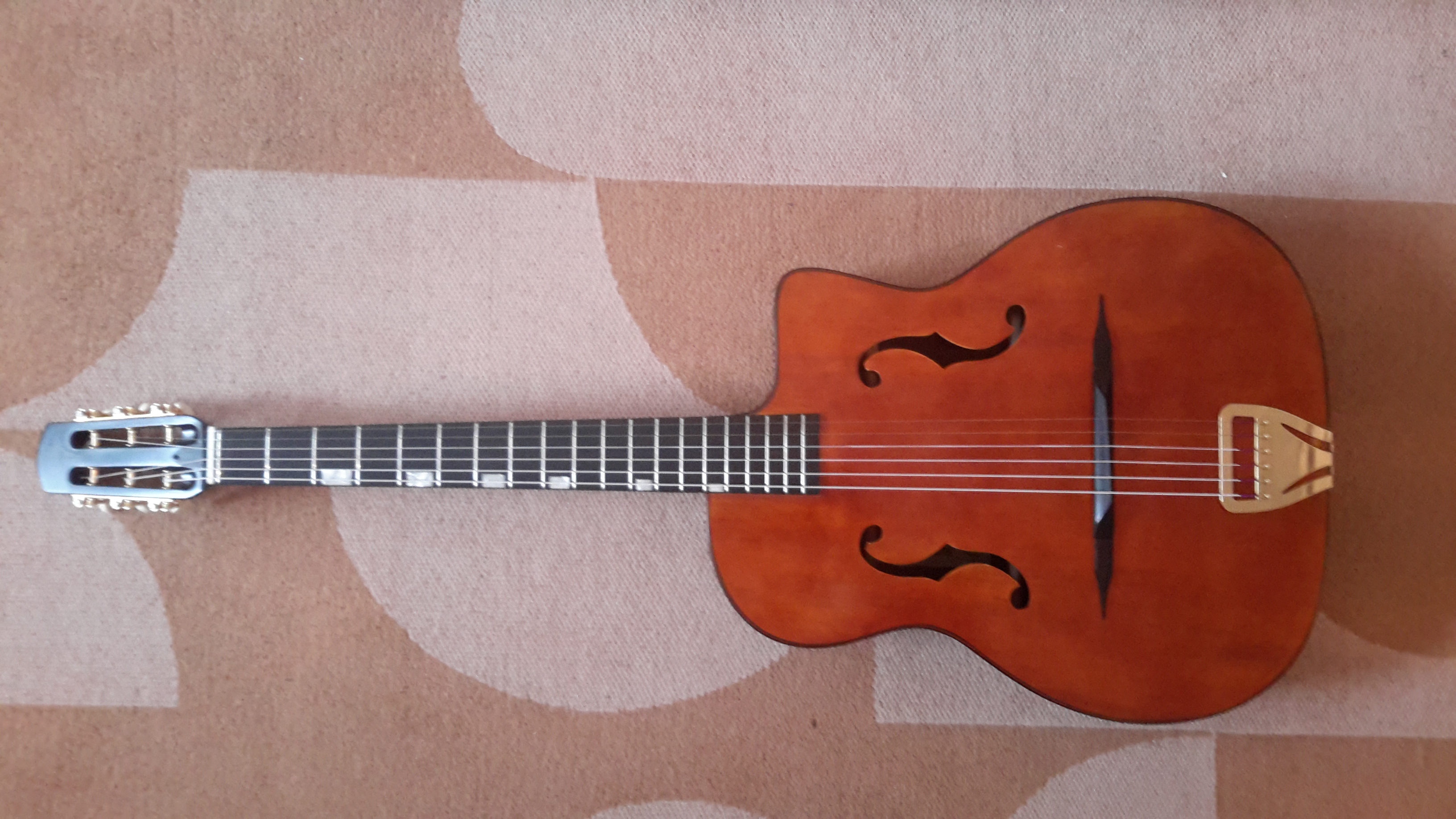

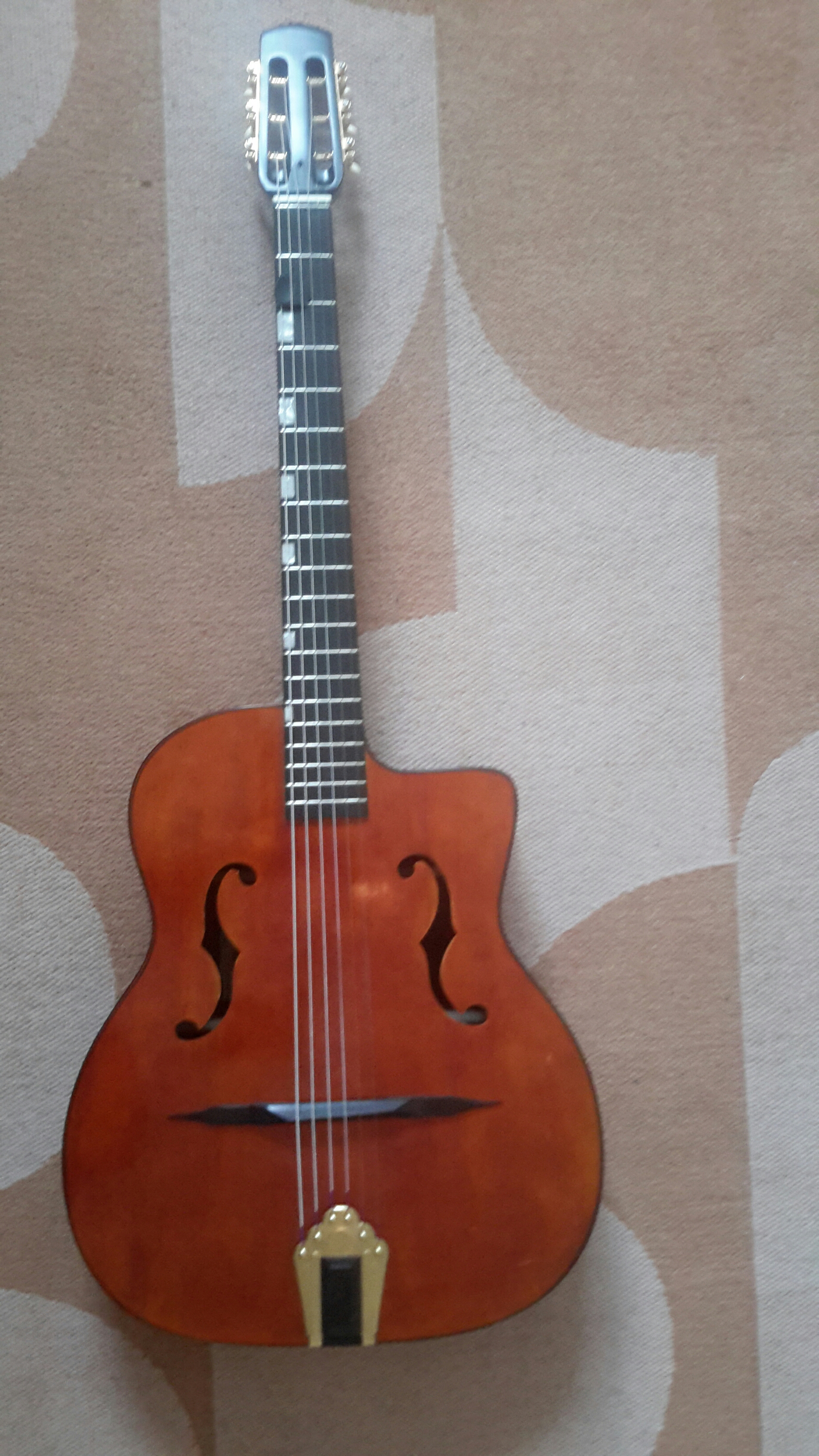

  • WillieWillie HamburgNew
    edited August 25 Posts: 924
    Changing the tailpiece of my M01f from original to Killy Nonis made the instrument sound noticeable louder and a bit more "sonor". (And look really charming.)
    BillDaCostaWilliamsJangle_JamieBrunerd1489voutoreenie
