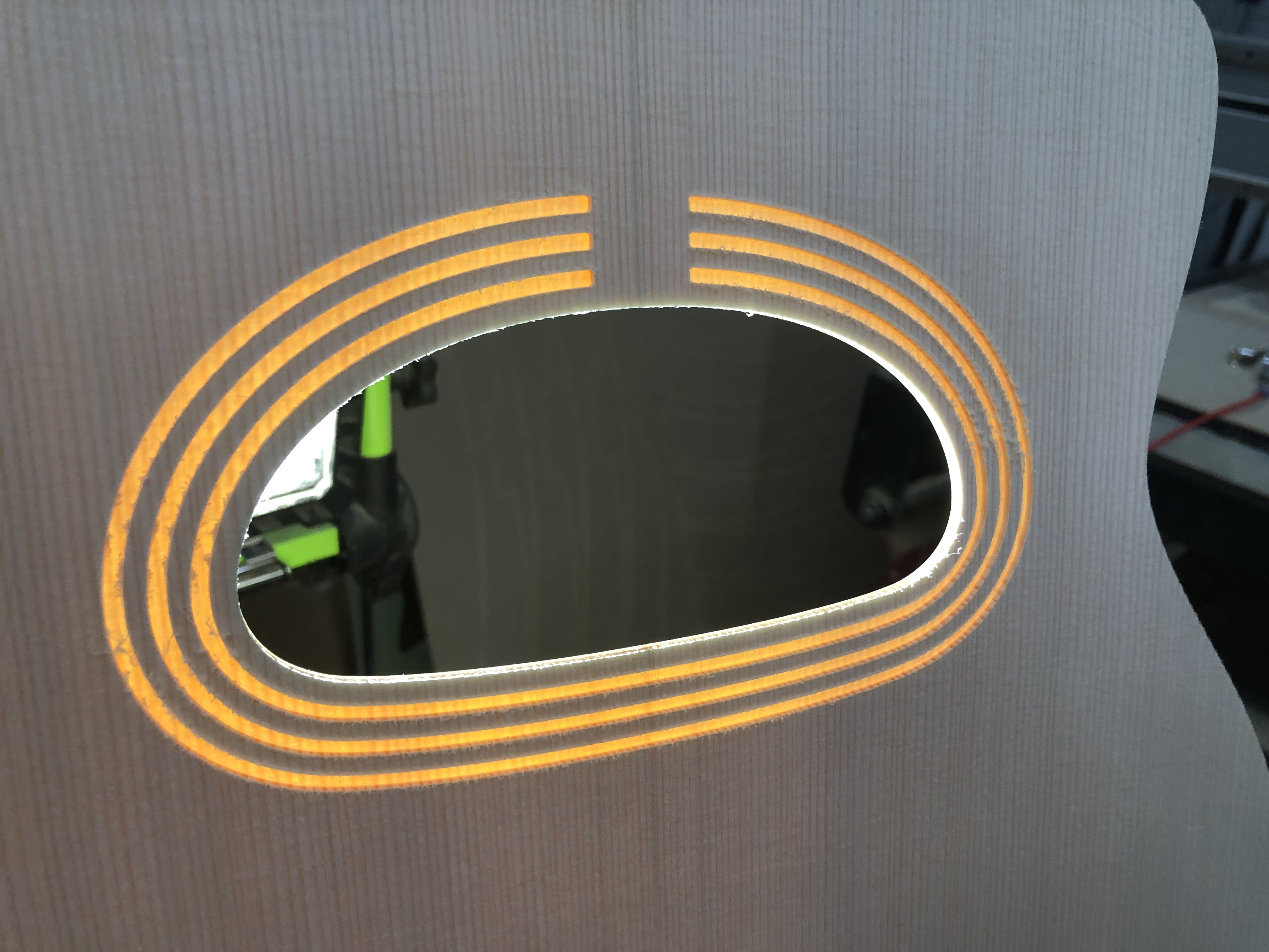

  • Posts: 20
    Machined the headstocks today and hope to get them married up to their necks in the near future. The dowel holes are to aid alignment and prevent slippage when gluing up and clamping
  • BonesBones Moderator
    Posts: 3,338
    pretty work!
