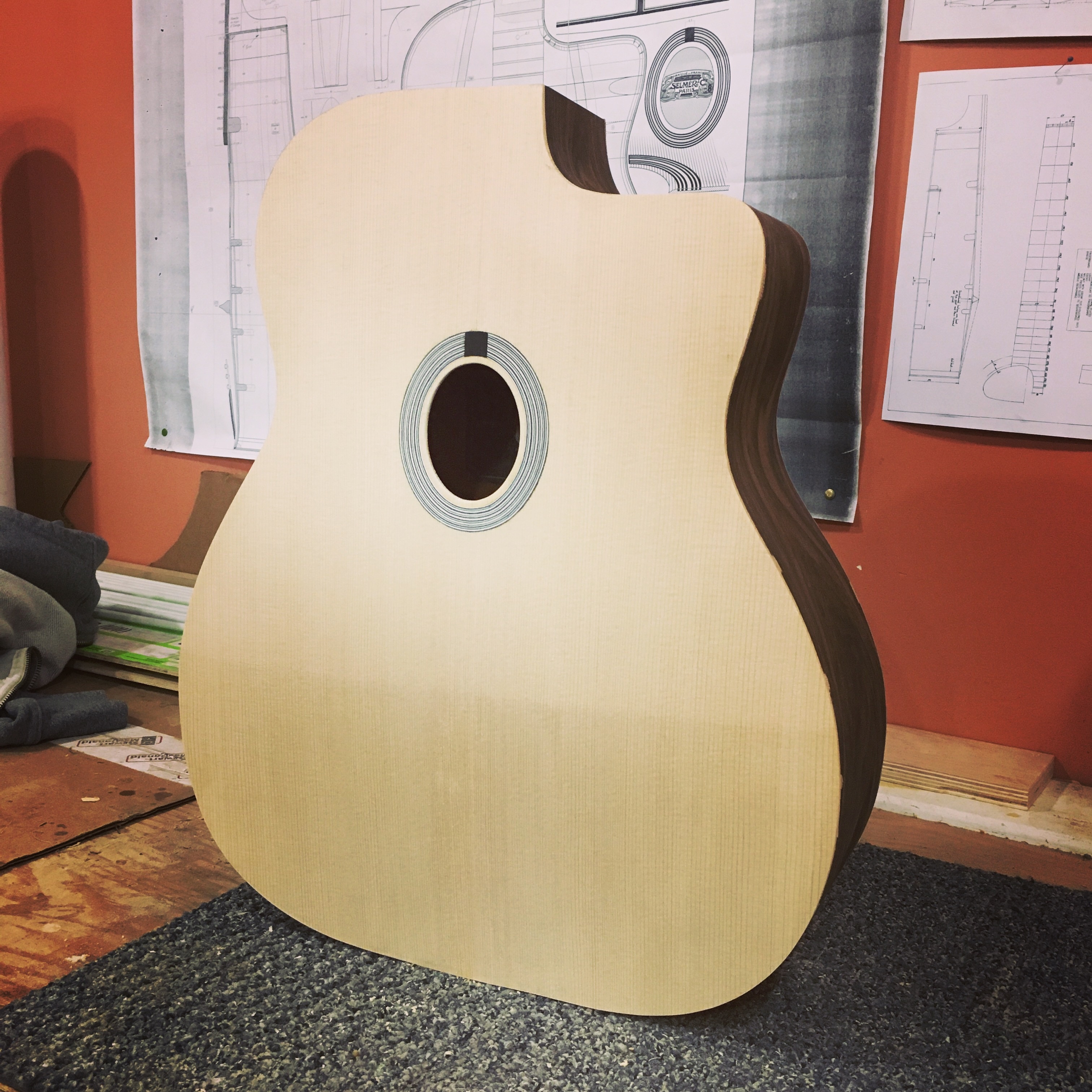

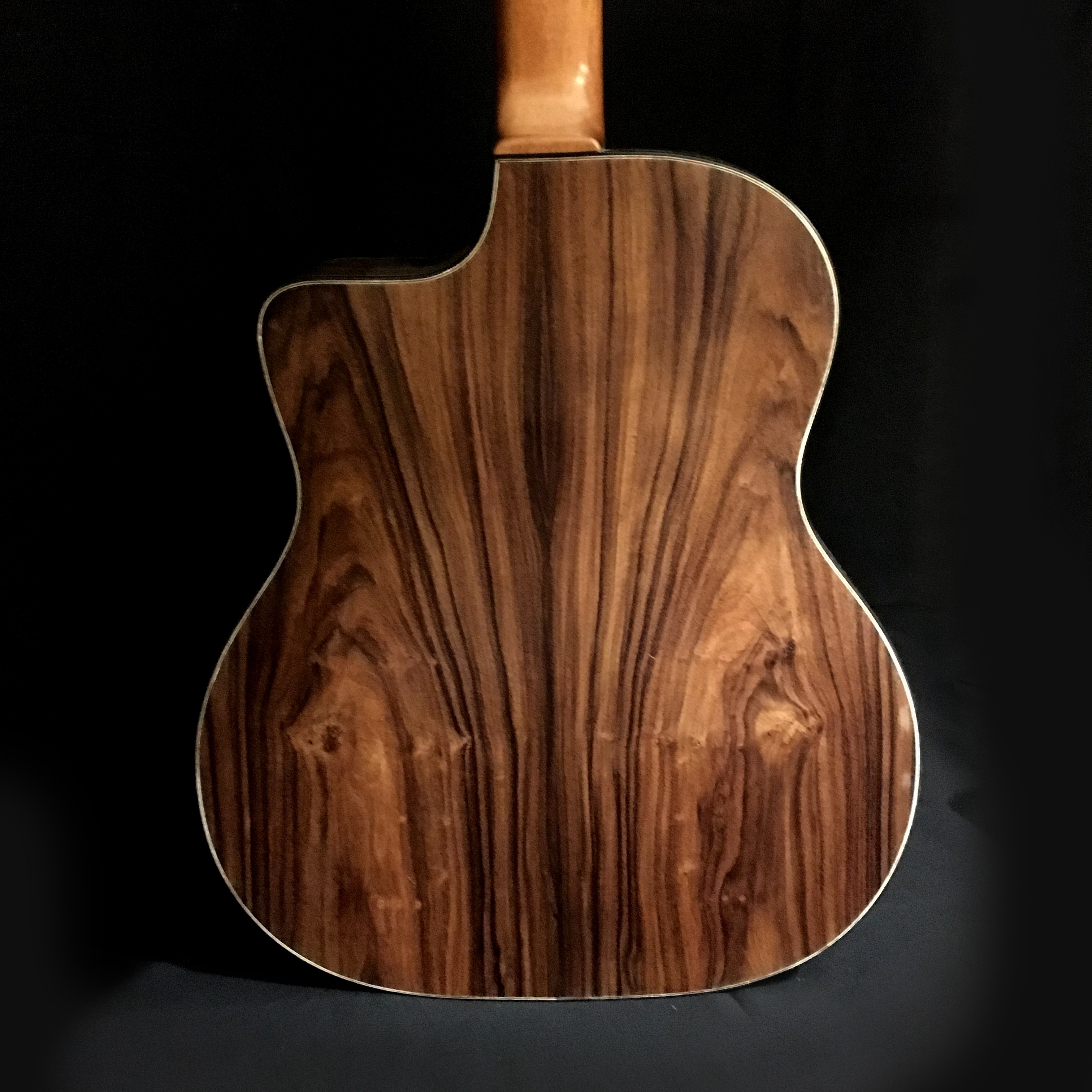

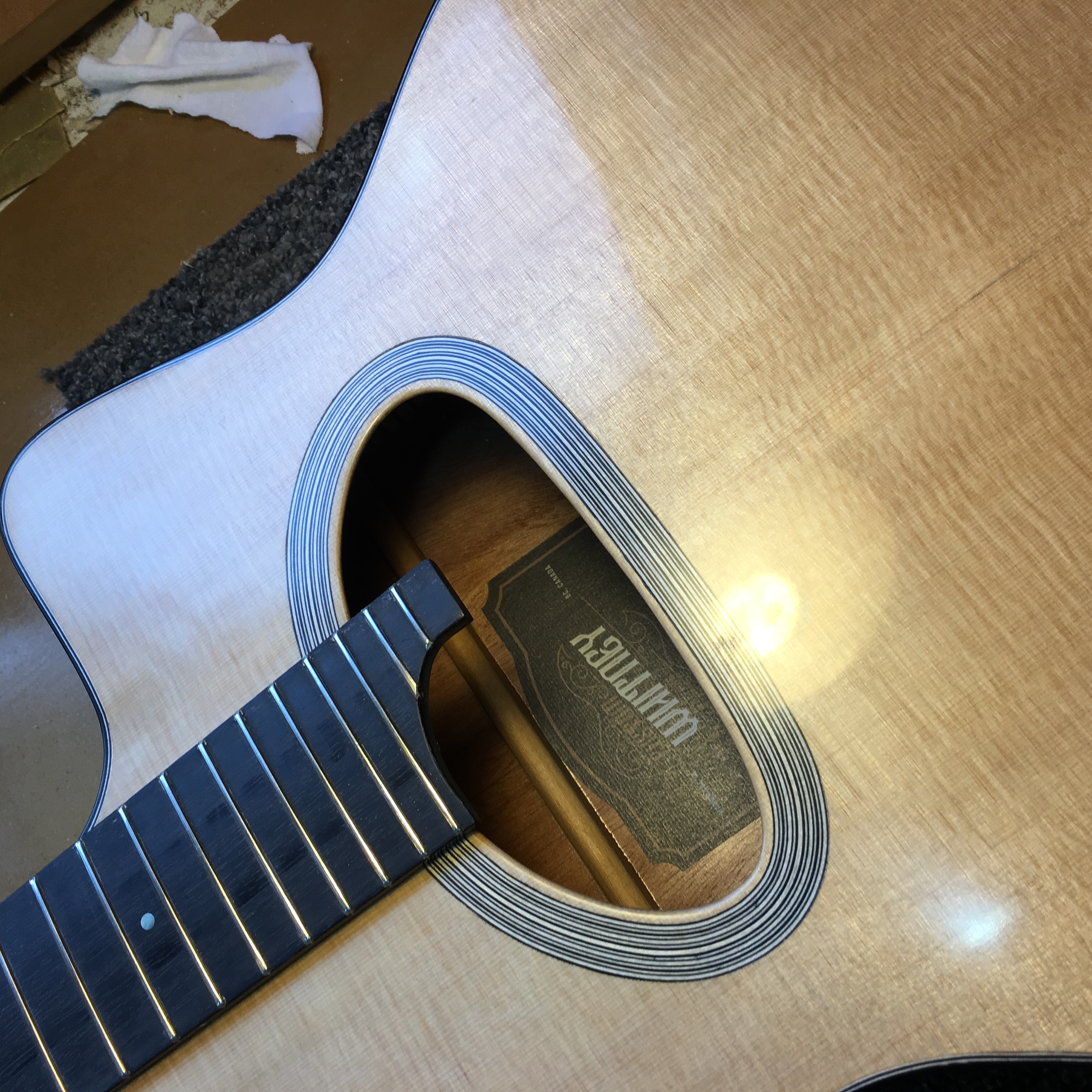

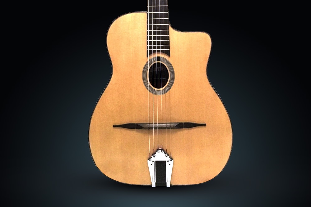

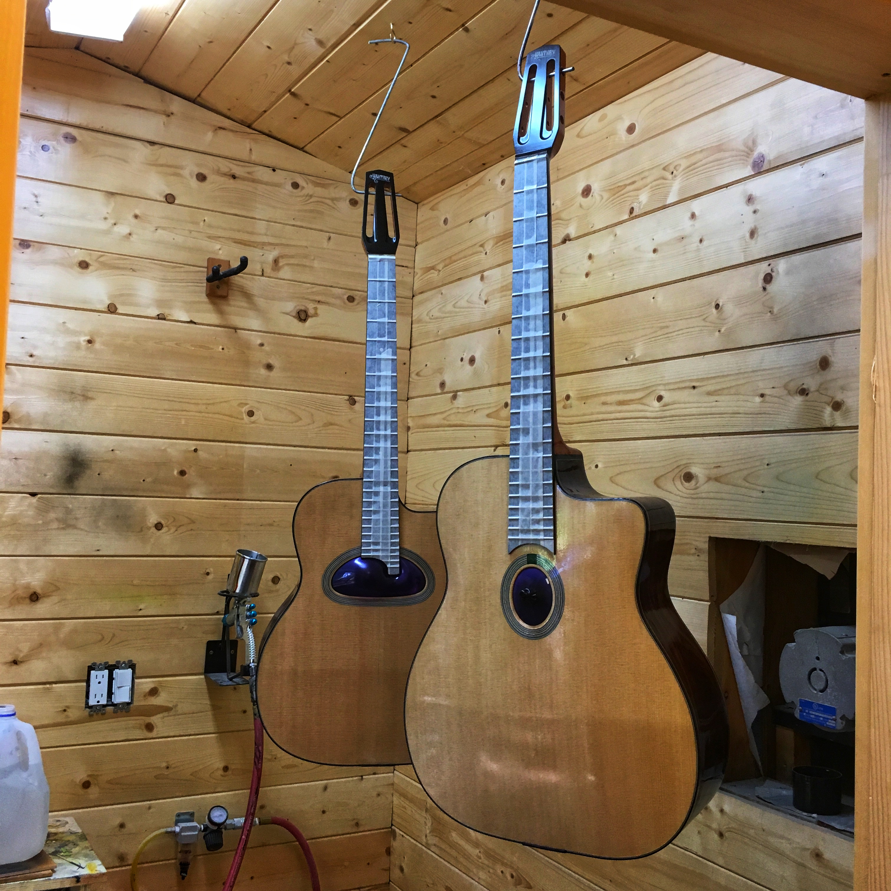

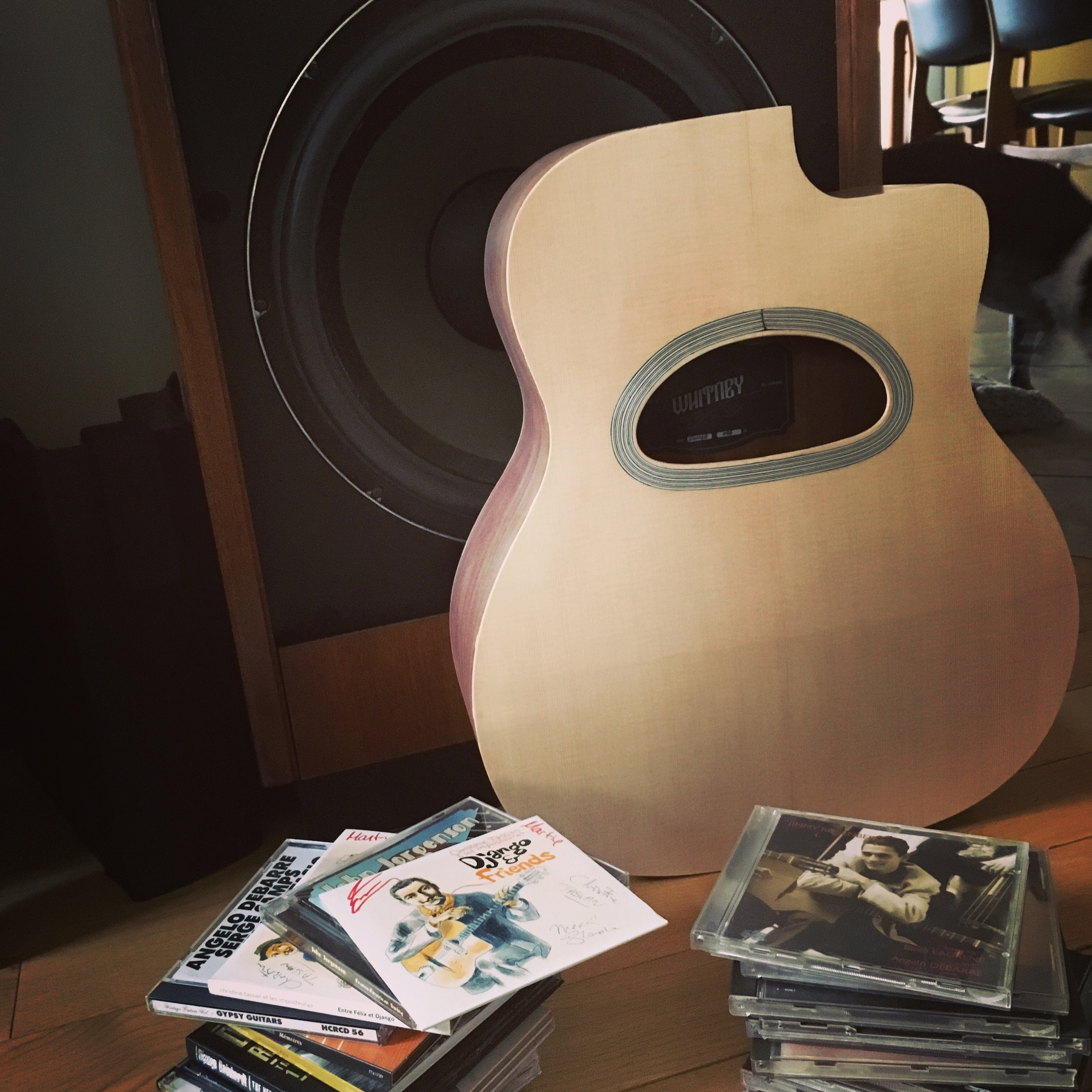

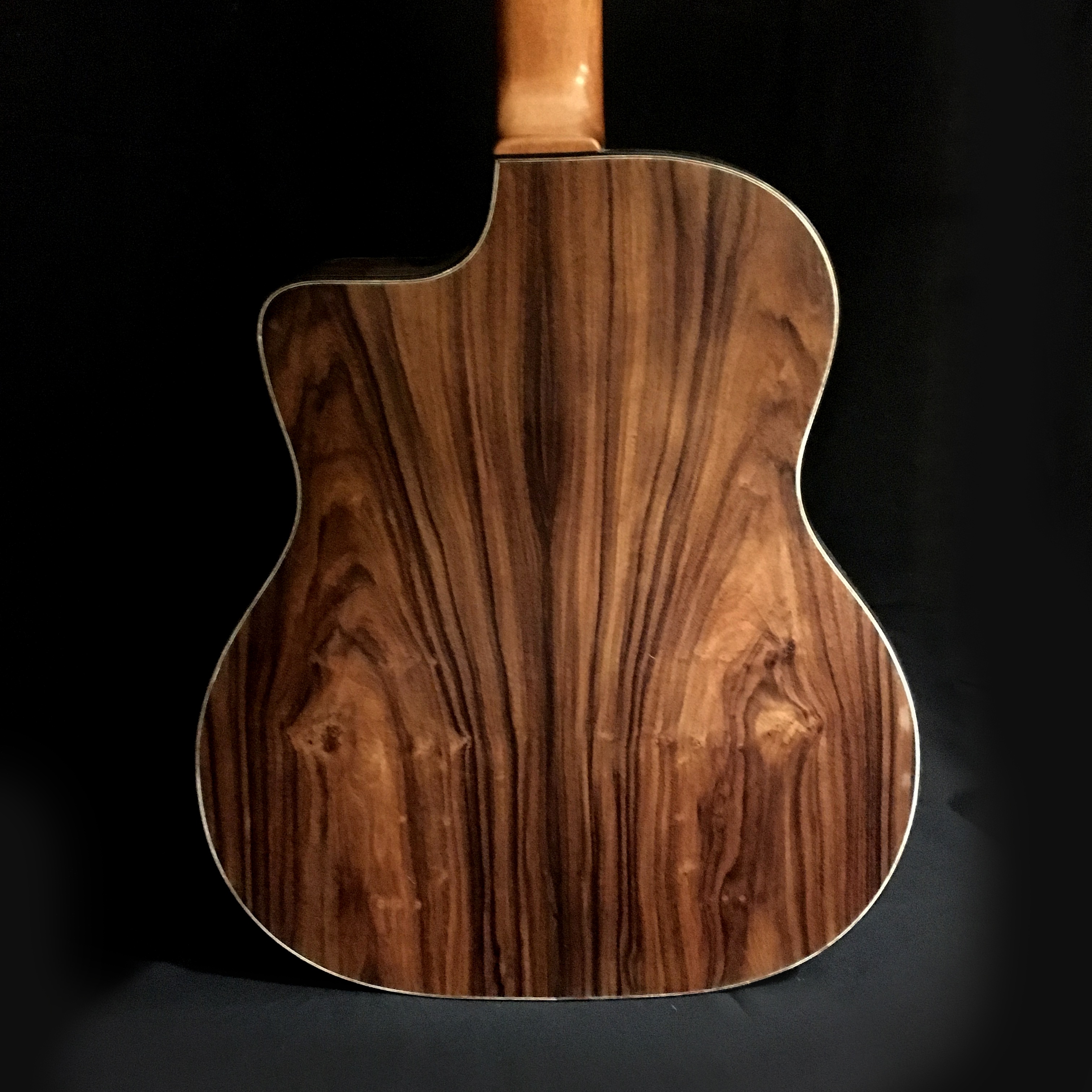

Hey fellow GJ'ers!

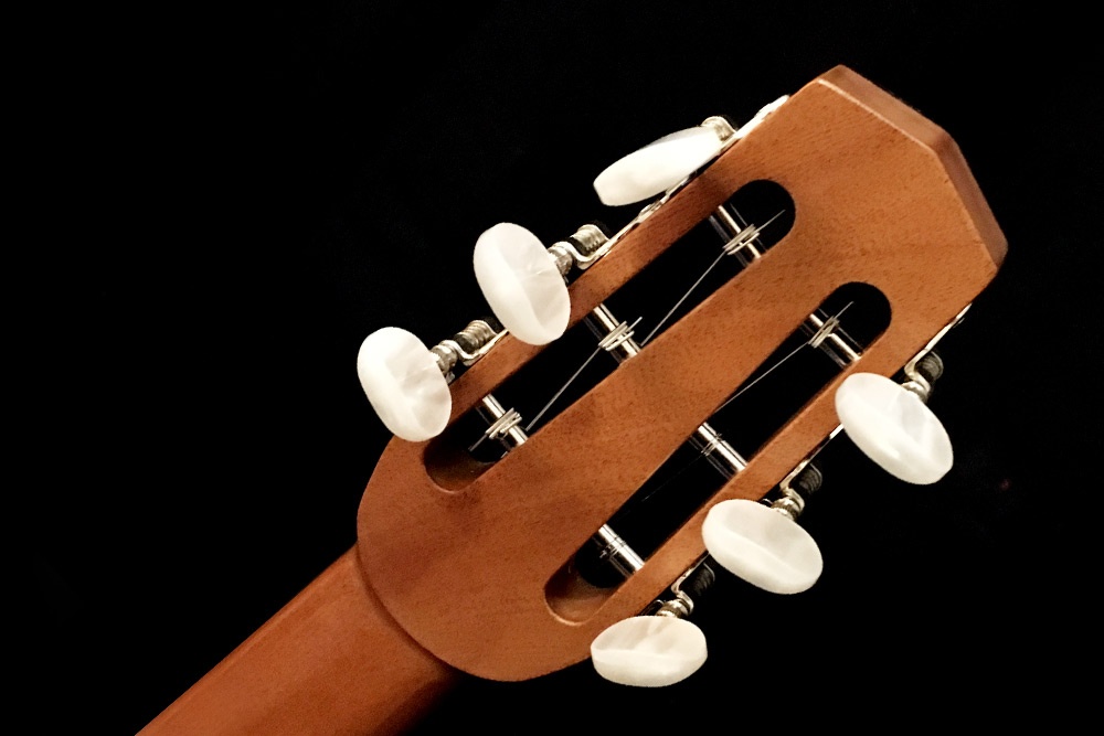

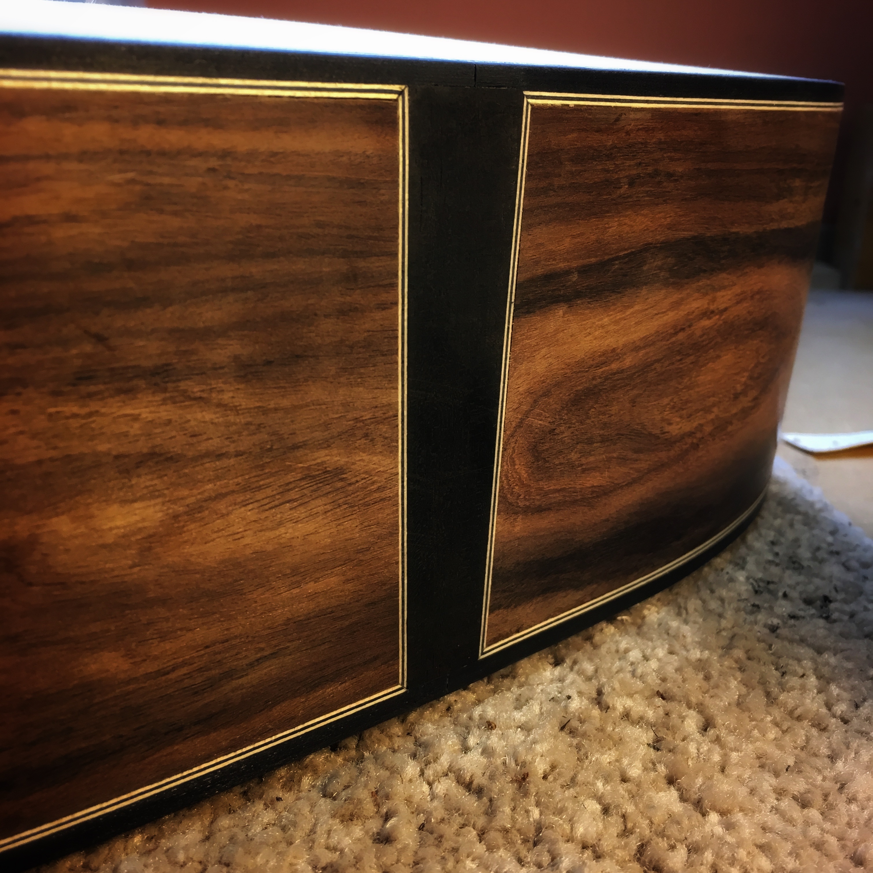

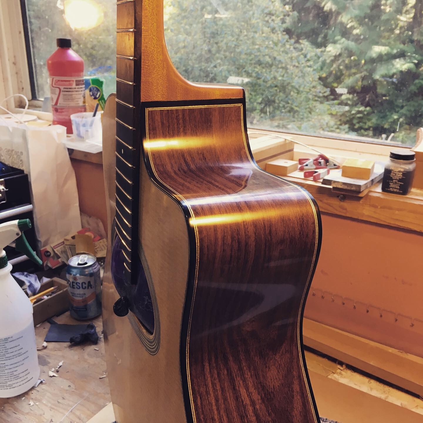

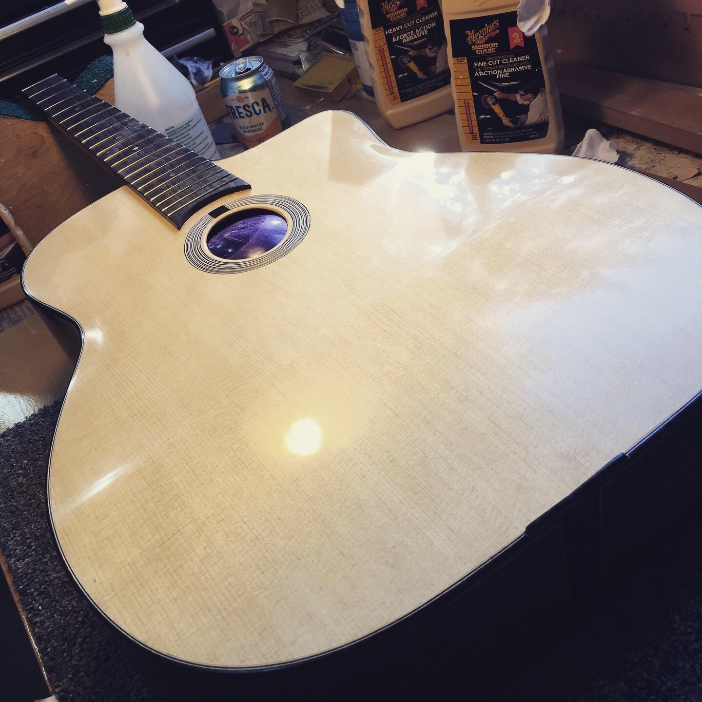

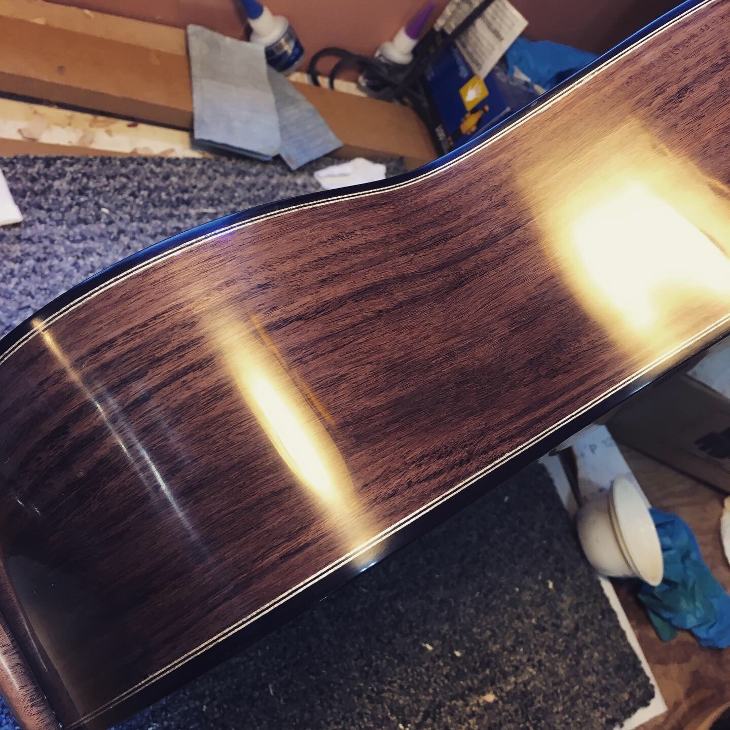

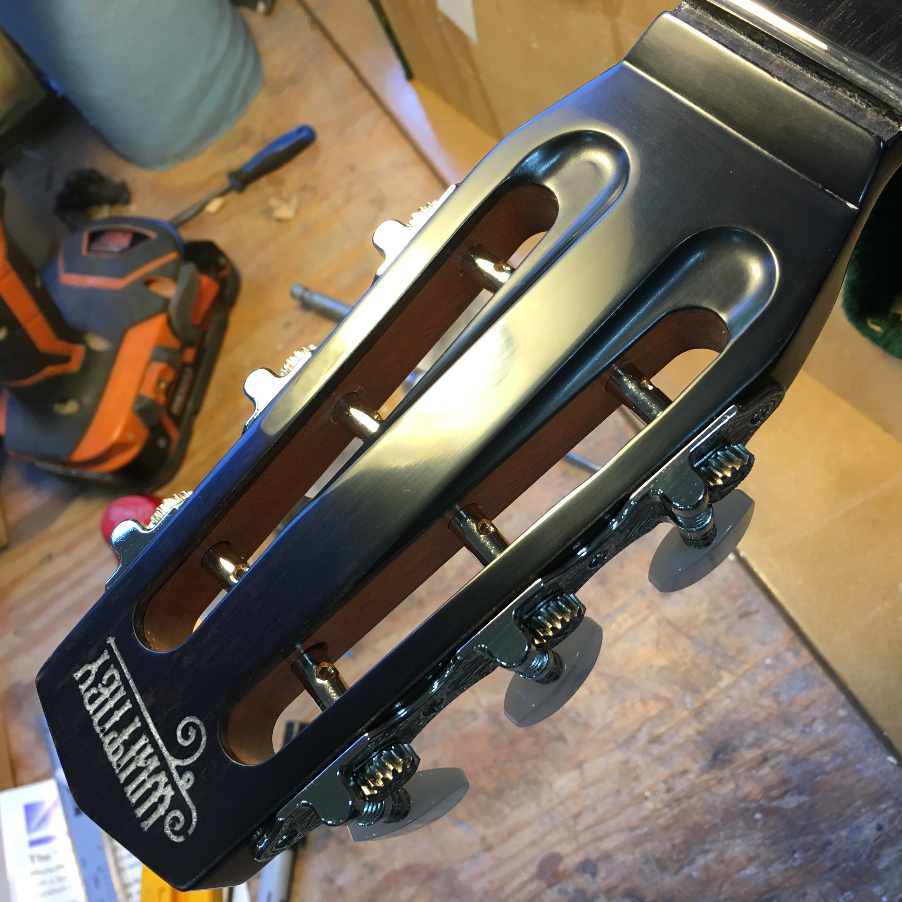

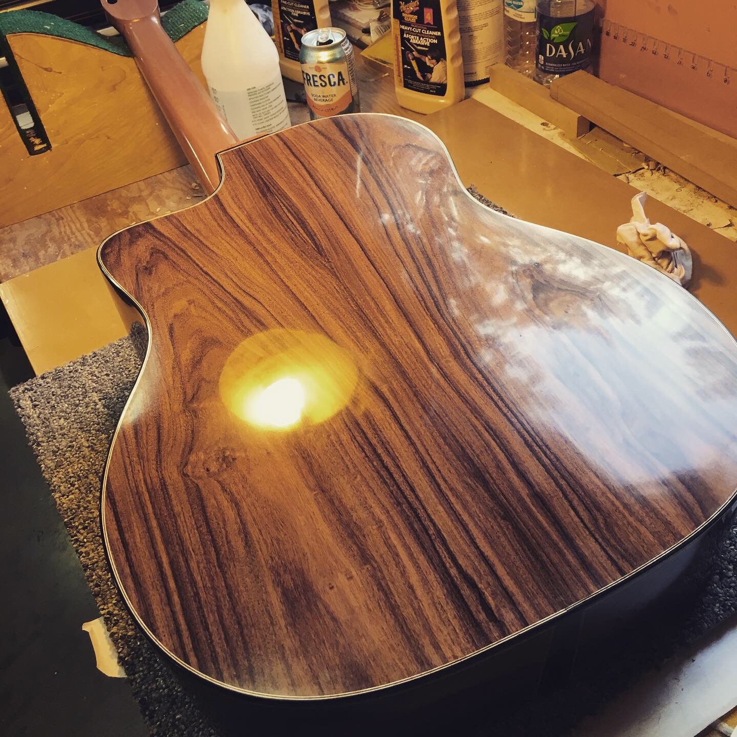

I thought I'd post an update of my first two GJ guitars based on the #807 plans from François Charle. Both feature a 14-fret connection and incorporate a 3-ply veneer for the back and sides (mahogany, poplar and pau ferro). I took artistic license with the D-hole model but have stayed fairly true-to-form by following traditional build techniques offered by Jean Barault in his 4-book series with the exception of the headstock; I've built a 3-piece neck versus the traditional 'tongue'.
Additionally, I have to tip my hat to Mr. Charle himself as well as Craig Bumgarner for taking the time to chat with a new luthier and for sharing their knowledge and skill (read as 'tons of back-and-forth via email and messenger). If either of you are reading this, I sincerely thank you again for your patience.
Thanks go out out to **** as well over at **** for offering his setup workshop at DjangoFest NW on Whidbey Island this past September and for further chatting with me despite how busy that event was! I humbly thank you.
These will be the first of many GJ and archtop guitars I'll be creating. I learned a ton and look forward to further honing my skills and creating more models / variations.
Thanks for looking!

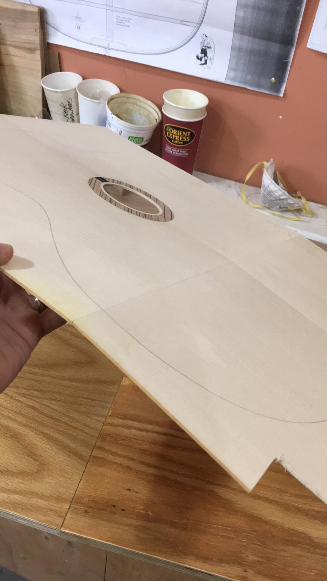

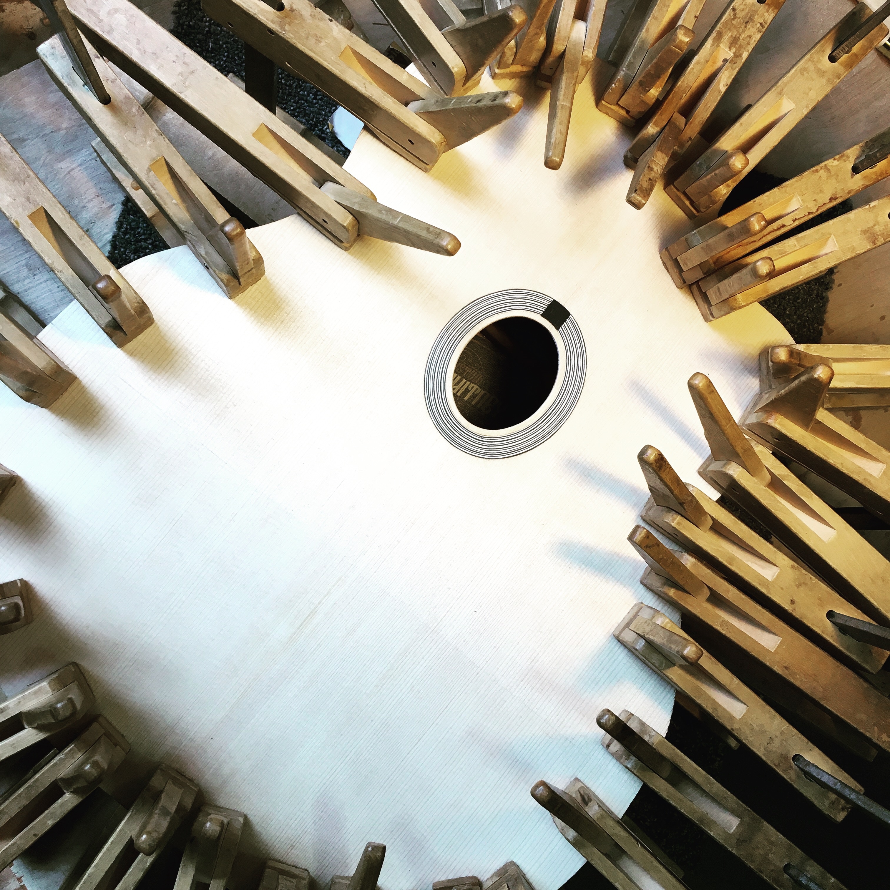

    Pretty work! Did you bend the pliage over a hot pipe?

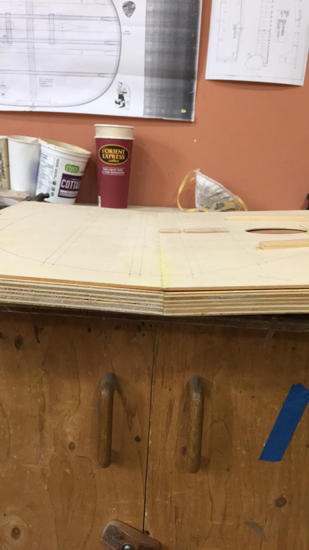

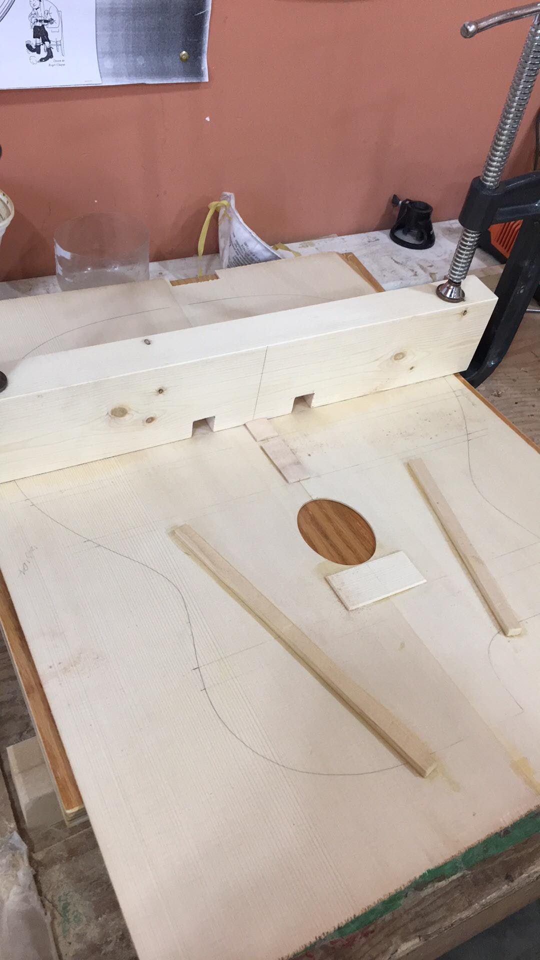

    Thank you @Bones ! I read up on a few ways to do this and ultimately followed the process outlined by Jean Barrault. I made a wooden form with a 7-degree angle to form the pliage and essentially heat pressed it with clamps and a notched 2x4. When I removed the clamps, there was essentially no spring-back, whatsoever. In other words, it remained completely 'formed' in the mold.
    After speaking with François Charle, I used his method to help set the bend by gently scoring the pliage line on the inside of the soundboard with the back of a butter-knife -- essentially like scoring a piece of cardboard if one wanted to make a crease. I wasn't keen on the hot pipe method and potential scorching the wood - just a personal preference.
    In short, I'm quite pleased with how the fold turned out as it caused me a bit of stress going in, yet seemed like a 'rite of passage' for the iconic 'fold' for these guitars. I wanted to say fairly true-to-form w/ traditional build methods.

    How did you heat the top to bend the pliage if you didn't use a hot pipe? Electric heater pad?
  • whitneyguitarswhitneyguitars New Gitane DG-340 Modele Stephane Wrembel Model
    edited December 2019 Posts: 22
    Hi Bones -

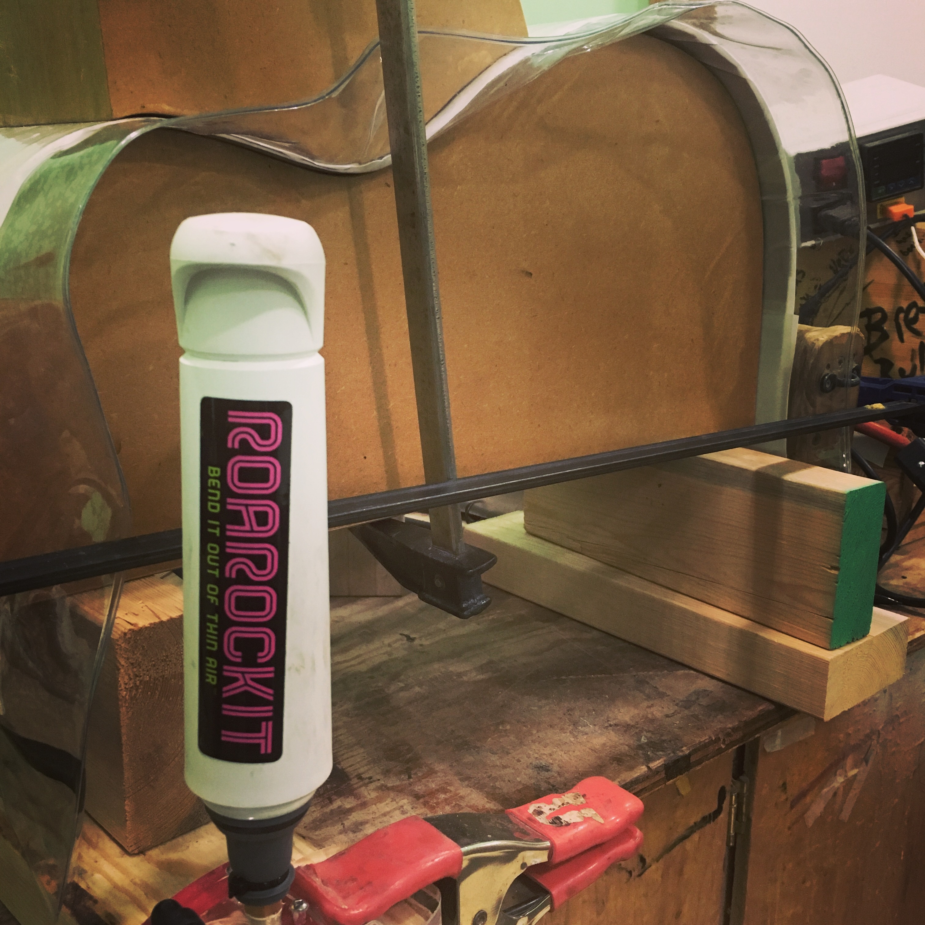

    A heating blanket would definitely work. As an aside, when bending acoustic sides (non-veneered), I usually let the blanket heat up to 300 degrees and then turn it off, letting the wood cool in the form. I don't think I'd run it that hot on a spruce / cedar top.
    To answer your question, I added boiling water to the scored line by way of a syringe on the inside of the soundboard once I had it pressed into my fixture. I repeated this process every few hours or when it was again dry. It's not as quick as a heat blanket, but I wasn't in a rush and just let it sit for a few days. This produced a great result, free of scorch marks and echoed the techniques offered in Barault's books and conversations I had with F. Charle.
    To secure the soundboard in the form, I just ran a 2x4 through the jointer to square up all faces (cut to about 20" long to extend beyond the lower bout and then used C-clamps on each end to tighten it down along the pliage.
  • BonesBones Moderator
    Posts: 3,338
    Ok so you cold bent it into the form and clamped it there? Interesting. Any pictures you can post?
