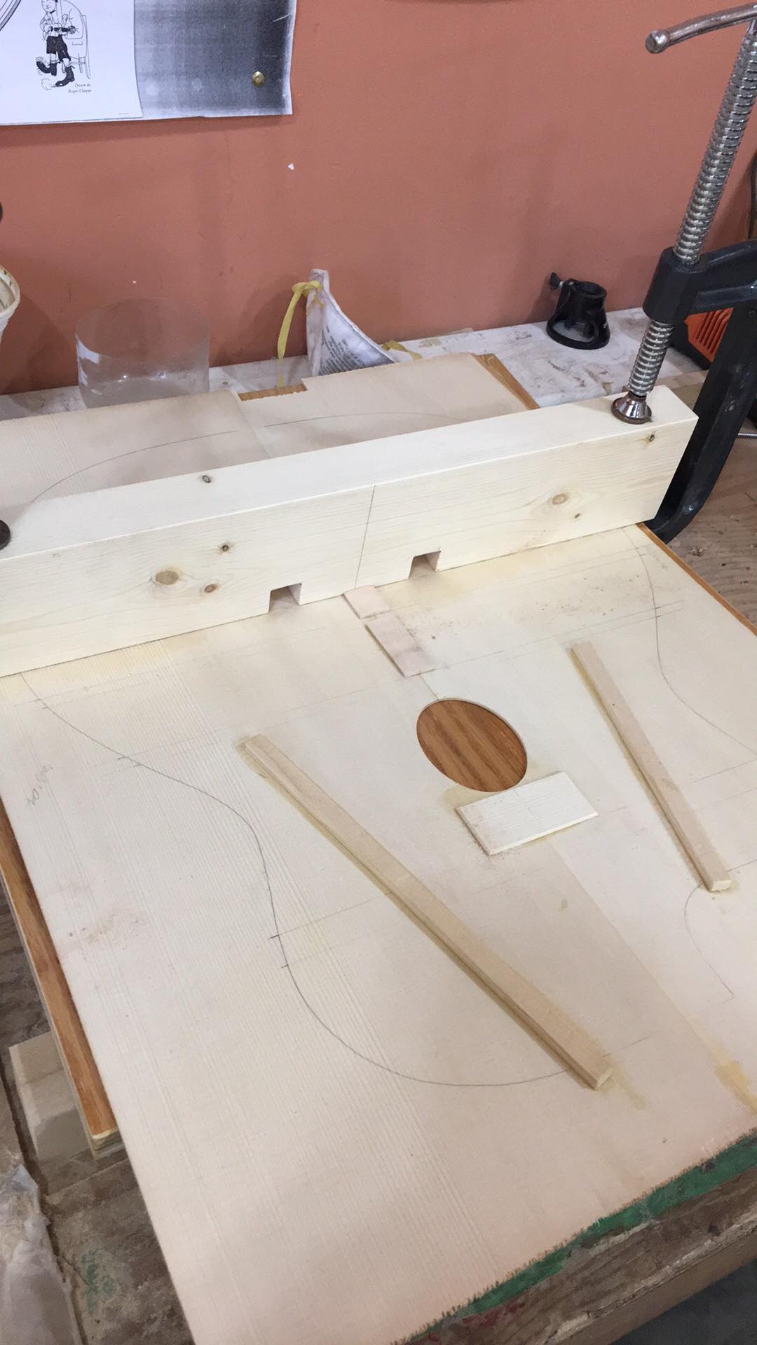

    @Bones - I found some shots of the setup I had sent off via messenger. Hope these help...

    Ok so you score, wet the score, and force down into the 7 degree form with the cross member? thx

    Hey bones, you got it.
    That sounds like a valid concern. For what it's worth, I used Titebond 3 - perhaps a bit overkill but it has a higher moisture rating than '1' and '2'.
    I can only speak to the method of bending I employed but suspect that even the original Titebond would have been fine. The only heat I applied was with the boiling water through a syringe (with a needle) and I only targeted the scored line and didn't saturate the wood.
    (EDIT) My soundboards have been joined since June and I see no signs of failure whatsoever. Cheers.
