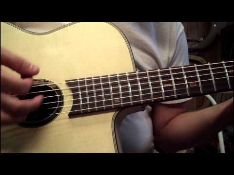

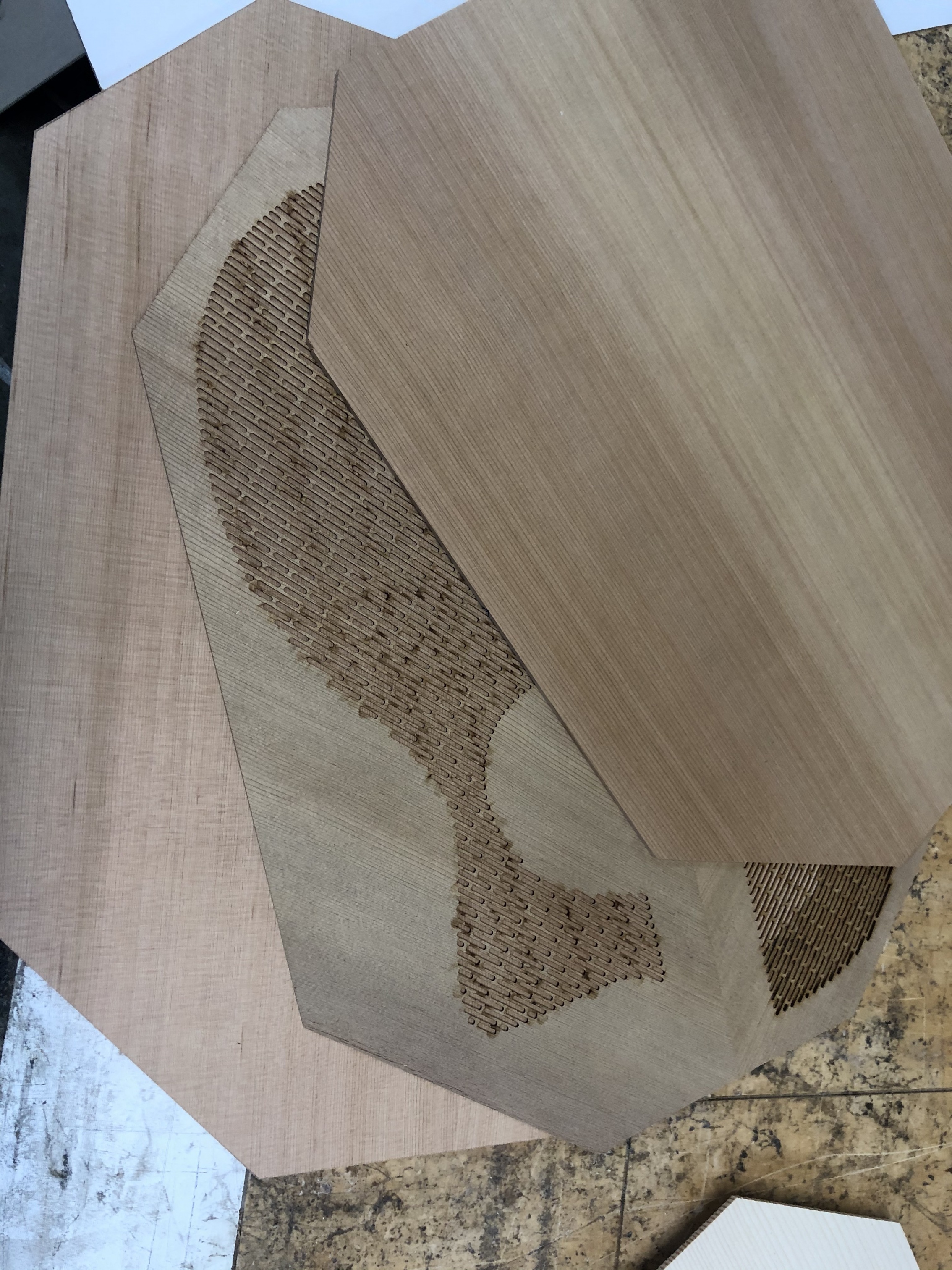

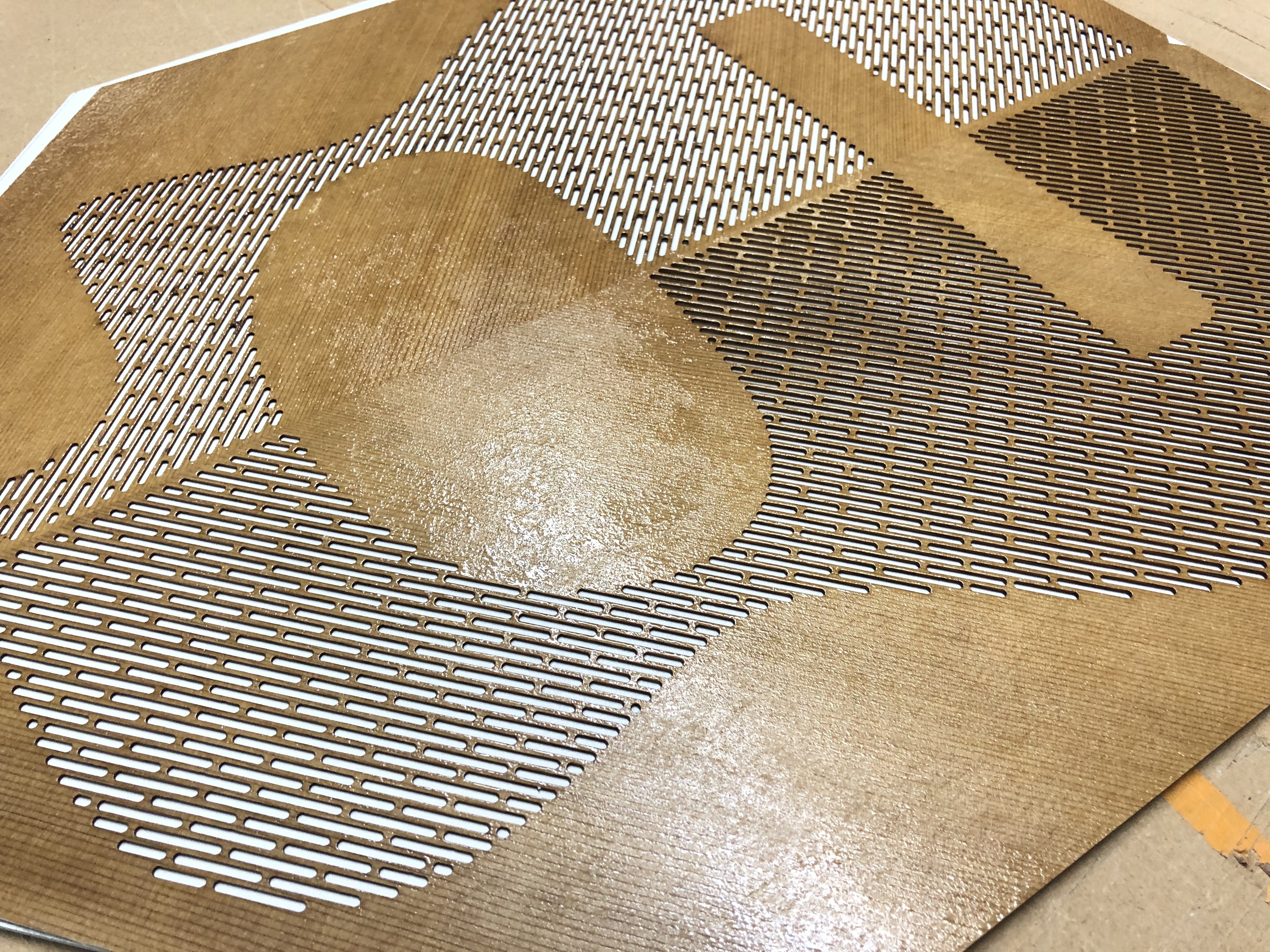

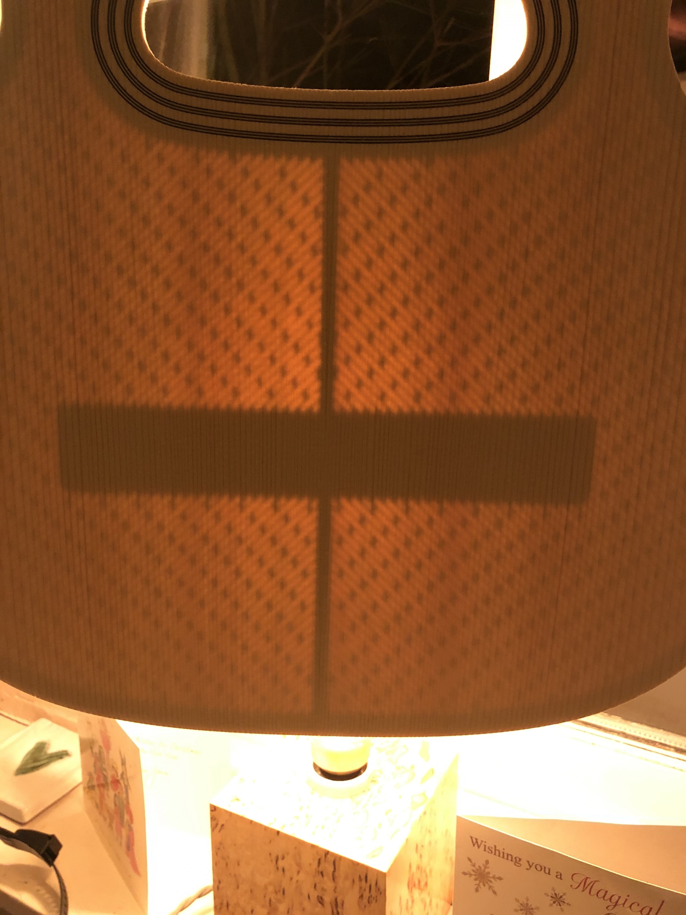

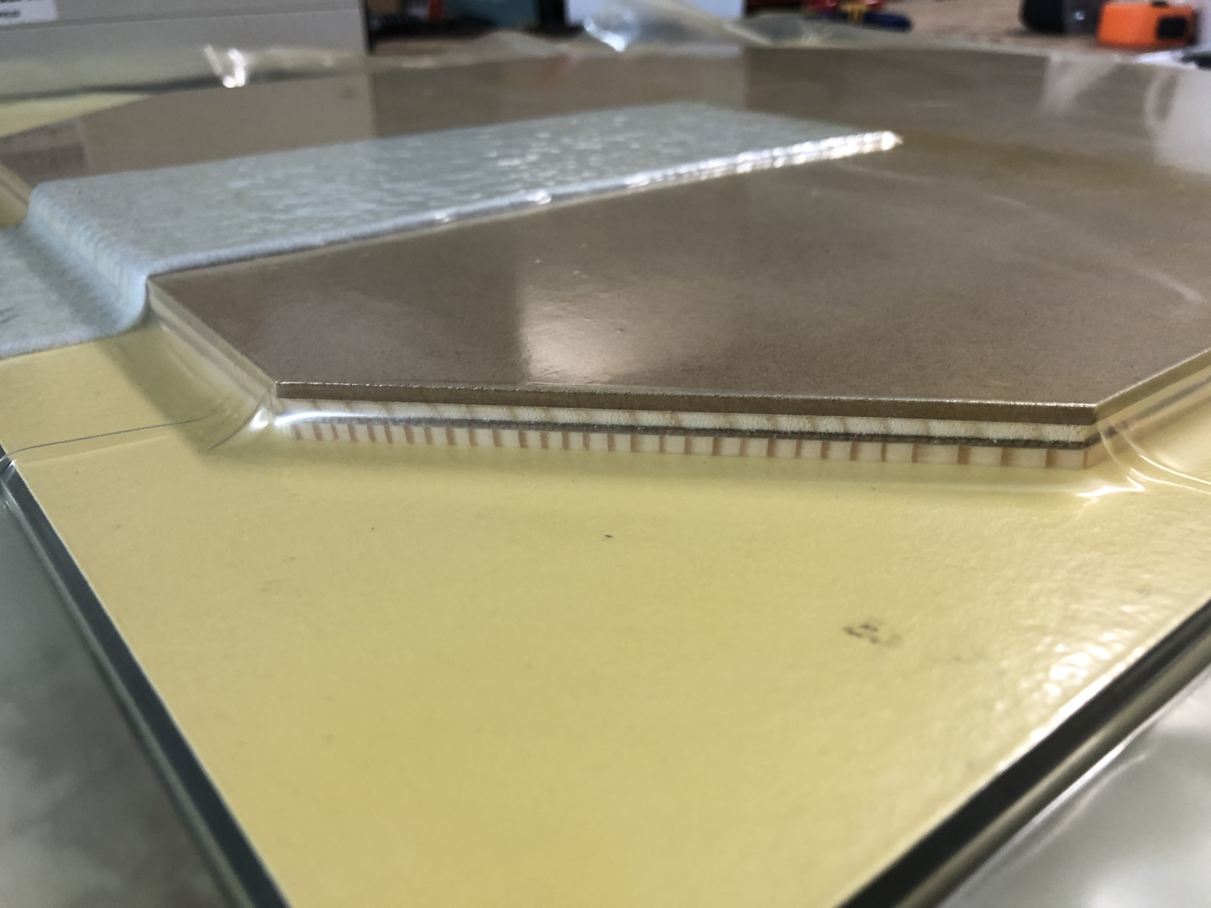

I have recently begun making double top Selmer style guitars. Here is the latest version strung up in the white. I would appreciate any feedback. I am hoping this guitar will make it's debut at DjangoFest North West. Please pardon my bad playing.
Thanks for having a look.
