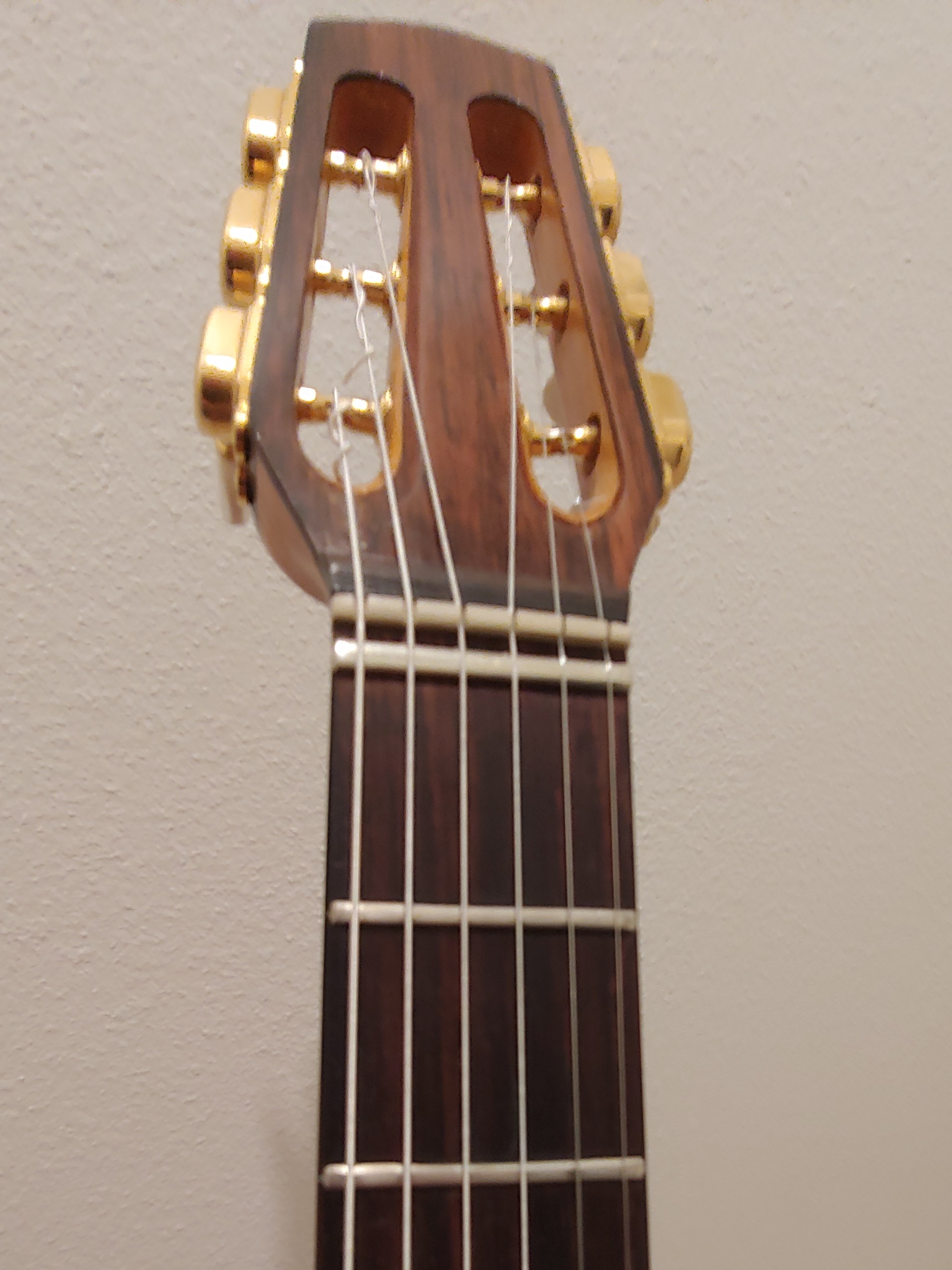

    Hey Buco, how did you raise the zero fret?
  • Posts: 6,161
    @Bones first I used a shim out of soda can but that killed the sound, took the highs out of it. Then I used a good quality stainless steel shim and that worked well. Until yesterday when @Craig Bumgarner replaced the fret. It was huge to start with, 2.47mm. Took Craig a lot of elbow grease to get it down to 1.8mm, it was a beast to work with. But it's in and looking great. Thank you Craig! Oh by the way if anyone wants a piece let me know, I had to buy a two foot section. That's one imposing zero fret...
    BonesCraig Bumgarner
