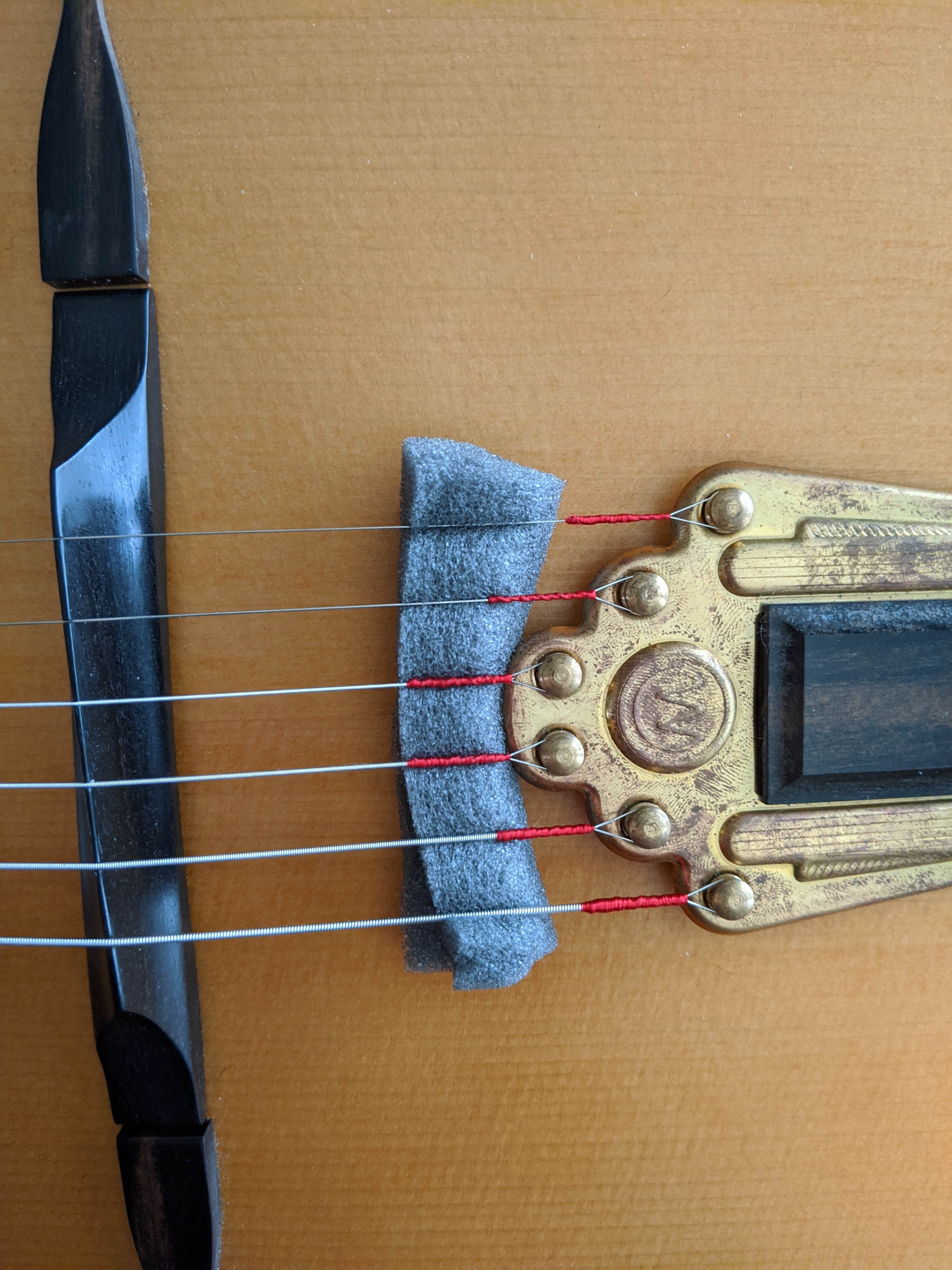

    A small piece of soft foam weather stripping is also great to mute unwanted symptathetic tailpiece and post-bridge vibration, which can be quite annoying and rather unharmonious. It's light enough that it slides in without dampening the top.
    Glad you got it under control!
  • BonesBones Moderator
    Posts: 3,339
    Oh yeah, what Mac said too. Although I have used a piece of Velcro just around the strings so nothing touches the top.
