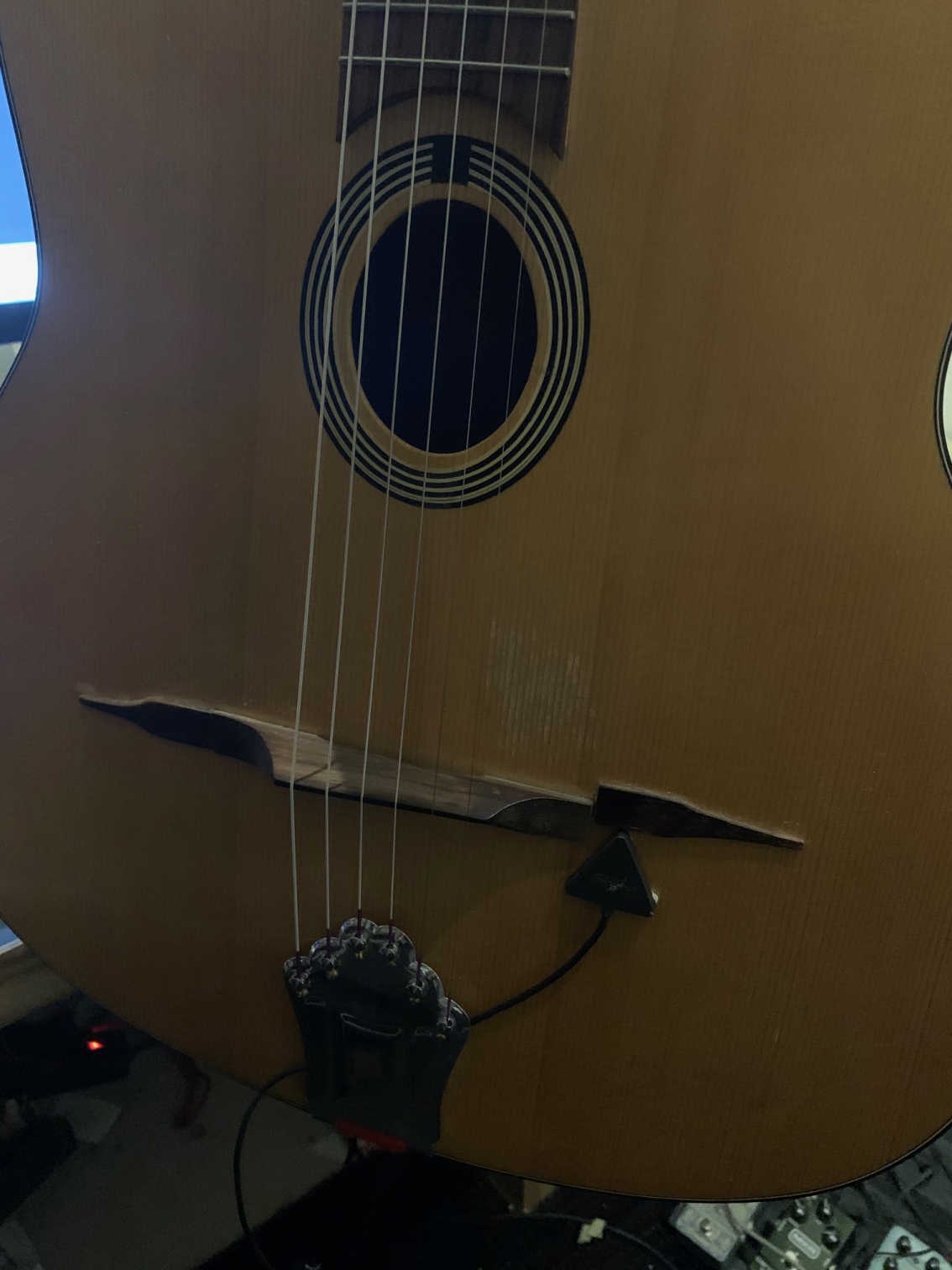

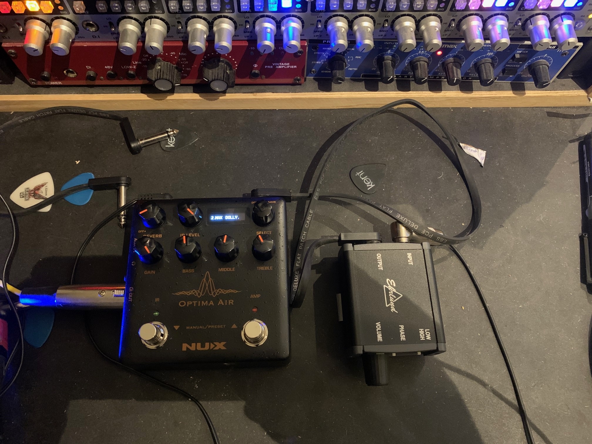

    I`ve been playing with the Nux optima a couple of hours now.
    It´s a solid little piece of gear, feels sturdy and no worries taking it to a ( future) gig.
    The included IR´s is useless for this style of music, no surprise there, So you really need to create your own.
    Process goes like this: Connect your guitar ( piezo) to input. Insert a mic preamp with condenser mic into Nux return loop. Fire the thing up with left footswitch depressed. Adjust levels, Nux does not have any way of adjusting input level, so one must match the output of the piezo to the output of the mic preamp - Nux have a small screen showing input levels. Capturing takes 10 seconds, no more or less. If You like what you hear- save it, if not, redo the capturing.
    It´s not rocket science, but it takes some effort. I have just done two sessions ( maybe 20 min total) and I´m happy enough to go and gig with it. It really works, and I´m really impressed. I still feel I can get better results with more careful placement of mic, gain staging and room adjustment. And I´m curious to see (hear) how big the difference is with different preamps, mics etc.
    I guess there is a bit of a learning curve to get really good IR´s, So I might get back to that once I have more time with this little machine. Also I think it´s easier to be two persons doing the capturing, one playing and one doing the rest. But it´s still no problem to do it by yourself, although looking at youtube clips, looks even easier and more controllable thing to do on the Tonedexter,
    I have still only tested the Nux at home, no rehersal yet. And in times of Covid, sorry to say, obviously no gigs.
    Major improvement in sound in my amp (roland ac 60) feels like I also can play louder with the Nux. it´s also really nice to be able to hook it up to a DAW and play in front of monitors, it does not feed back at all. Recorded the clip with headphones, but might just as well have used the monitors, So thats promisin for the PA system as well, but will try that next week.
    Attached mp3 have 3 shorts phrases - First one being guitar piezo directly into DAW - then the Nux - piezo - nux etc..0
    Last 2 clips might distort a bit, sorry about that, but no time to redo.
    Signal is like this: Homebuilt guitar - Ehrlund piezo into Ehrlund preamp - Nux optima - UAD apollo - Pro Tools.
    I added a bit of reverb just to make the sound somewhat more listenable ( remeber this is a gizmo for loud live use)
    The IR i did with a violet dolly condenser into a Audient ASP 880 preamp - Ehrlund piezo on guitar.
    So far, what I do like about the Nux: price is good, I´m impressed with the IR thing, it works. The onboard preamp and eq is fantastic, it reallly does a great job. warm and big. Fx loop is nice ( placed a tuner there, works great.) small footprint.
    What I don´t like: It has a reverb, I´d rather would have had something else in place of the knob -input adjust or something. the reverb itself is kind of ok, but nothing special, and who wants reverb in this style of music?
    Footswitches controls preset/ IR and preamp - it´s a bit fiddly and I keep changing between modes and not find my way back. Preset managing is not obvious, I did struggle a bit to be fair.
    For the IR capturing I´ve done so far I can hear my room in the IR - that´s not something I like to hear, but I´m not certain it´s possible to do a IR and not get the roomsound to be present in the IR.
    In total: IR´s seams to be the way to be able to play loud with a somewhat decent sound, and while the Nux sounds promising I will not hesitate to buy the Tonedexter if the Nux is not up for the job.. It´s still cheap given the improvement in live sound I think this technology delivers - I´m superinspired to go out and gig and find out how it performs in real life - but impressed at the moment I am..
