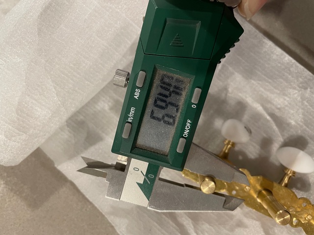

    Apologies for reviving an old thread, but I wanted to share my recent experience after purchasing some of these tuners based on this discussion (this post still comes up as one of the top results when searching for "Gallato tuners").

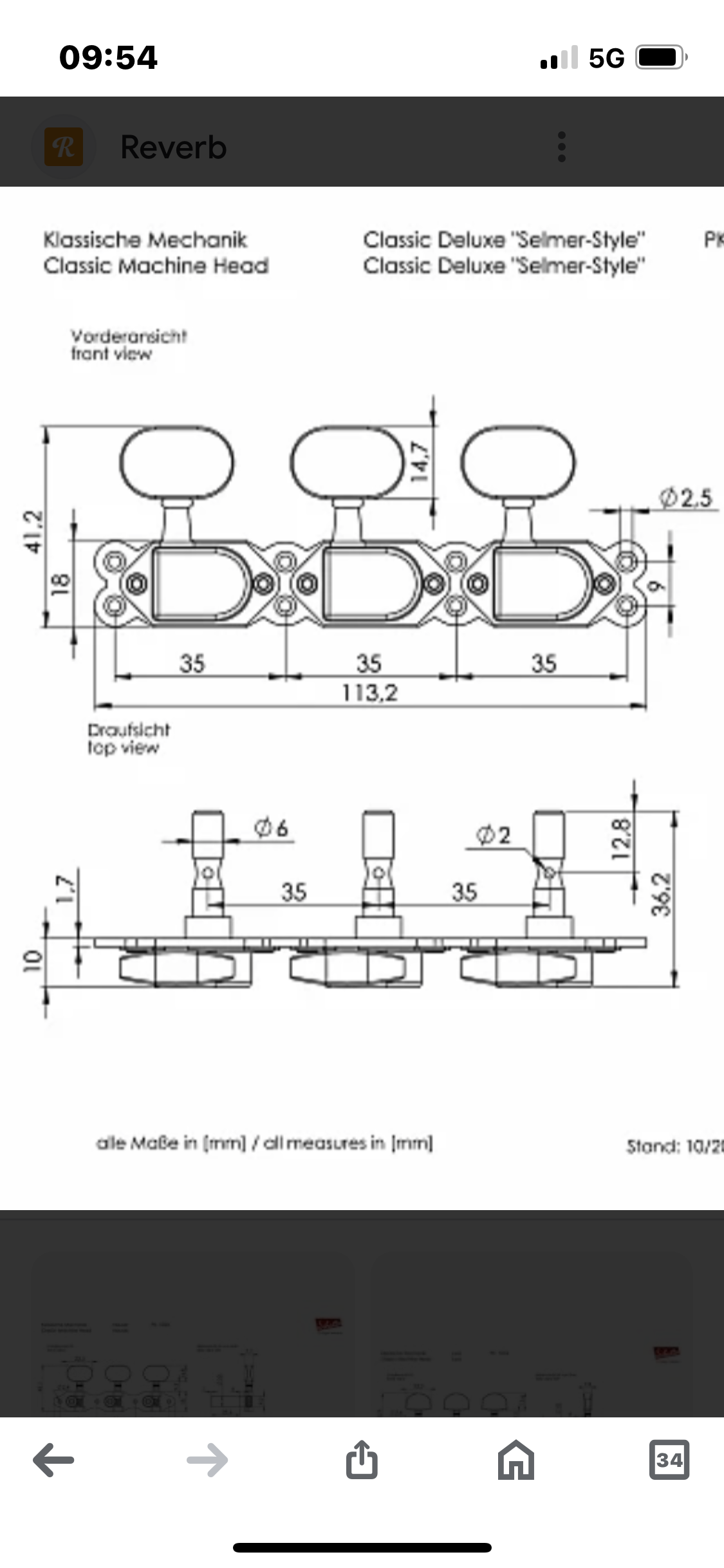

    A little while ago, I contacted Gallato to ask about the technical specifications of the tuners to see if they would fit my Dupont guitar. He sent me a technical diagram, which I've attached, showing the shafts as 6mm. I double-checked with him because I had seen them listed elsewhere as 7mm. He confirmed again that they would fit.
    However, when the tuners arrived, they were indeed 7mm. I reached out to request a return and refund but haven’t received any response.
    Additionally, I want to point out that the tuners seem to be of very low quality. They all feel stiff, with inconsistent actuation, except for one, which is so loose that the post rattles. The castings are also rough. Frankly, I wouldn’t feel comfortable installing these on any guitar.
    At this point, I’m unsure what to do, as I don’t expect to hear back from Gallato. This might just be an expensive lesson learned (for context, I have Miller tuners on another guitar and love them)
    Actual diameter
