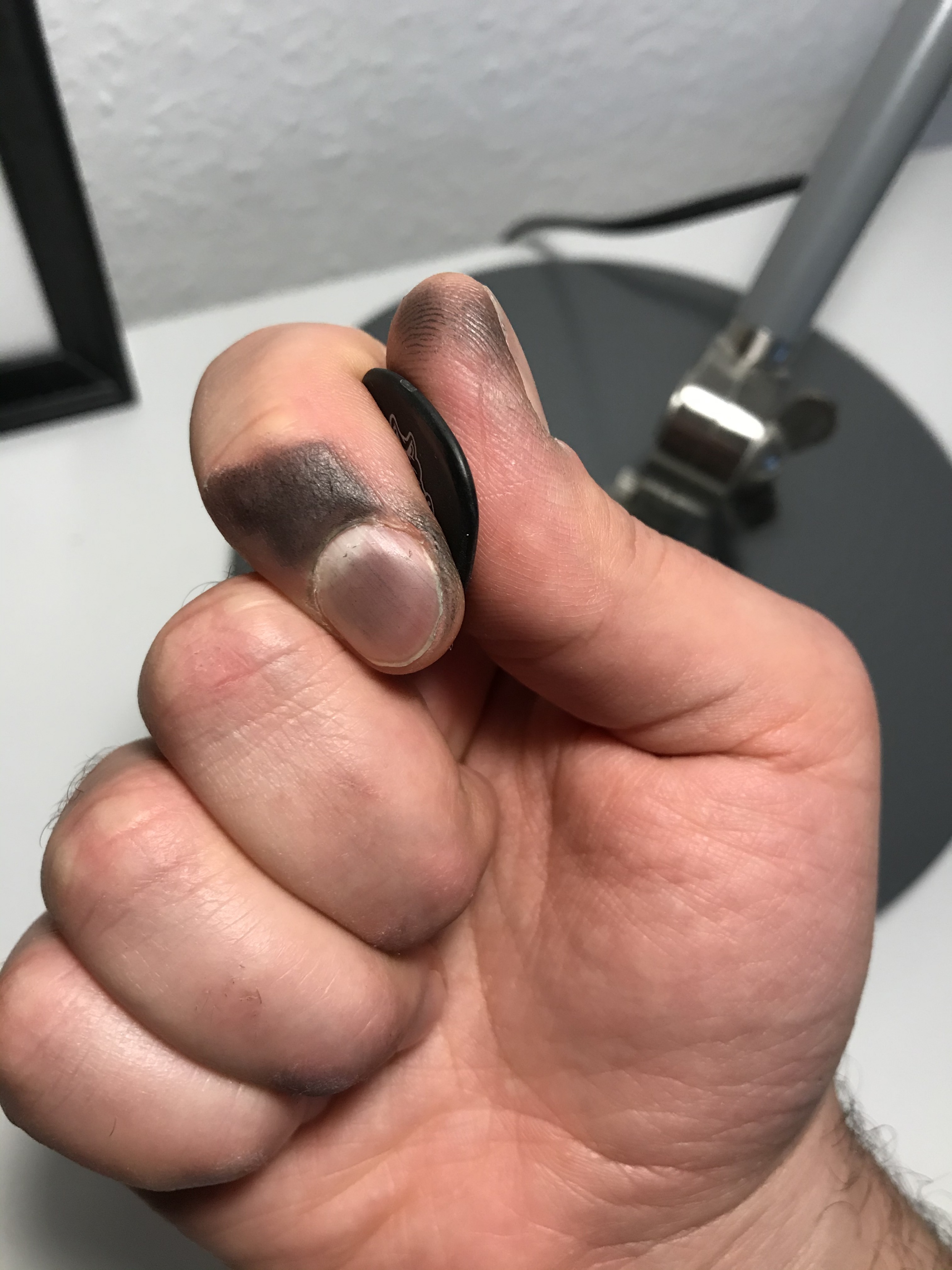

    My position used to vary a lot. It was always between sound hole and bridge but sometimes my hand drifted away and I was hitting against the bridge, producing no sound at all. Except of a "plock" 😂
    @Buco
    What's really neat about their tone is, like if you put their picking into slow motion, I feel you'd see the hand and the pick touching the string [..]
    I'm touching the string with my hand as well, or to be more precisely, with my fingers additionally to the pick. When I use a fresh pack of strings and a new pick, this is what my fingers look like
    All the black parts have contact with one or more strings. 😅
    TwangBillDaCostaWilliamswim
