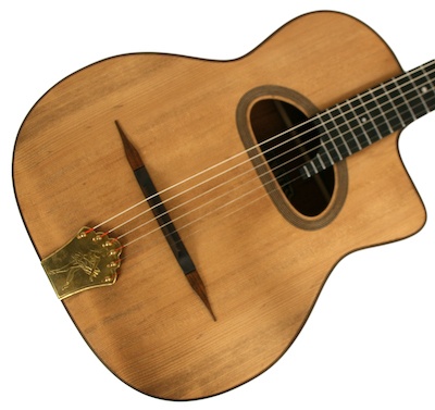

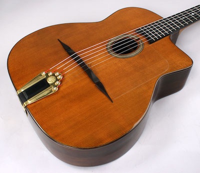

    This is what I'm aiming for (see images). As long as the finish allows the sound to breathe through, I think I'll go with Danish Oil or something similar followed by a final layer of shellac for further protection. French polishing looks a little more advanced for an amateur home project type. Not sure yet how to get the subtle changes shading, though.
  • Posts: 6,163
    I think this is much more of an art form than a standard finish. If you have a painter's hand, try it. You always remove the tint and start over before you get to varnishing. I'd imagine you'd choose a shade of tint and apply to the whole body and then artfully remove some and streak some.
