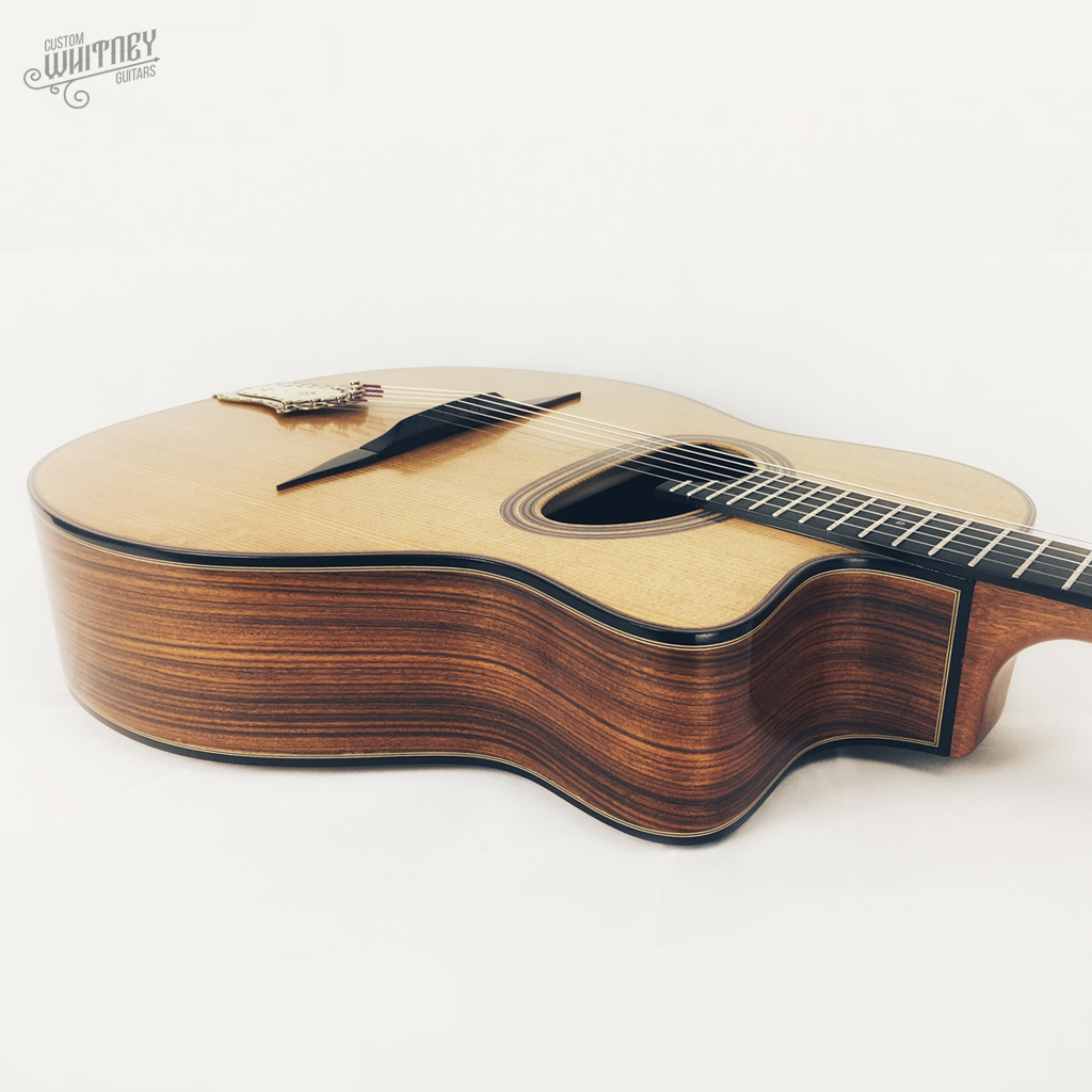

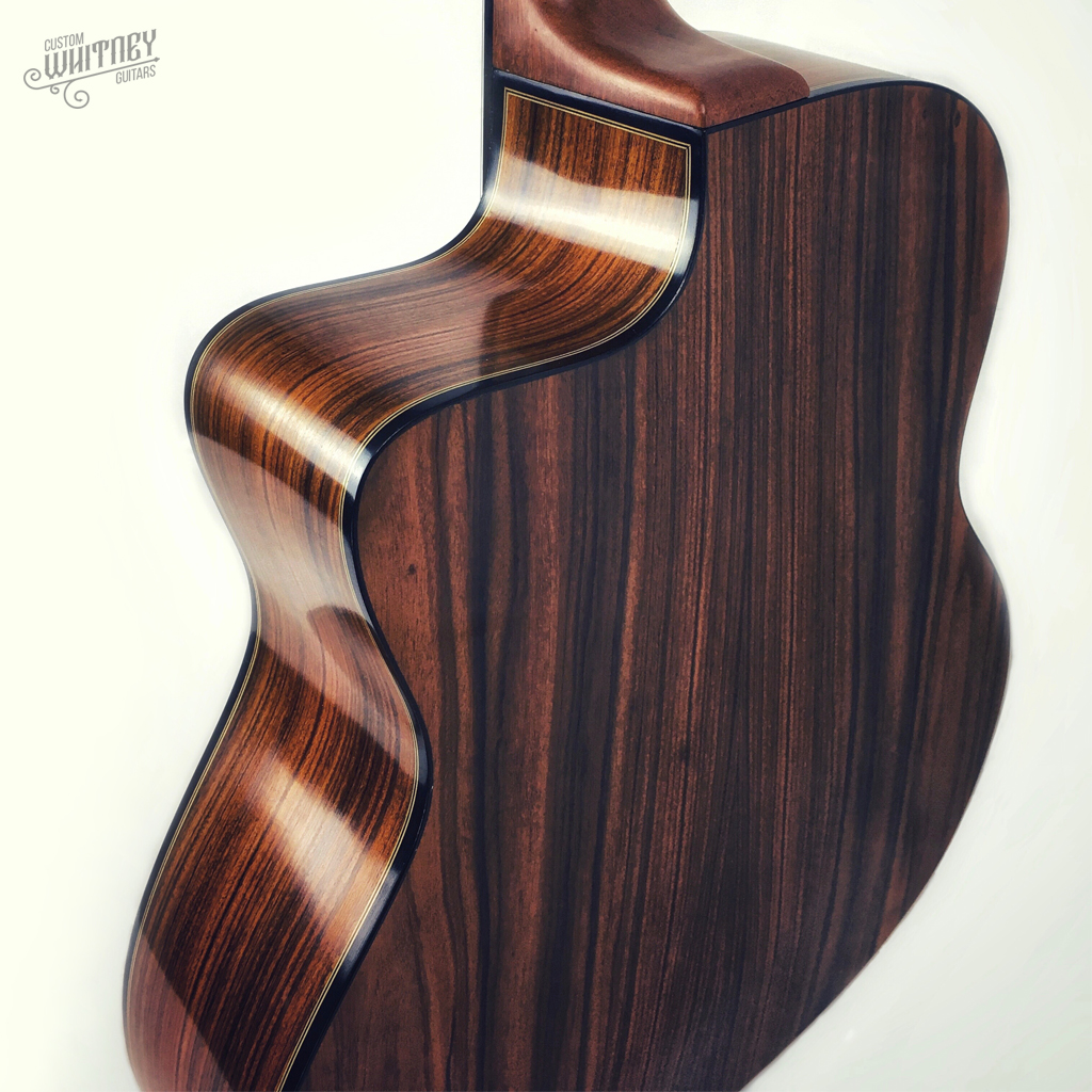

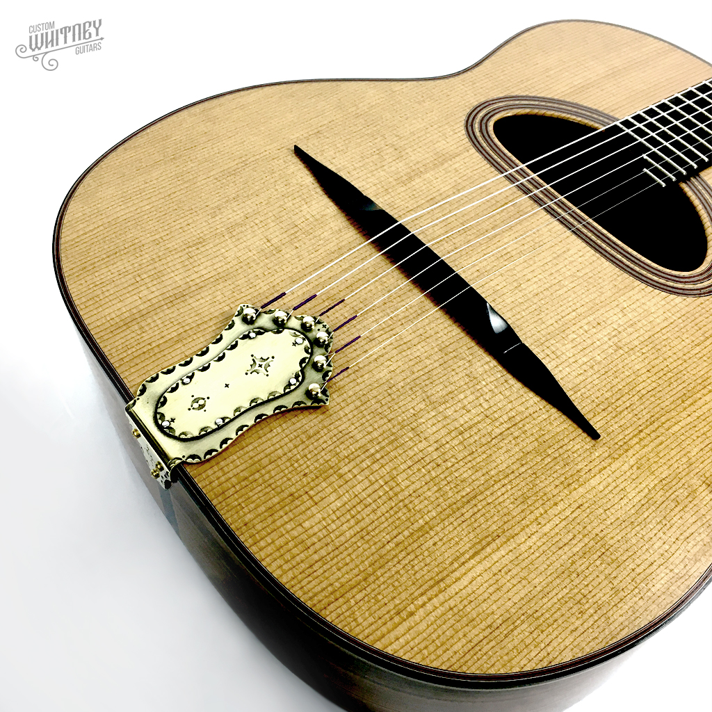

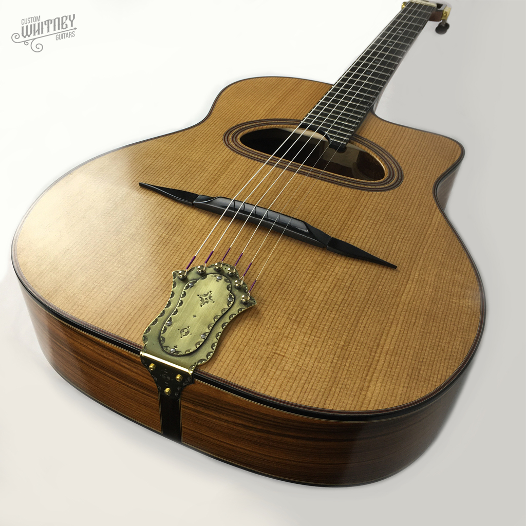

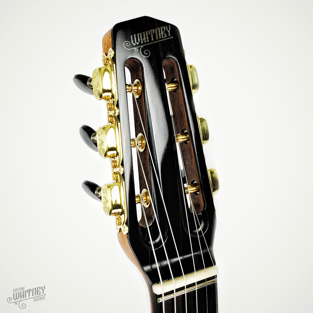

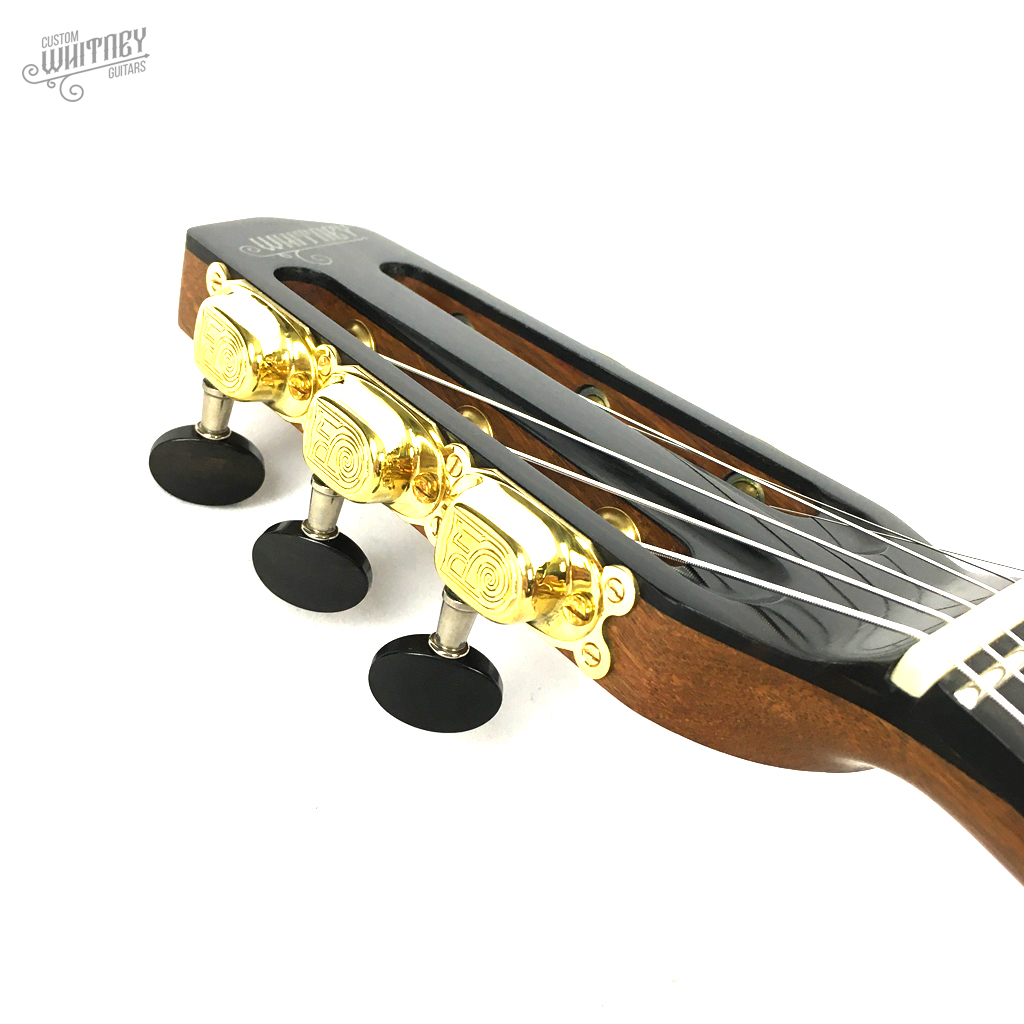

I just wanted to share a commission that's been sent off to Mississauga, Ontario. This one features a 14-fret-to-body connection as well as a longer 670 mm fret scale - a bit of a hybrid of the original Selmer-Maccaferri designs.
A few other details:

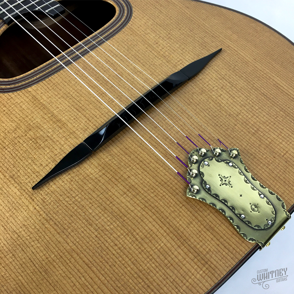

  • Custom Tailpiece by Montreal Artisan
  • Miller Swiss Selmer replica tuners
  • Santos rosewood laminated back / sides
  • Torrefied spruce top w/ traditional pliage
  • French polish finish
Thanks for taking a look and happy playing!

    Love that tailpiece.
    whitneyguitarsBillDaCostaWilliams
  • whitneyguitarswhitneyguitars New Gitane DG-340 Modele Stephane Wrembel Model
    Posts: 22
    Cheers, Bones.

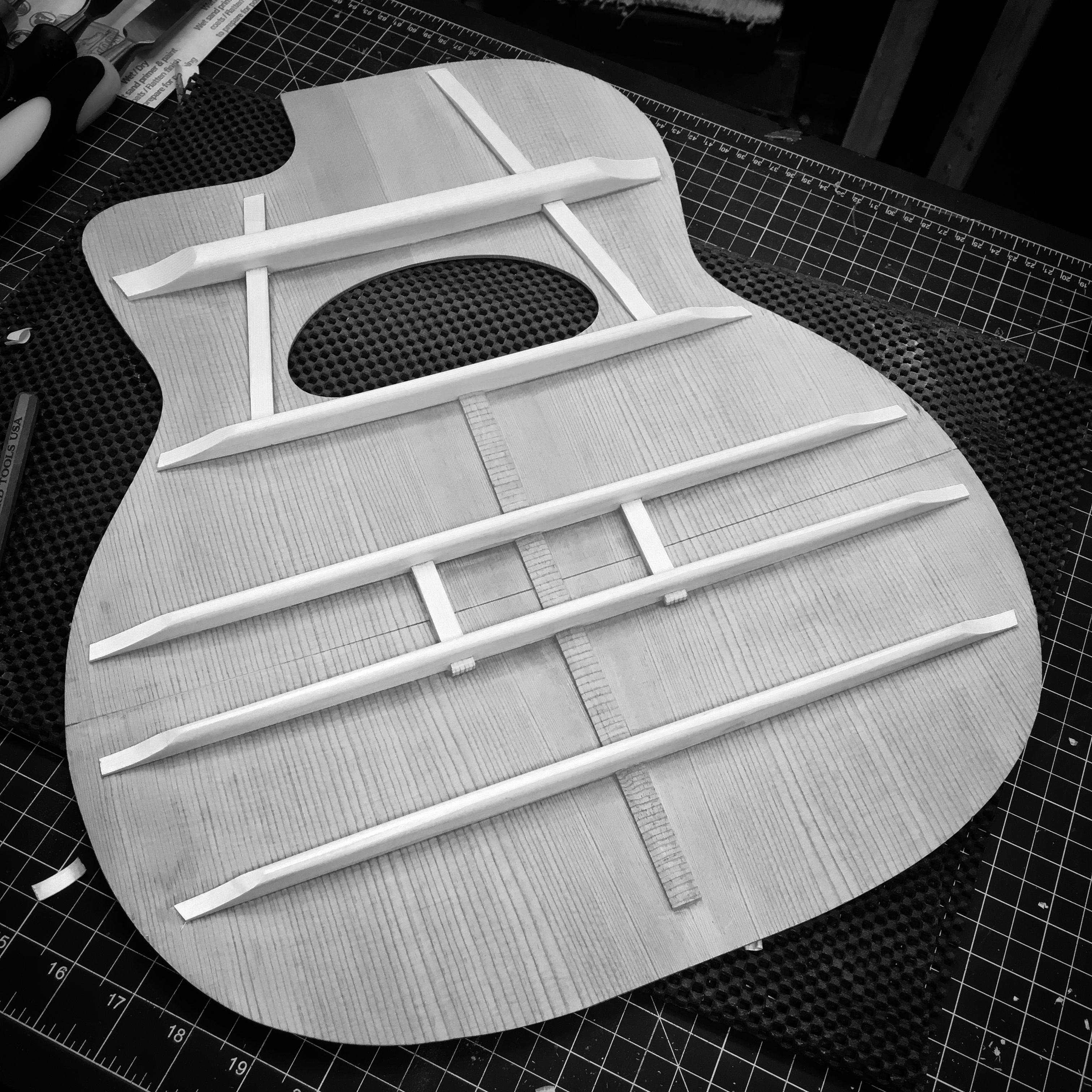

    Care to share a pic of the top-bracing scheme with final shaping, brace heights and top thicknesses? (Totally no prob if not/secret sauce, understood)
    Asking because I’m in the middle of an oval/14th fret build right row.
    Posts: 22
    Hey Gouch - I don't mind sharing. Attached is a photo during the build process before final shaping / sanding and voicing. Brace dimensions are pretty true-to-form from the François Charle plans - no huge deviations in this respect. Have fun with your build!
    Posts: 162
    Thanks- looks great!
    whitneyguitars
    Posts: 22
    Thanks Gouch! Looking forward to seeing your build progress.

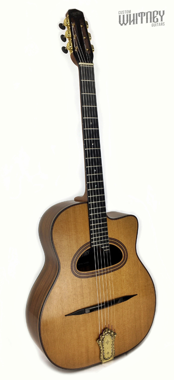

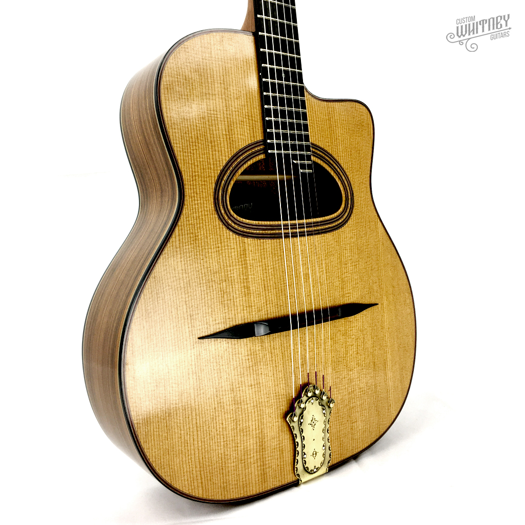

  • Posts: 6,157
    What a great looking guitar. The grain on the top is so unusually distinct. Is that because of a photograph or that particular piece of wood or the torrefied wood process or...? Even the unfinished wood from underside looks spectacular. Would love to hear a sound clip.
    edited February 2022 Posts: 22
    Thanks a ton, Buco - really appreciate the kind words.
    The photos are pretty true to form. The 'toastiness' of the top is definitely due, in large part, to the torrefication of the spruce top. I used a blonde shellac for the soundboard, neck and head (a very light colour) and a garnet shellac for the back and sides that has a 'ruby' -like colour that really enhances the red/brown tones.
    I also 'size' the soundboard with eggwhite before French polishing giving a subtle antiquing effect, which I believe comes from the proteins in the eggwhite reacting with the tannins in the wood. Finishing aside, most is inherent to the wood itself. As a sidenote, the smell of the torrefied spruce is incredible... kind of a toasty, caramel woodiness with undertones of current and spice (I kid on the last part).
