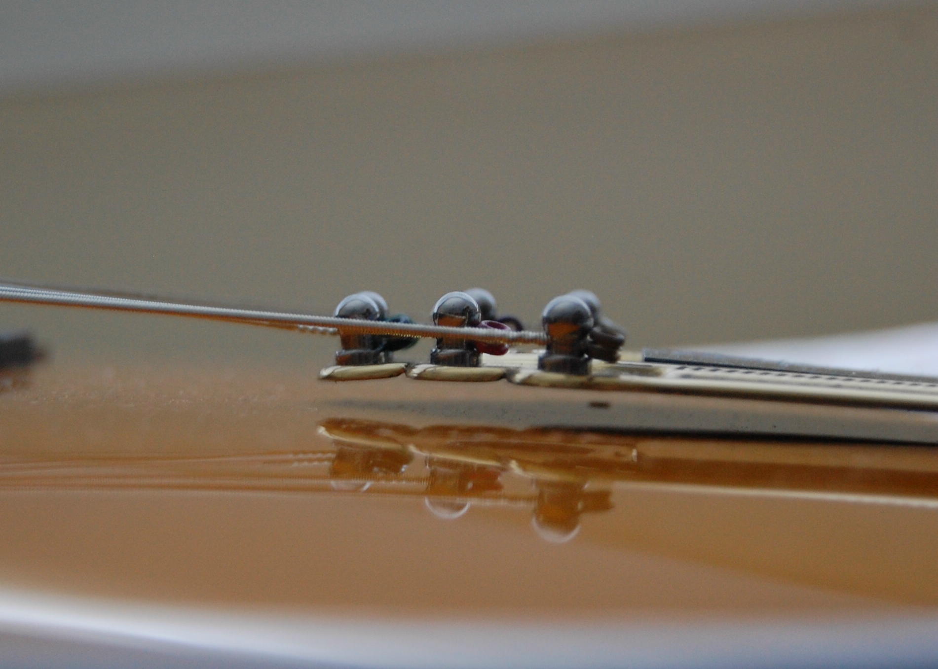

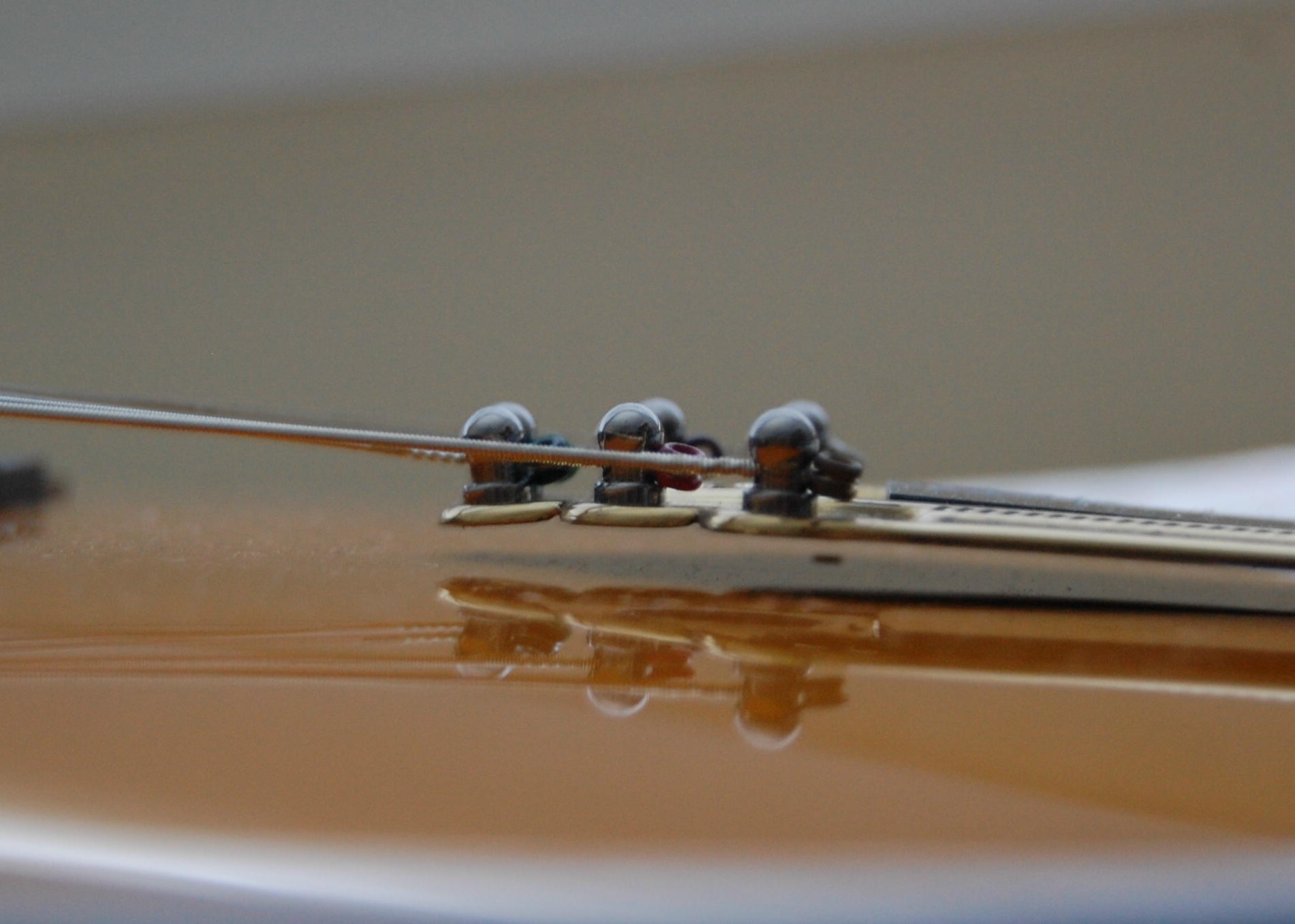

    Apart from the humidity and raised top theories there may be a simpler explanation.
    I attach a photo of how my Gitane copy does the same thing. Anyone who has worked on sheet metal would recognise the relative strengths and weaknesses of a plain stamped piece with and without swaging or stamped details. The standard design of these Selmer copy tailpieces has the wooden insert adding strength along the lower two-thirds where the wood is slotted and grips a straight flange. Then usually there is a stamped logo, in this case the stylised 'S' in a circle, between the string posts, this adds some extra strength to the brass(?) in that area.
    But looking closely at mine, the middle two string posts are mounted in what is obviously the weakest area; narrow in section and without and reinforcing folds, such that the string tension pulling straight from the bridge has the effect of pulling the posts forward, thereby bending the tip of the tailpiece down.
    If you look closely at the photo you can see how the ball ends of the D and G strings are exactly in line with the others although where the string exits the posts it appears to be nearer the body of the guitar. This shows how the string tension has pulled the posts toward the bridge.
    So, depending on the relative strength of the material used, any stamped detail in that area, combined with string tension which will vary according to gauge, scale length and angle, could all easily cause this to happen.
    Looking at my other guitars which all have different tailpieces I can say none of them suffer with this so it may be a problem with the Selmer design. Finding one that is made stiff enough to not bend will be trial and error. Next change of strings I plan to swap that one for a nickel Favino style one I have lying around; the swap solely for the purpose of matching the nickel Schaller Deluxe tuners and even if that one does not bend I could not remember where it came from.
    So there is something to be said for the old standby hinged 'Trapeze' tailpiece after all.
