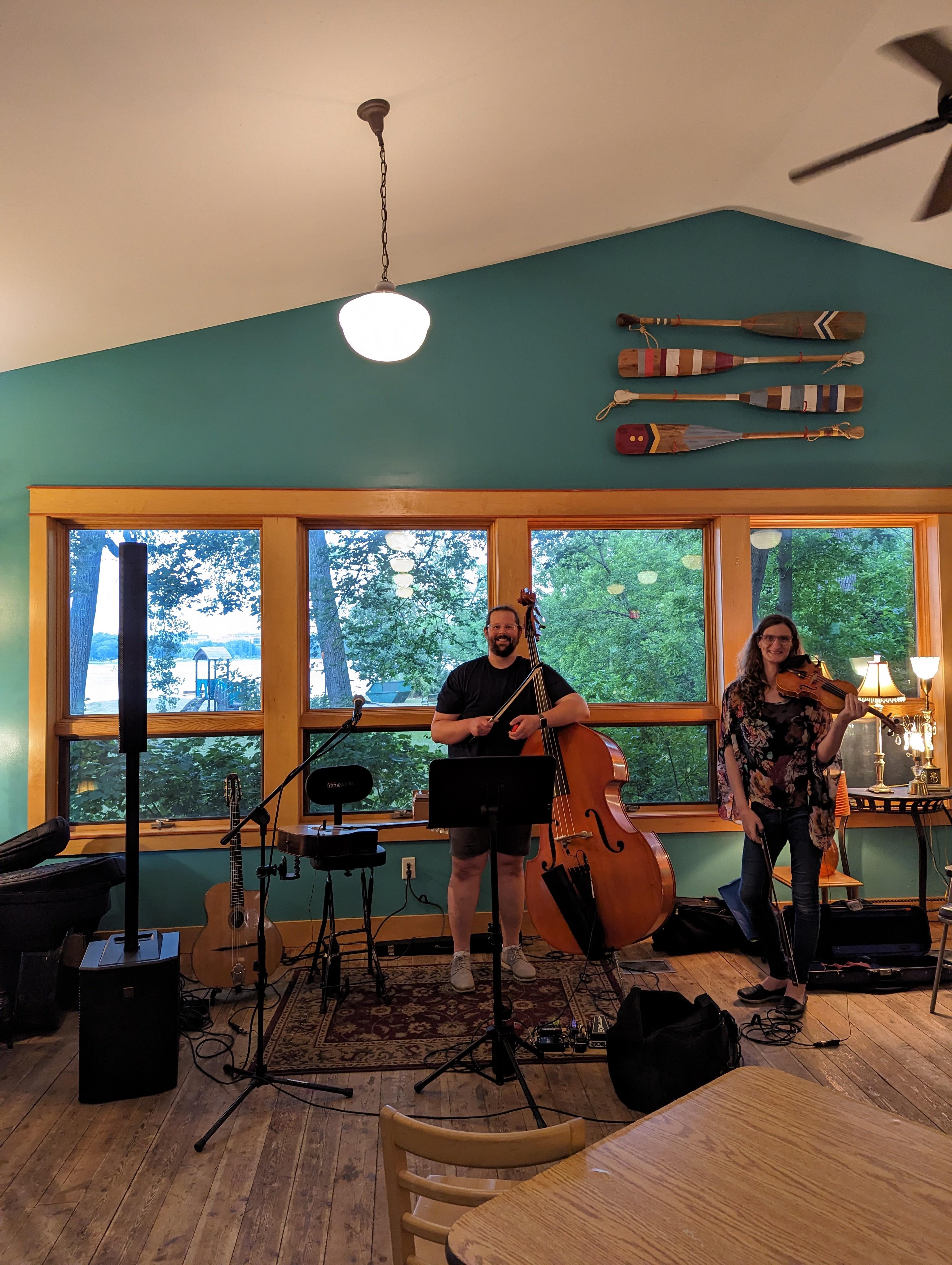

    Sounds good! But i can't see it on the video, did you place it in front of you?

    It is to the right of me. The video was capture with my phone using a Shure mic.
    Here is the set up

    Do you ever miss having monitors or is the dispersion good enought to hear it onstage? We have a nice setup with powered mains, mixer etc but only really bust it out for nicer gigs. Seems like you could use the EV 50 for almost all gigs and get a more acoustic sound. As long as the DPA's don't feed back too bad in a smaller bar setting.
    Posts: 512
    The dispersion is good enough that you can hear it on stage.
    It resists feedback pretty well. As you can see, I am right next to it with the DPA.
    With the 50M, you can leave the powered mains and mixer at home and just bring the unit and an iPad/smartphone.
