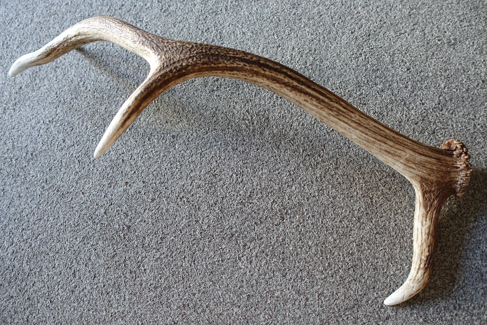

Thanks for the bridge thoughts. I've made quite a few now, including one from the antler. Haven't had time to test any of them yet, but hopefully this week I will.

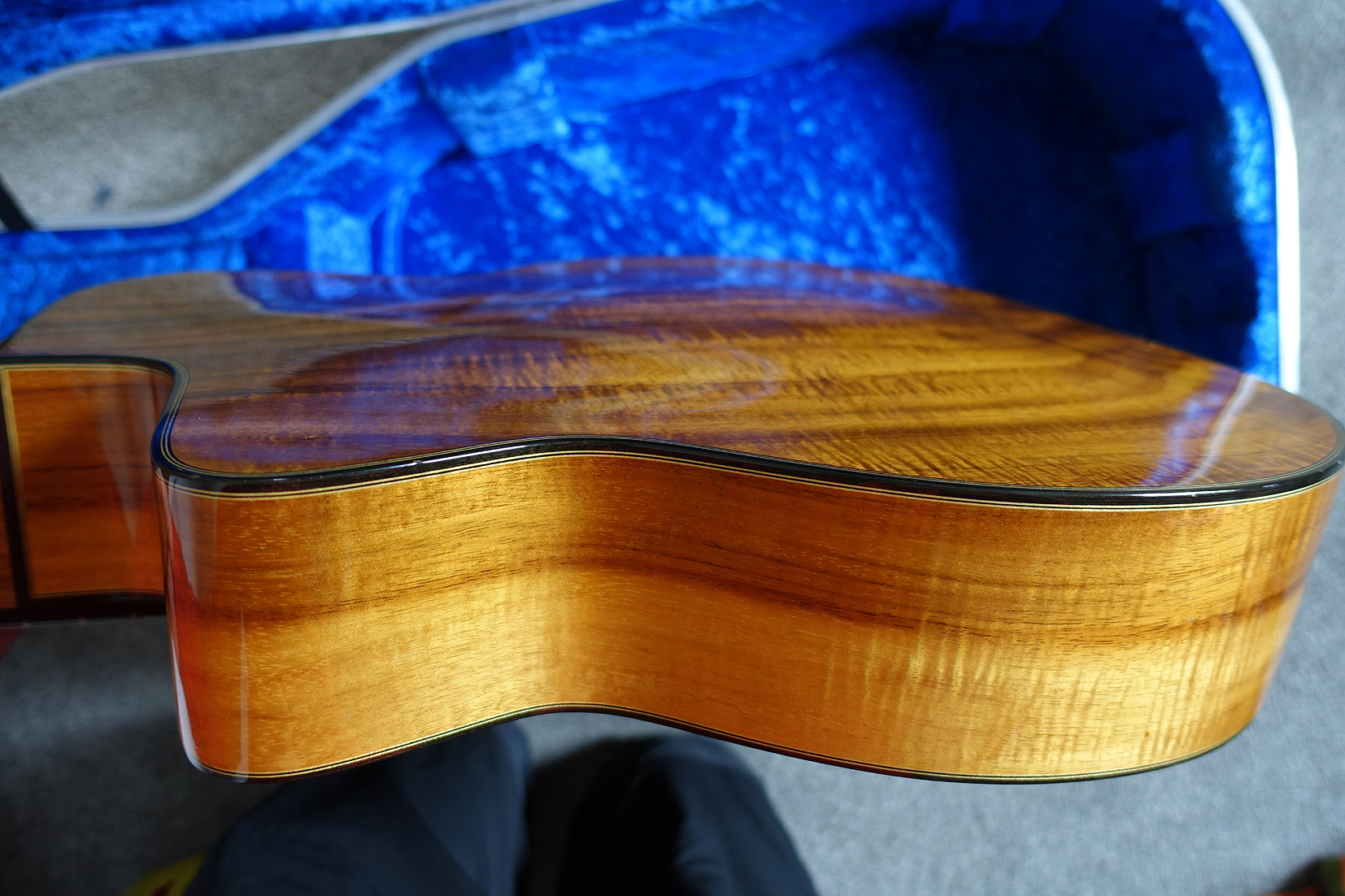

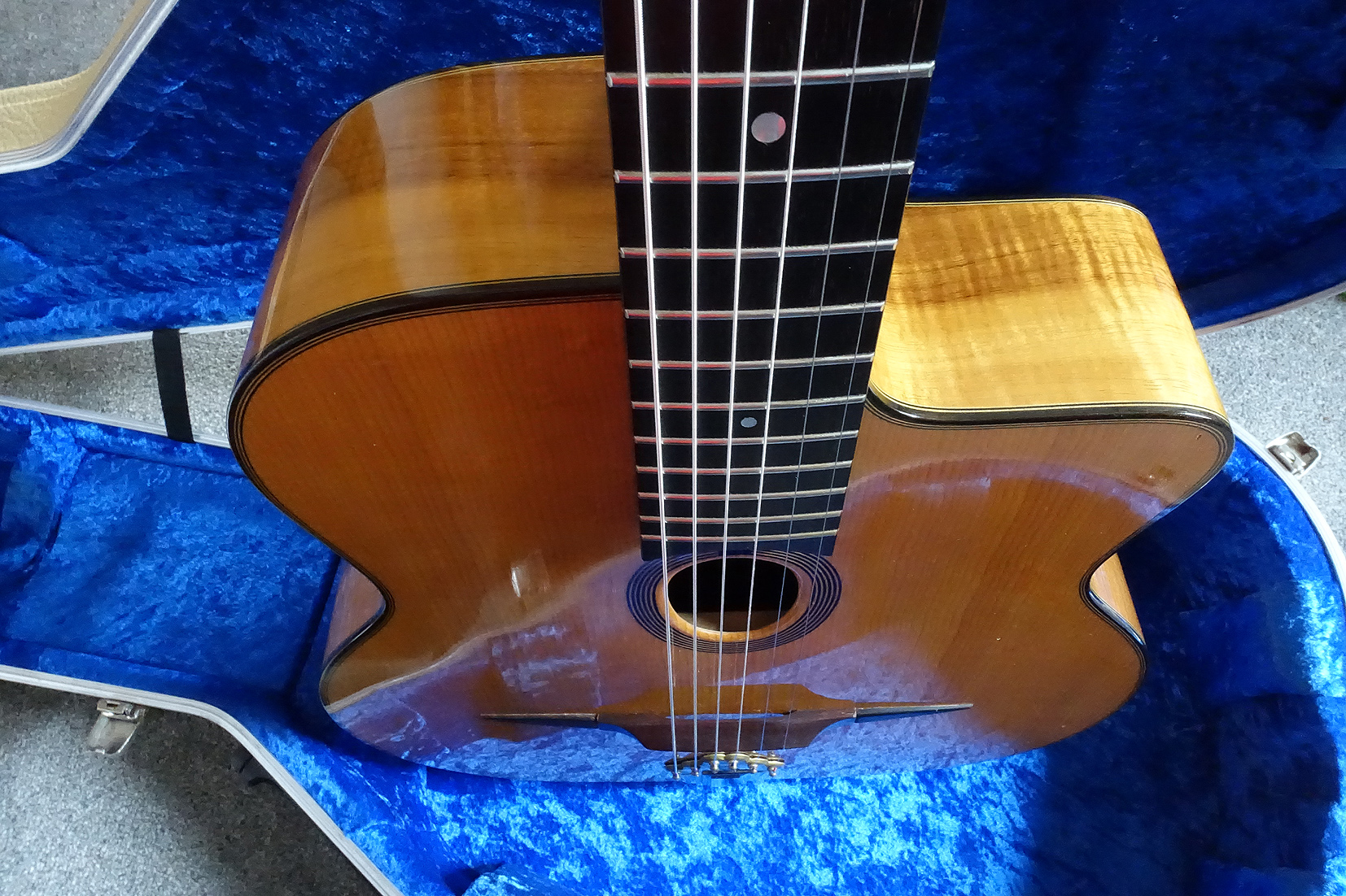

The Dupont is coming to life. I'm guessing it wasn't played for a few years (the original owner had died), and possibly not much full stop (no fret wear at all). When I bought it, the seller (the owner's nephew) had had it cleaned and set up by a guitar shop who put huge chunky steel strings on, and it sounded dreadful (of course). It's just taken a few weeks for it to come alive. It's now becoming the great guitar I was hoping it would be. I took a massive risk buying it, but as time goes by, I think I did well. It was £1750 - by far the most I've spent on a guitar, but look at that maple - how could I resist that?!!
Jamie, congrats on that find! I think you were the right person for that guitar. At that price, and with your knowledge over your past projects, even if there was something wrong you probably have the skills to make it right. I think you might be right that it wasn't played much. Doesn't sound like the seller was trying to cheat anyone. If they are getting it cleaned and set up before selling at an estate sale, that to me seems like they are good folks, just don't know what to do.

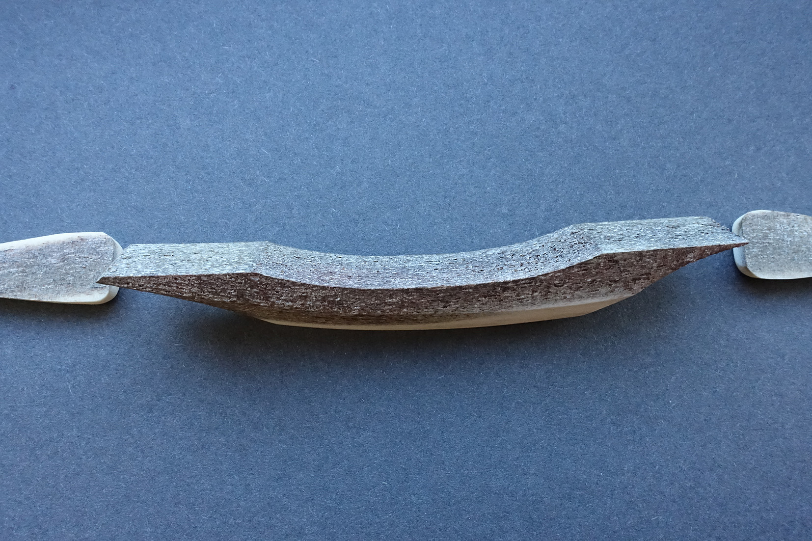

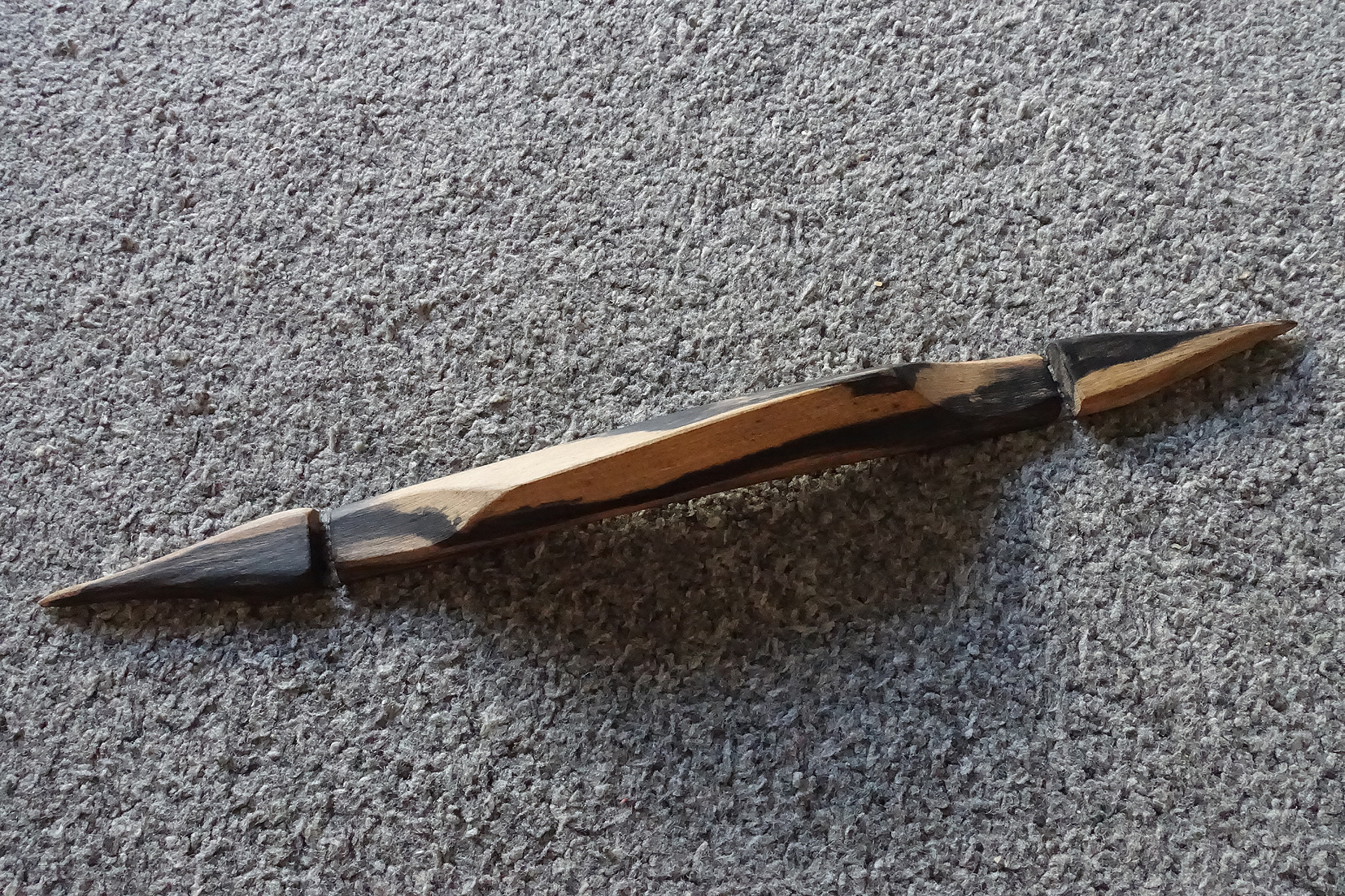

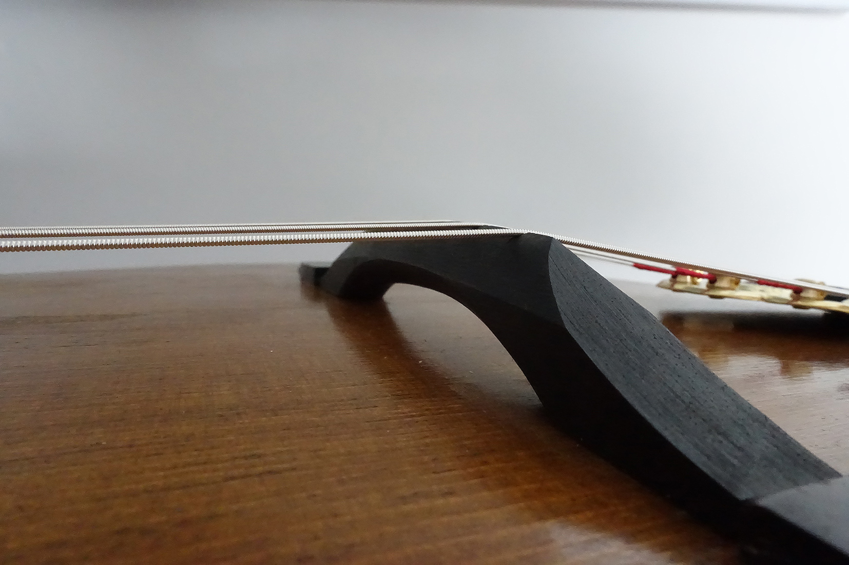

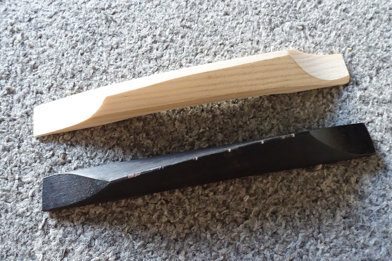

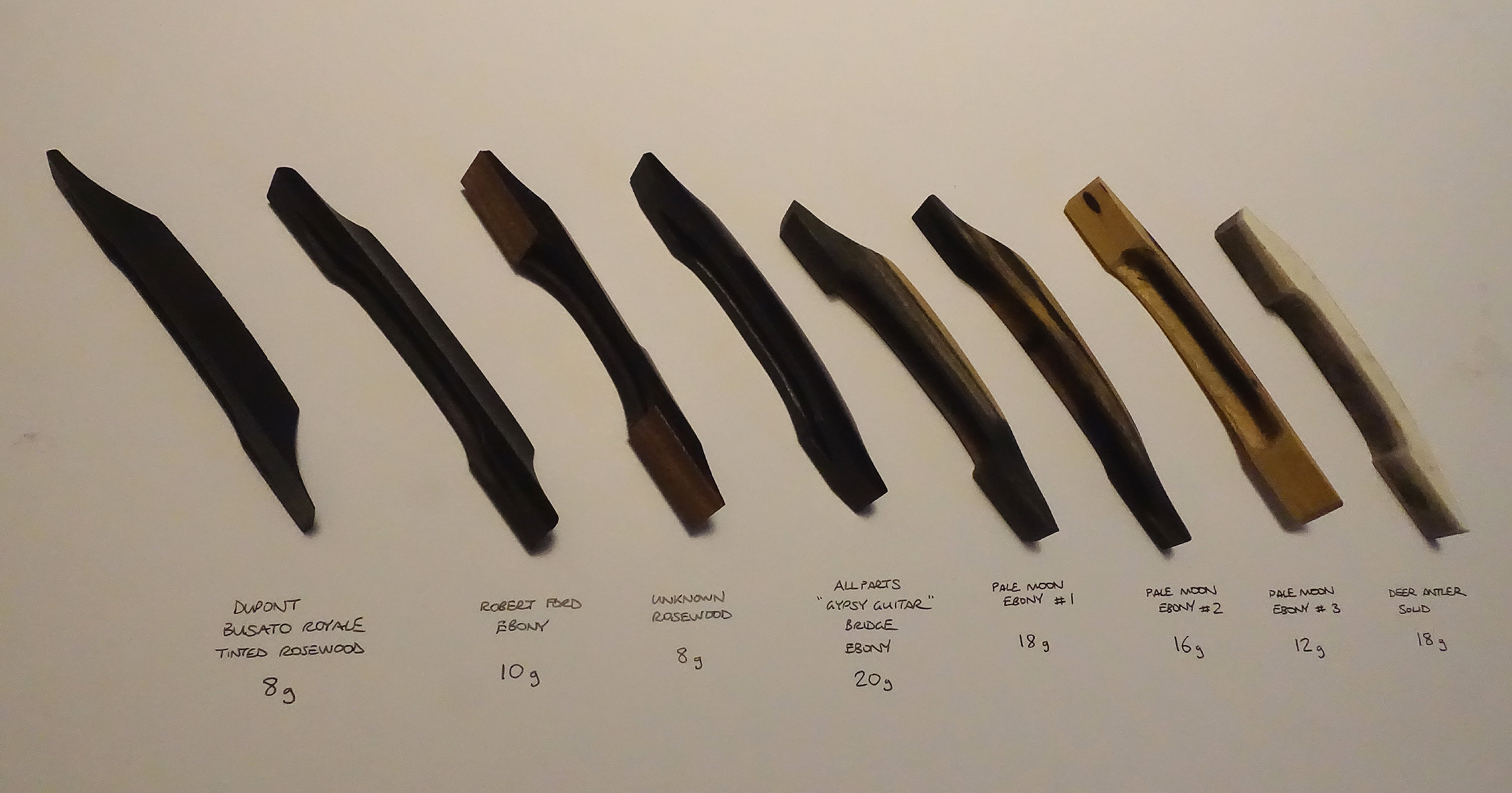

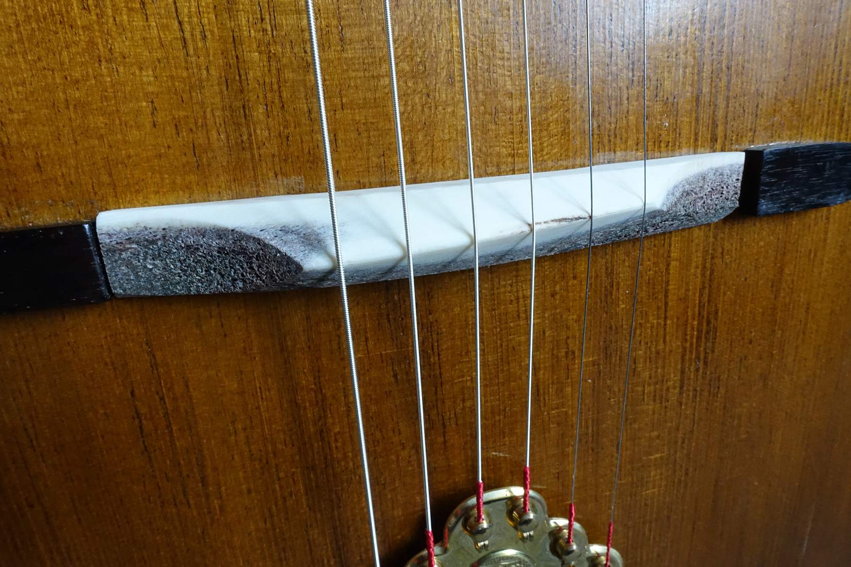

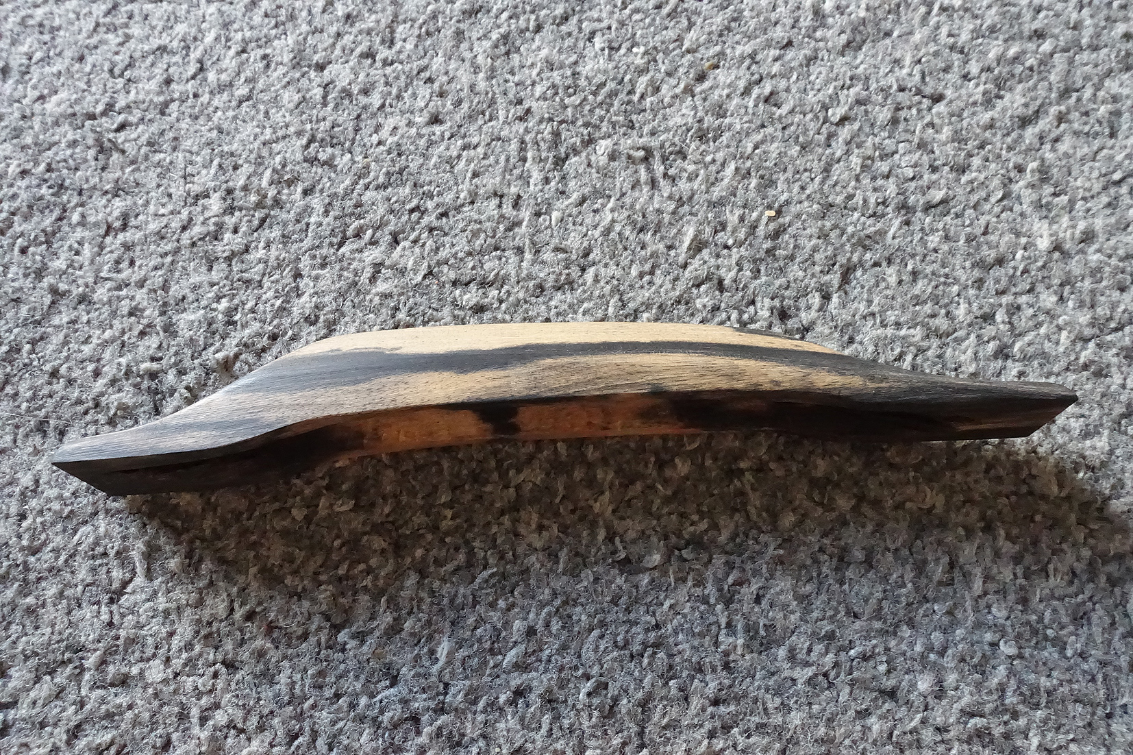

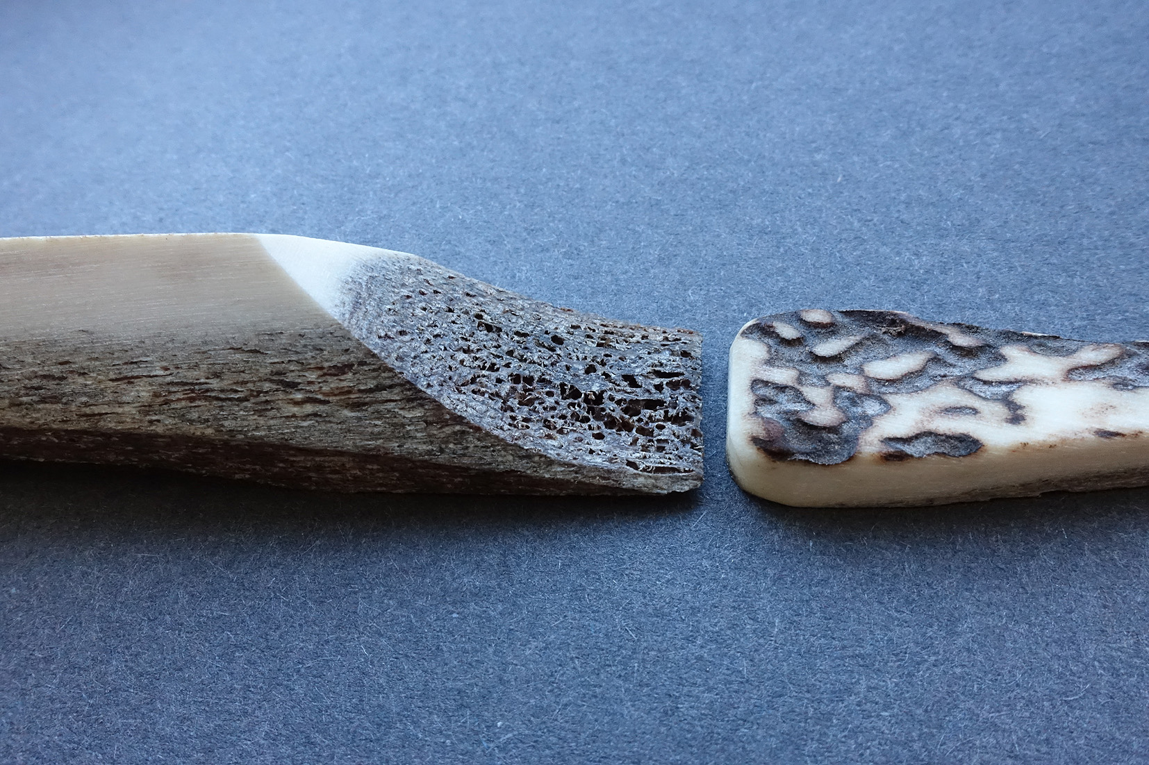

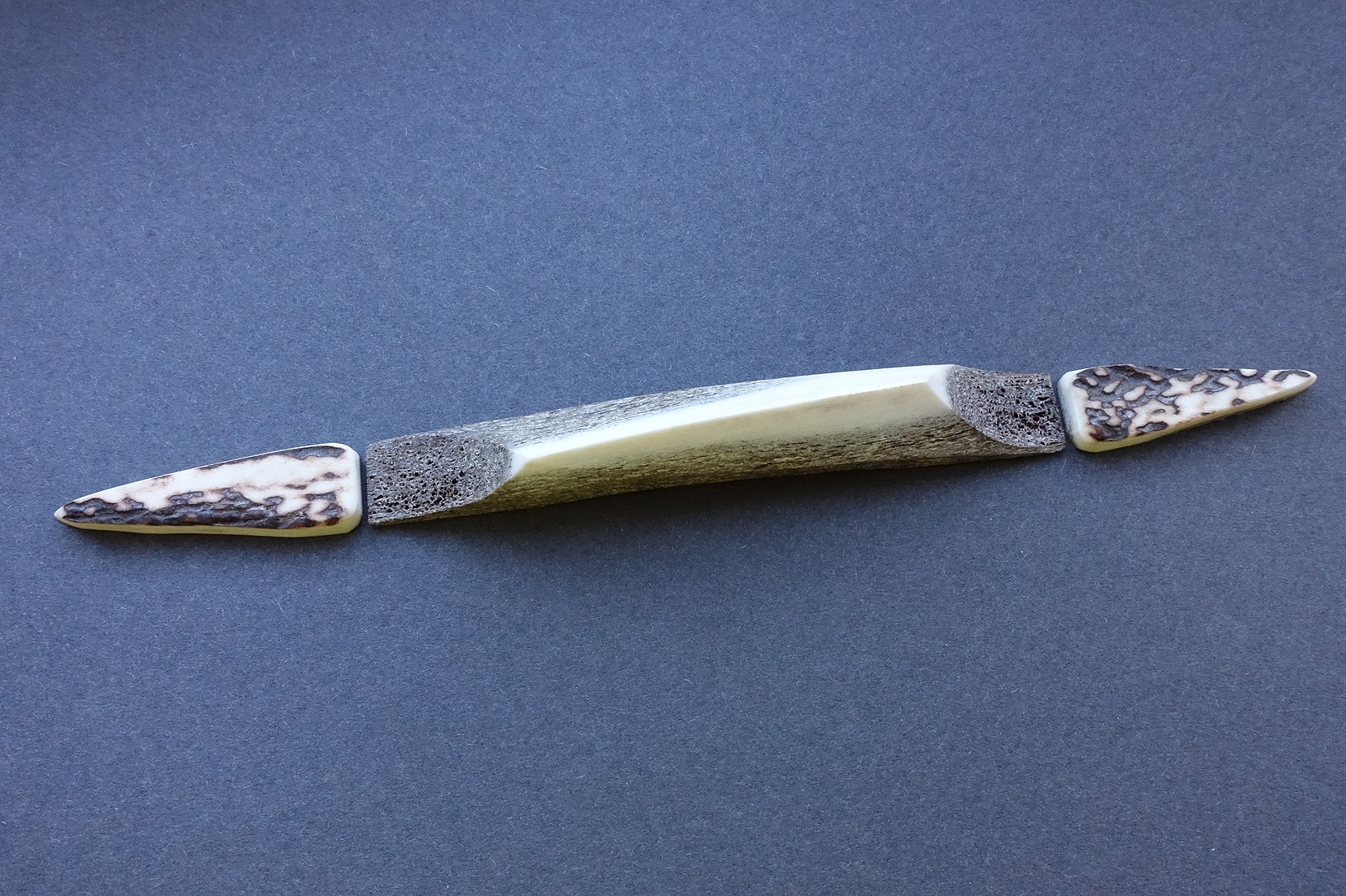

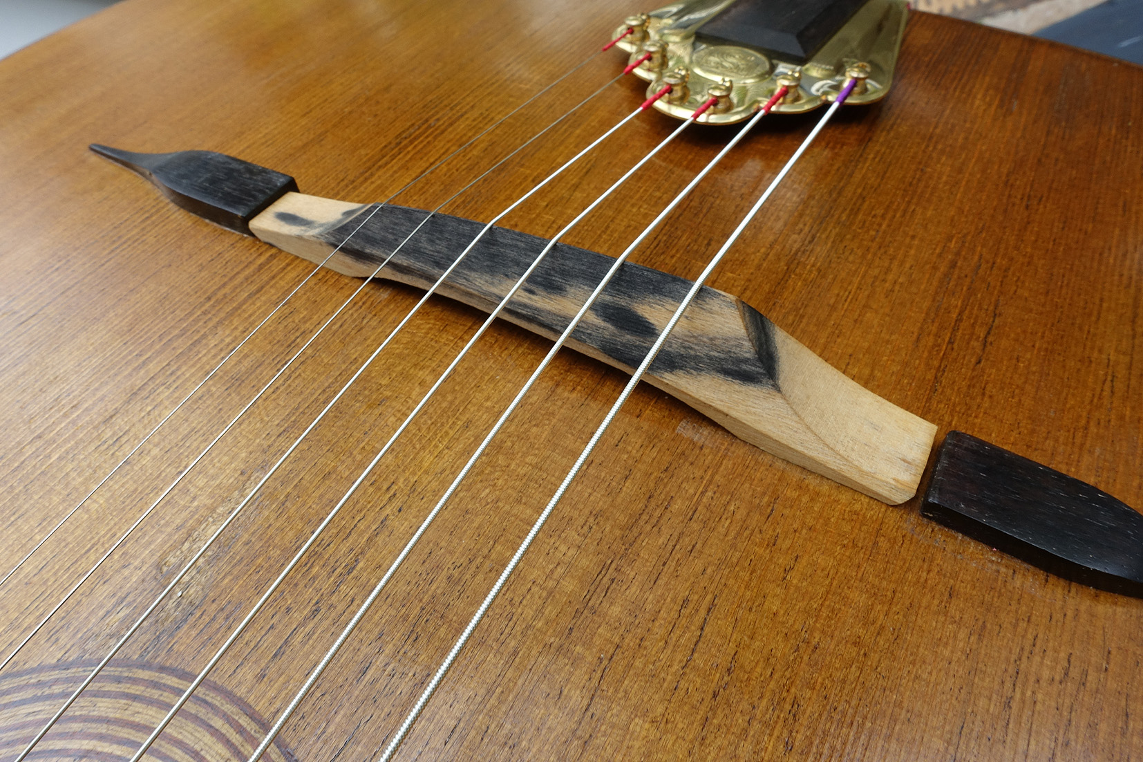

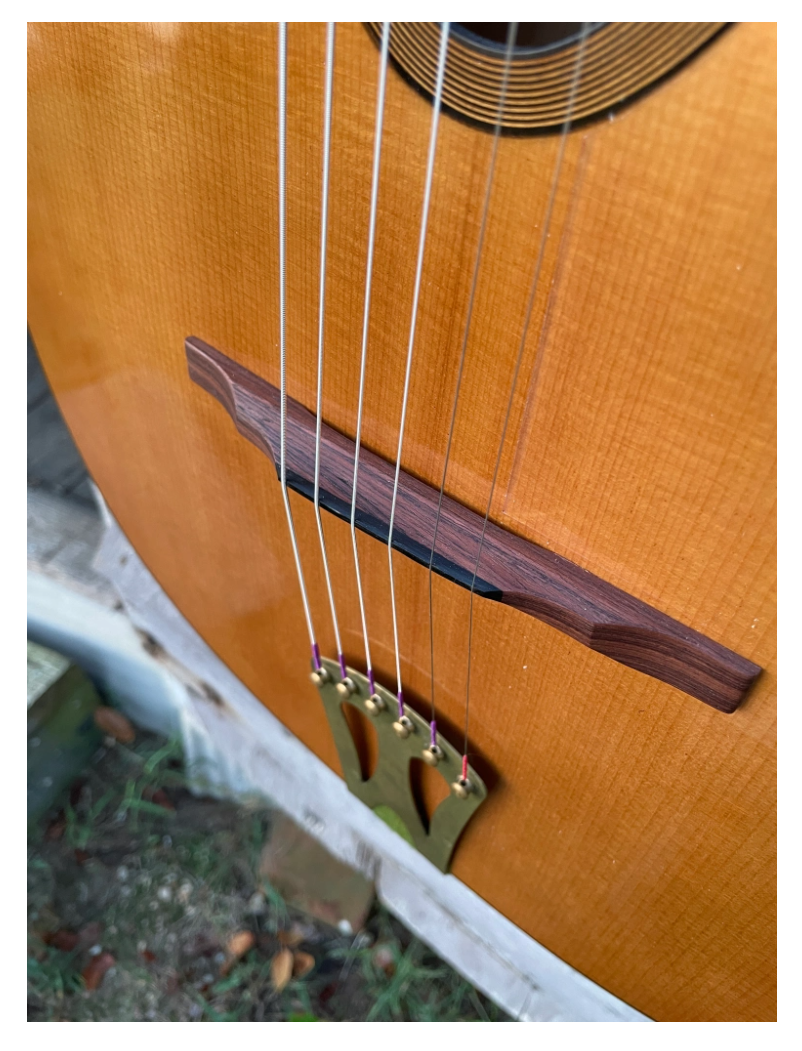

Here are some pics of the bridges. Since taking the group shot with the weights, I've made another lighter antler bridge at only 12 grams. I've tested it, plus the lightest pale moon ebony bridge (12g) and a pine bridge with an ebony top (10g). The test guitar is my recently refinished Gallato which needed a new bridge anyway. The pine was not good - thin sound all round, slightly banjo. The antler was pretty good - quite a full sound and loud, quite trebly. The best of the three was the ebony which is staying on - as loud as the antler, but with a more refined, sweeter tone and strong trebles and mids. The antler could be good for a guitar that is a little on the dull side. It'll go on a guitar for sure - as much a statement and talking point as anything!

The antler bridge is incredible! I've used one for a mandolin but never considered one for guitar?
It would be great to hear sound samples for comparison.
