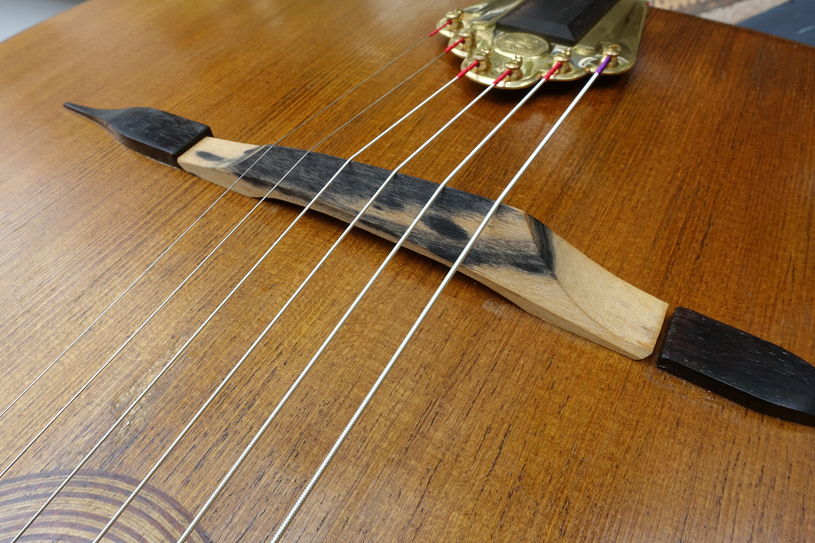

    Here are some pics of the bridges. Since taking the group shot with the weights, I've made another lighter antler bridge at only 12 grams. I've tested it, plus the lightest pale moon ebony bridge (12g) and a pine bridge with an ebony top (10g). The test guitar is my recently refinished Gallato which needed a new bridge anyway. The pine was not good - thin sound all round, slightly banjo. The antler was pretty good - quite a full sound and loud, quite trebly. The best of the three was the ebony which is staying on - as loud as the antler, but with a more refined, sweeter tone and strong trebles and mids. The antler could be good for a guitar that is a little on the dull side. It'll go on a guitar for sure - as much a statement and talking point as anything!
    Excuse my ignorance on all this - this is the first time I've made bridges!
    littlemarkTwangbillyshakesWillieBuco

    The antler bridge is incredible! I've used one for a mandolin but never considered one for guitar?
    It would be great to hear sound samples for comparison.
