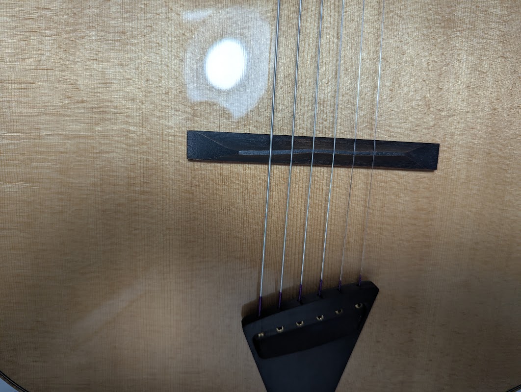

    Multi Scale doesn't have any effect on intonation. The issue is that each string gauge needs a slightly different string length to intonate properly. But multiscale just gives you a different string length for each string. The intonation comes from the bridge being adjusted. Hard to explain but basically if you made a straight saddle for a multiscale guitar, it would be just as out of tune as a regular scale guitar with a straight saddle.
    My opinion is that unless you have string compensation on every string, you won't get the intonation as close as it can be. Most gypsy bridges that I see aren't intonated and it's pretty hard to intonate one because it ends up being a pretty irregular shape.
    What I did for my bridge was take a straight saddle bridge and move it backwards and forwards for each string until it was properly intonated, and then mark that length. Then I used my CAD modeler to model the bridge top line and then connect it. They look pretty weird.
    I think they intonate very well. It is absolutely true that all guitars are out of tune, and things I've experimented with, like compensated nuts on classical guitars take up absurd amounts of my time and ultimately you lose the perfect intonation 5 minutes after because the strings also stretch and stuff. But also getting stuff as dialed in as possible helps...if you start from approaching perfect, it's going to take longer for it to go out.
    Anyway, for me I try to keep the fingerboard as flat as possible, the action relatively low and then I have my funky bridge and that's as good as I can do. The higher your strings are, the more they are going to stretch weirdly in the higher positions. So keeping your action moderate will help.
    I don't really believe in tempered tuning btw. If your strings are tuned to equal temperament and your fretting system is equally tempered, your guitar should be in tune. I think tempered tunings are usually to compensate for a guitar with some problems, usually with the nut. Selmers are definitely at an advantage here with the zero fret which is a great thing.
    Pulling this all out of my a33, quite possibly wrong. It's a pretty wishy washy issue to discuss. And for the record I'm not selling the bridges separately at this point. Maybe sometime. But they'd have to be fit to each guitar. And the compensation could be different for each instrument.

    For your guitar though, I would intonate the high and low E strings so that the open string and the 12th fret are in tune. This might put your bridge out of alignment with the moustaches. Then I would take a razor blade and make a tiny scratch on the tailpiece side of the bridge on the bass and treble side (as long as you like your bridge and are going to keep it). That way if you take your strings off the guitar you can put it back there. But you want to be DAMN sure it's in the right place.
    If you wanted to you could fiddle with the bridge so that each string was equally out of tune but if the bridge is a straight saddle, something is always going to be out so it's just the high and low. It is also good to keep in mind that 99.999% of the music we all love was done on guitars that were somewhat "out".
