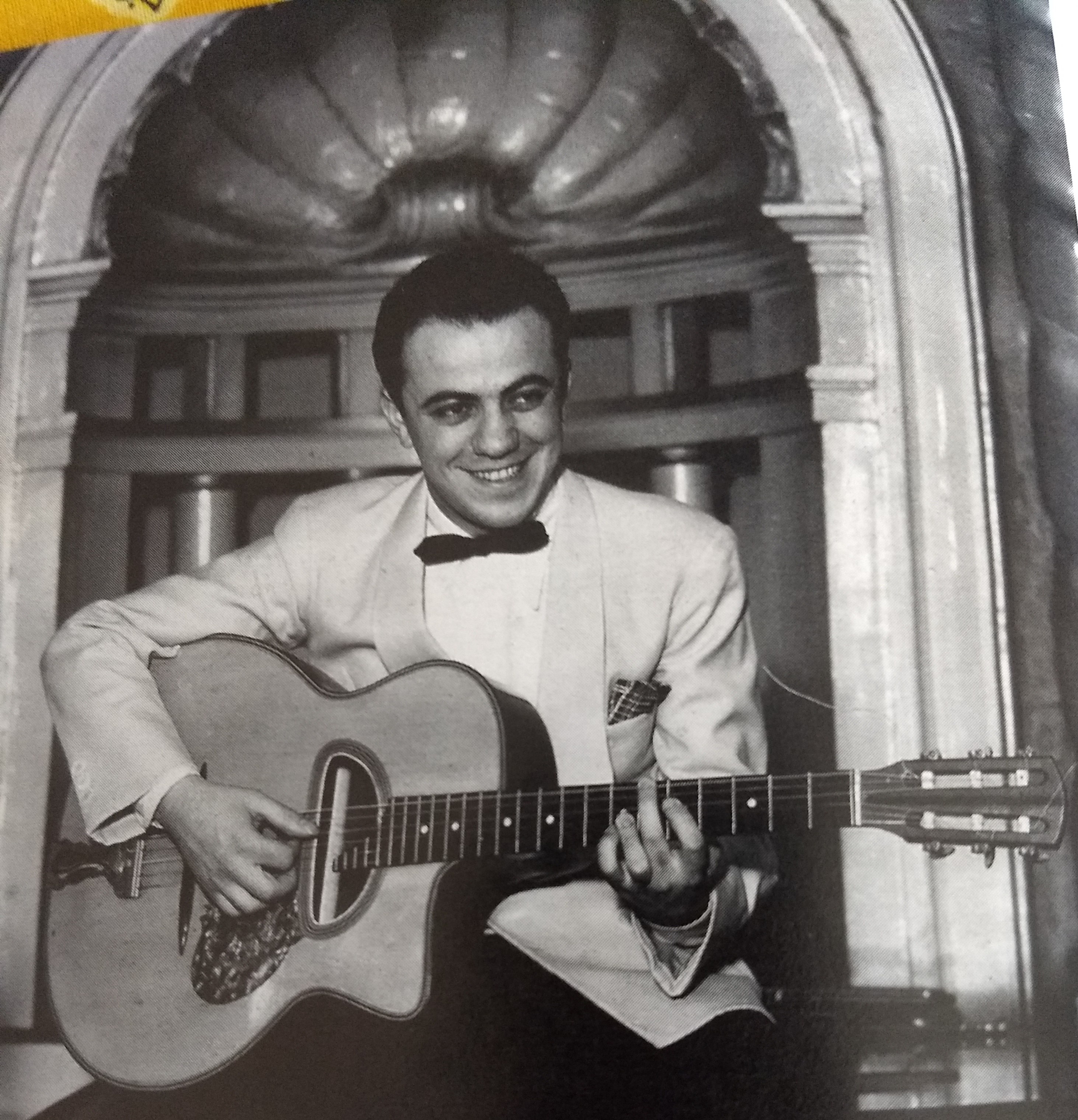

    The tailpiece on the one Marcel Bianchi is holding is reminiscent of ones that Carbonell used:

    The black guitar with the white pickguard was the famous Carbonell that Marcel Bianchi brought with him from Marseille when he came to Paris in 1937. In an interview in 1996, he said that the Carbonell was a fine instrument that Django really liked and used it on some recordings. He also said that the quintet was contractually obliged to use Selmer guitars and he was given three of them which he did not like and sold. The black guitar was ultimately stolen and never seen again. I think the photo in Charle was mis-captioned as that guitar doesn't look anything like a Carbonell - no two of them appear to be exactly alike but none of them looked like that guitar.

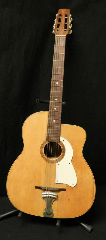

    One other observation, the tailpieces Michael identifies as being similar to the Bianchi guitar and the Carbonells looks very like the ones that were common to a lot of Italian made guitars. These copies of the shape of National resophonics turn up regularly but I had thought they must have been stamped out in their thousands in an Italian factory although available to some luthiers in France too as an alternative supply to Delaruelle.......anyone know more about them?

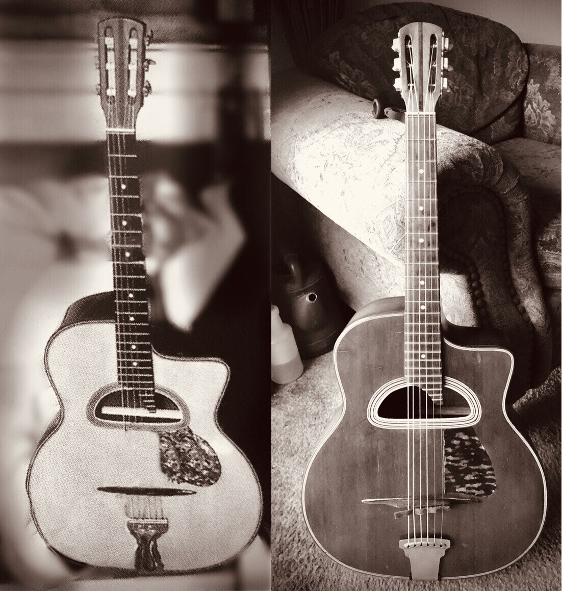

    Bianchi guitar on the left and my mystery on the right. I edited out Bianchi’s arm and fingers for the full effect of the guitar body. My apologies to the Bianchi family.
    I should make this a “Wanted” poster.
    mac63000MichaelHorowitzJSantaBillDaCostaWilliamswimAndyW
    edited March 2020 Posts: 1,038
    Well that is as close as you will get to a match. Because of the slightly different angles and that yours is a darker shade it is not possible to be 100% sure about whether the body profile is exactly the same.
    So along with my comments above regarding tailpieces and neck construction it could still have been from Carbonell the elder; he was based in Marseilles so back in the 1930s it may have been as easy to get parts supplies from Italy as from Paris? Failing that, my guess would be a one-off by any of the Sicilians, whether based in Paris or Sicily.

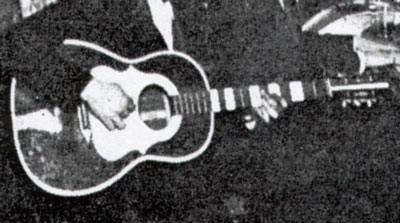

    Here are two pretty good pictures of Marcel Bianchi with TWO different guitars obviously from the same maker (also like bopster's guitar), the first erroneously captioned as being from Paris c1939, the second, which was previously posted here, is captioned from the "Kuursal" in Geneva late 1942 or early 1943. The upper guitar has a different tailpiece, pickguard, and bridge, and looks like it has a bound fingerboard and plastic body binding. And most bizarre, that guitar appears to have a volume control, though it might be a floral decoration on the pickguard. I have another photo of Bianchi with this same guitar captioned as being in Geneva '41 or '42 and though the photo isn't as clear, the "volume knob" is clearly visible but a pickup isn't. No cable is visible, but these are obviously posed photos. The guitar in the 2nd photo also appears to have tuners for a classical guitar...
    The plastic bindings make me wonder if the bodies came from Busato and the necks from somewhere else...
    I have two different discographies of Bianchi, neither shows any recordings with Challain Ferret or Marcel Freber (who I never heard of before) so there isn't any real way to say for sure the date of this photo. We do know that the only lefty Selmer was made in 1942, so the caption is incorrect. I think more recordings were made during the war than immediately after, and Bianchi did not record from '46 to '50 and he wasn't in Paris much after 1950. He was in Switzerland during the war, so this photo was probably taken c1946-47, and there were pickups circulating in France by then.
    These must have been pretty good guitars - Bianchi could have had any guitar he wanted, I think. He was an excellent guitarist and you can see his confidence as a musician pretty clearly in the photos.
