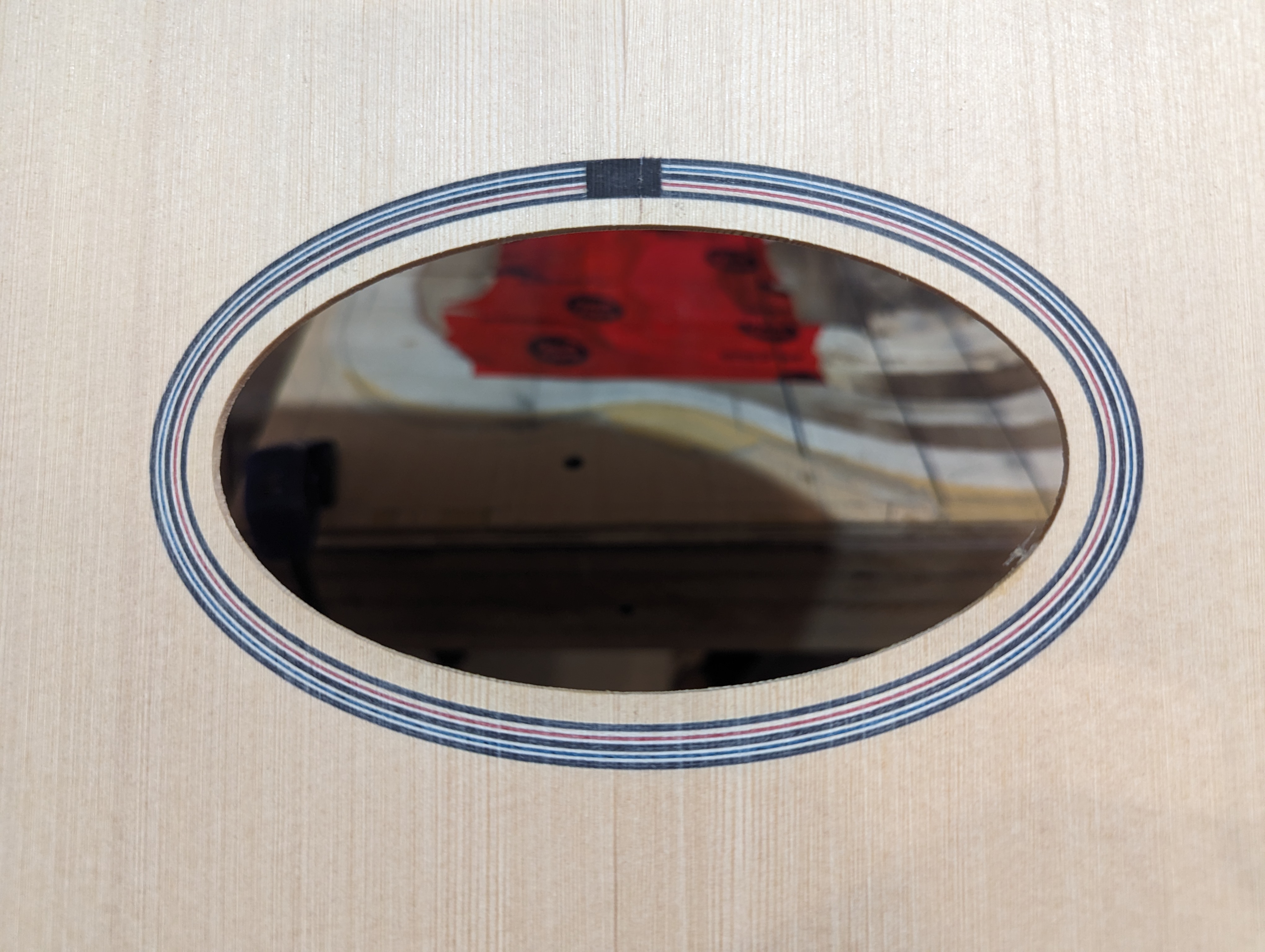

    I'm having trouble adding pictures here but I did my first real petite bouche rosette ever. It's a prickly little job. Not as bad as I thought it would be but still not easy. It came out pretty good. The next one will be better. I used up $40 worth of purfling strips on one top. I need to find a cheaper source for that. Someone suggest Gorilla Glue Non foaming clear for this and it seems to work great. Anyway pictures are here:

    This batch has my first real Selmer style rosettes. It was pretty intimidating and I really sweated it but once I figured it out it's not too bad. Each strip is really two .5mm strips next to each other. So the 12mm petite bouche rosette is actually 24 thin strips pushed into the purfling channel (at least that's how I did it). I did them on my CNC so I can slowly open the channel up a thousandth of an inch or so at a time until the bundle fits easily without any gaps. Glueing them in is a real pucker but I found a really good glue that doesn't swell the wood at all.
    I'm always amazed at the craftsmanship of the old guys. Doing the rosettes with hide glue and channels probably cut by hand and materials that might not have been super consistent, it's very impressive.
