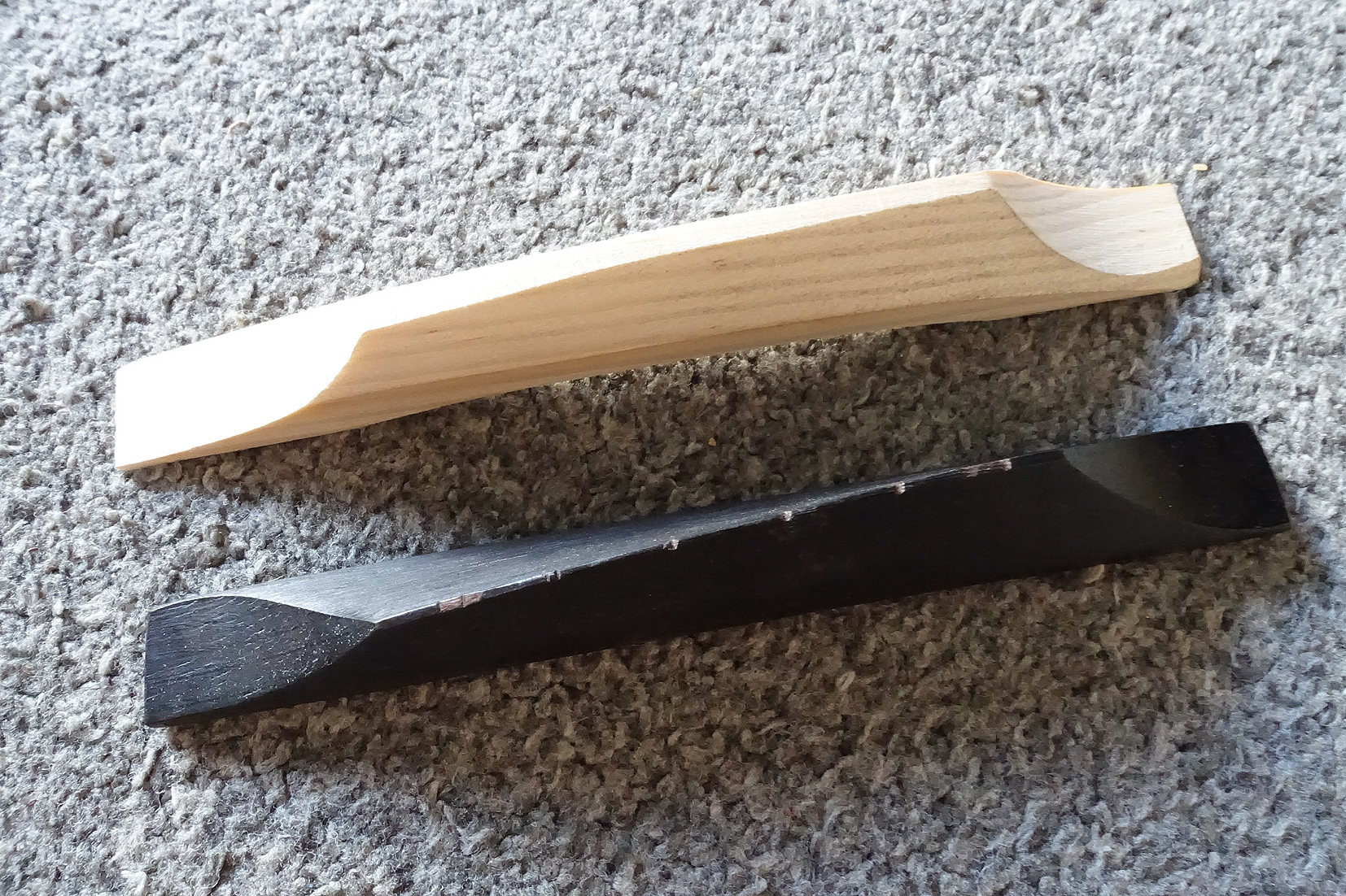

    I made a bridge this arvo from Pale Moon Ebony. I'm also going to try one from pine, but add a bone or ebony strip for the strings to sit on. This morning I went for a walk in the hills and found a nice stag antler - could it make a good bridge I wonder?!! I may try cutting it on the bandsaw.
    I've attached a photo of an ebony bridge I made for my Gallato, plus some photos of the Dupont.
    As for the Dupont, the original bridge will go back on, but with a couple of shims for raised action.

  • Posts: 6,098
    Beautiful guitar. Nice job on the bridge! Bill mentioned Craig Bumgarner. Craig describes bridges on his recent builds as "Sanduri bridge w/ ebony cap". Looks like this
    You could do the top insert from the antler.
