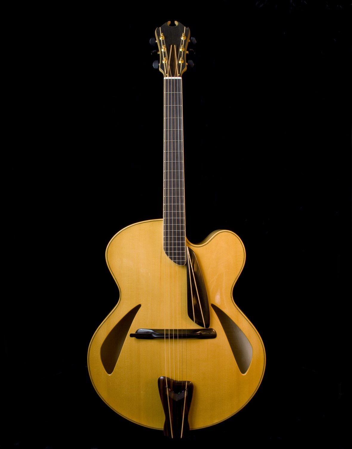

    I'm actually going to stay with Travis on Sunday, if you're around I'll have the blue guitar and the oval hole I took to Paris. And a crazy 7 string classical I made too.
    Blue guitar is basically the same as the Big Bouche thing I've been making. It has some carbon fiber on the braces, that's a new thing. But otherwise the same. 3 brace, thin top, high arch. Structured sides.
    Whatever my guitars sound like, this one sounds the most like that. Very very loud, really clear nice tone. I might like it the best so far.

    How did you get that pattern on the blue top? Pretty cool.
    Posts: 888
    Spruce doesn't take dye that well. The grain has these undulations and on each grain line part of it will accept the dye and part of it will reject it. If you spray the dye it will probably be smoother but I don't have spray equipment. So it's hand rubbed.
    I messed with it a lot, putting more dye on and then taking it off. I never did it before....initially it was too heavy and too blue. I also did some layers with a sort of honey amber and that gives it the "Blue Burst" thing.
