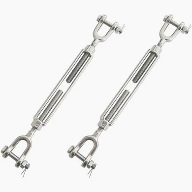

    So, who knows if your strut approach would or wouldn't work? You might even consider making it like an adjustable turnbuckle? 🤷‍♂️
