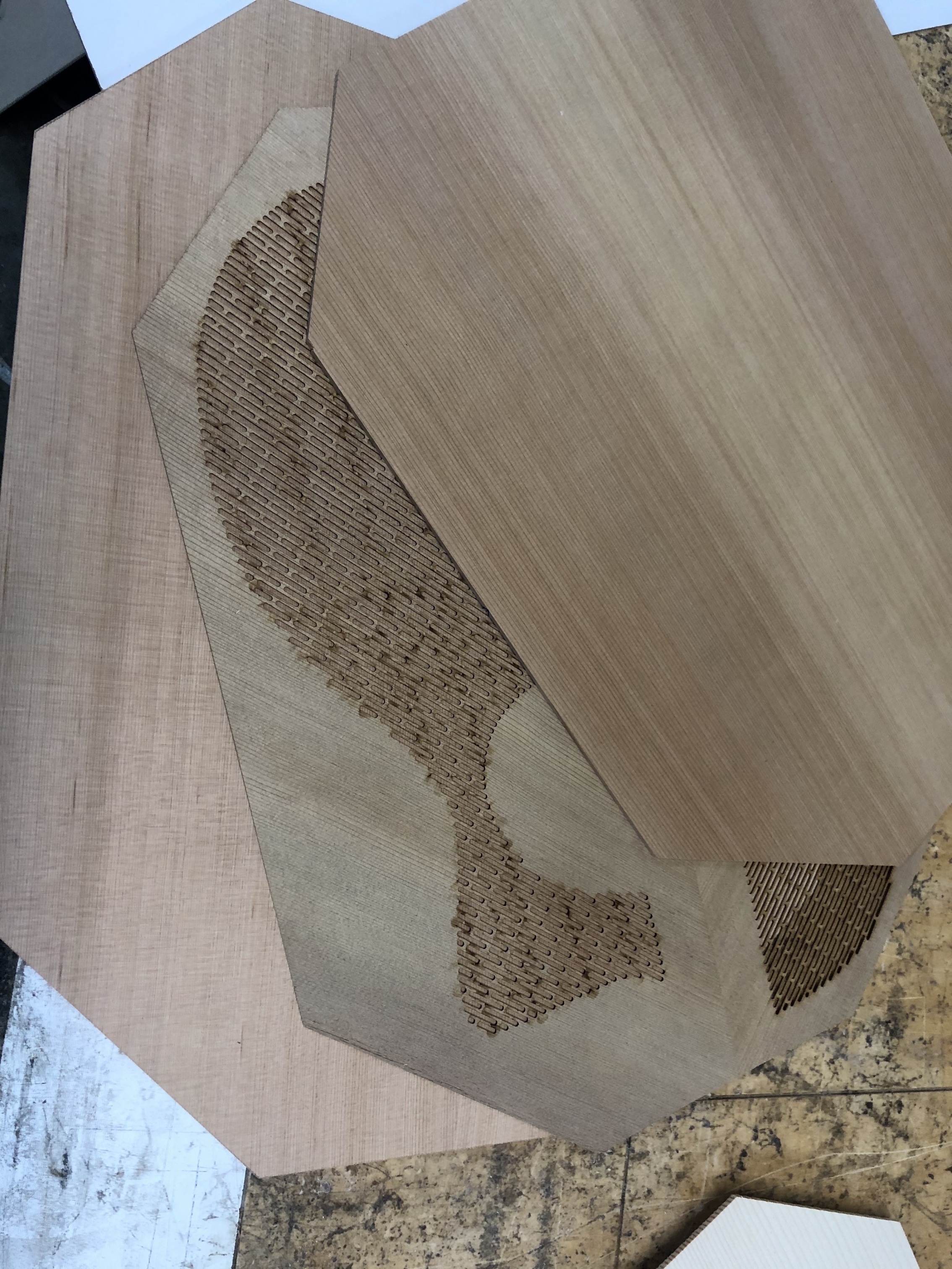

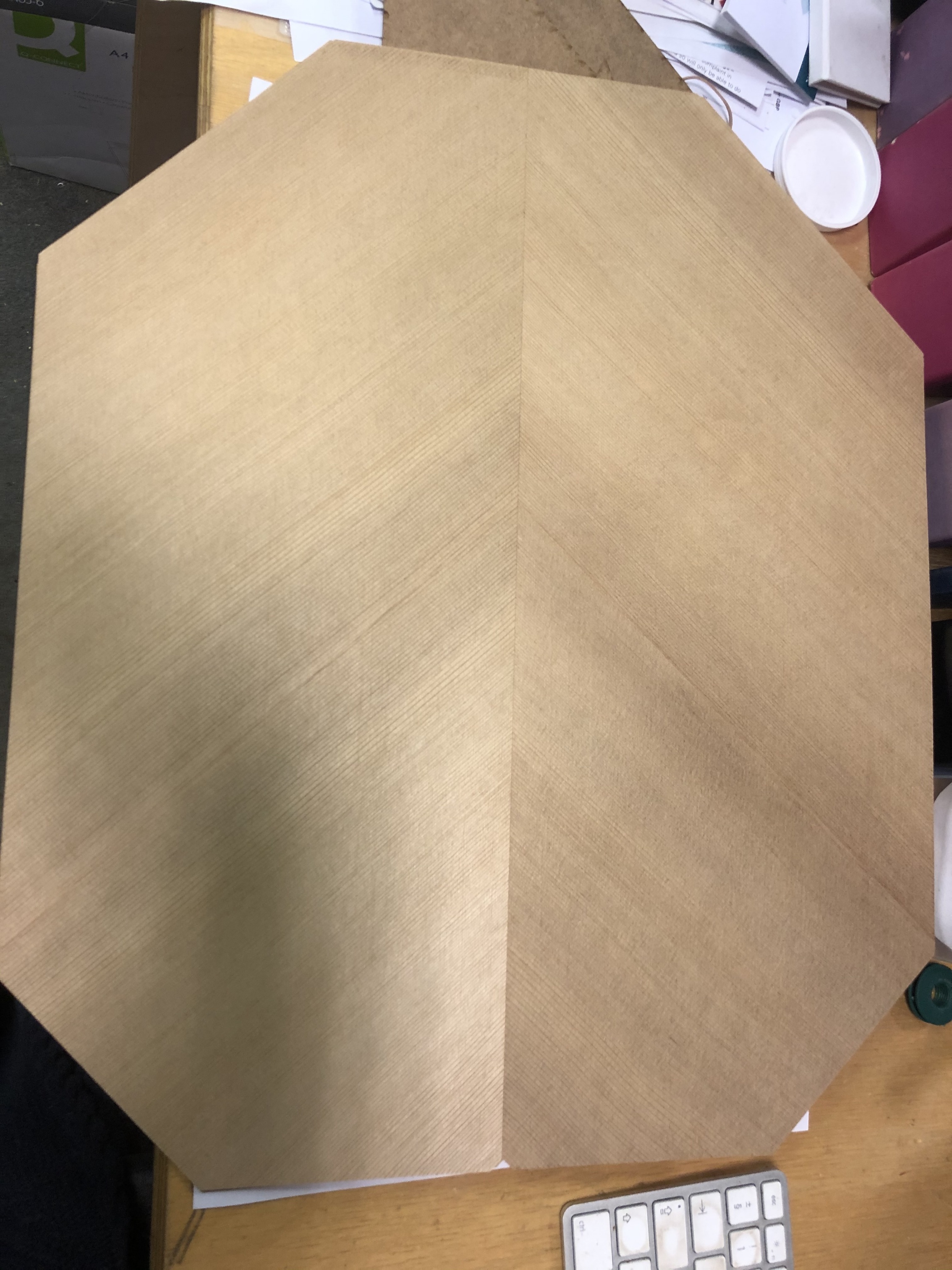

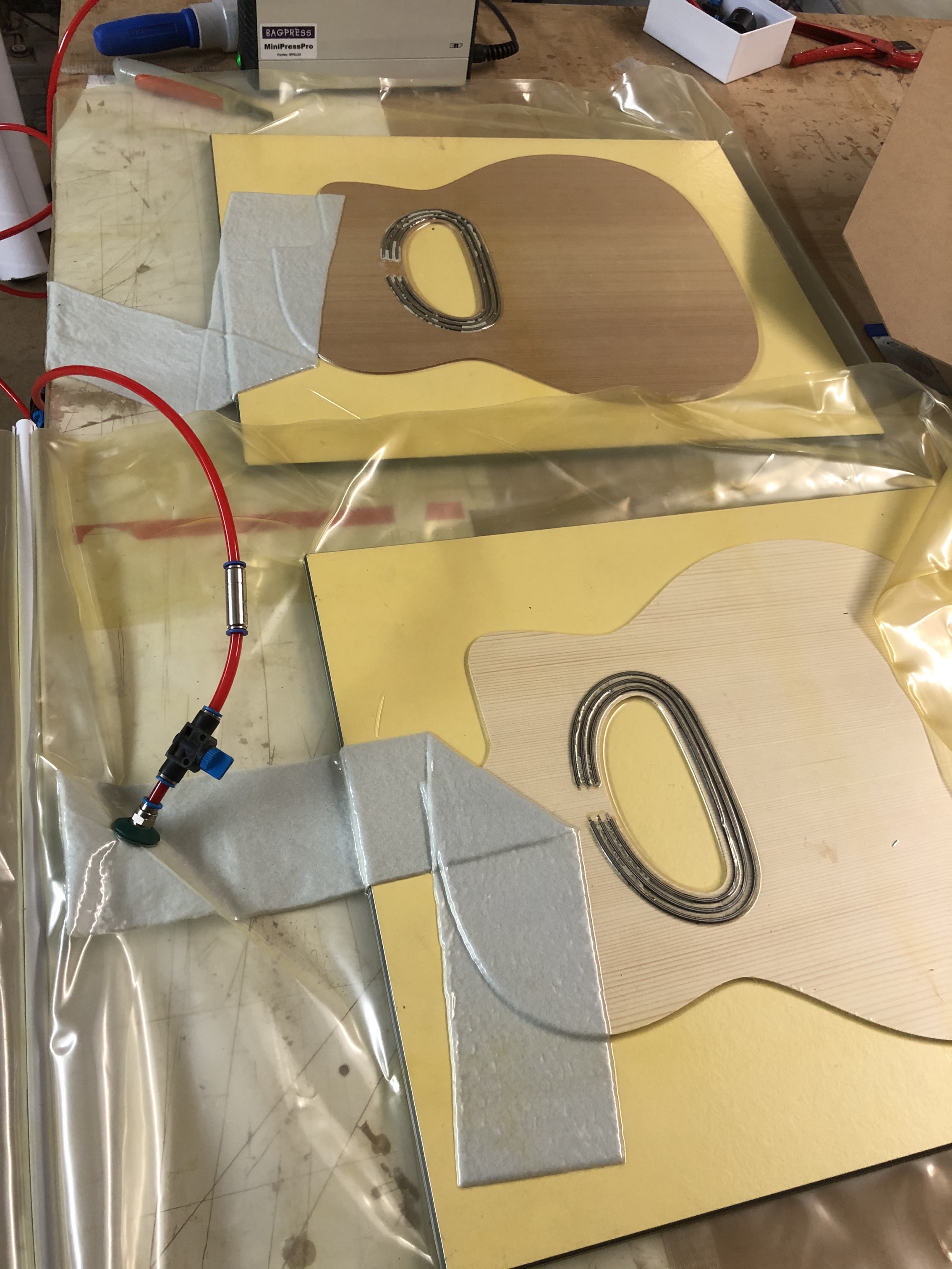

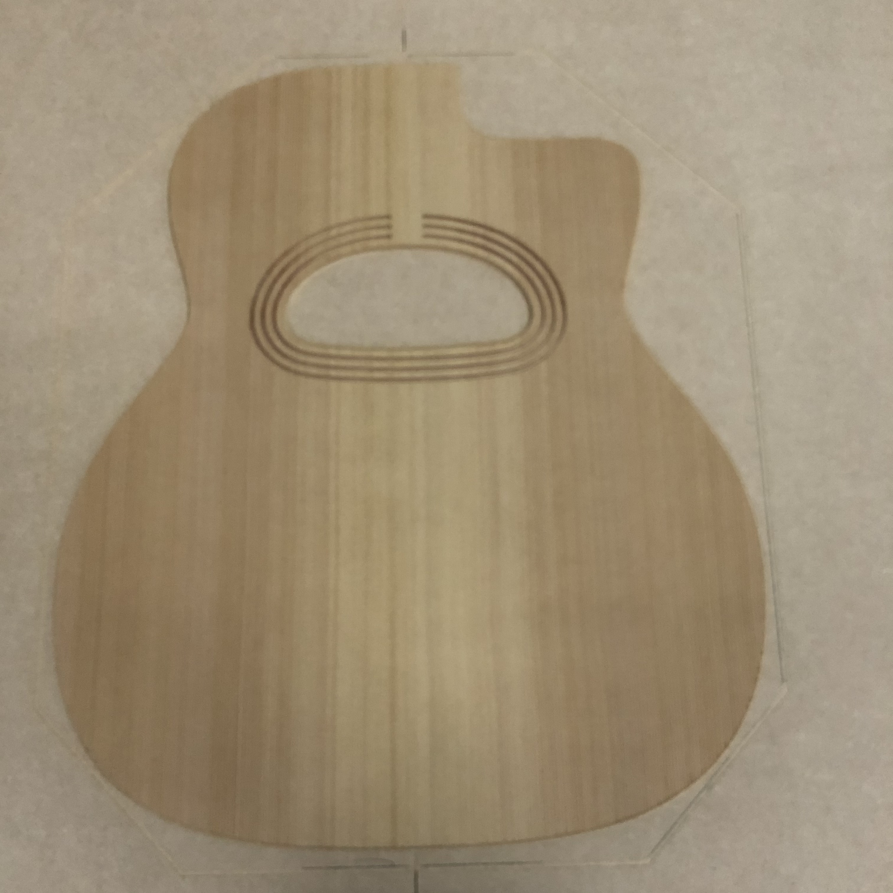

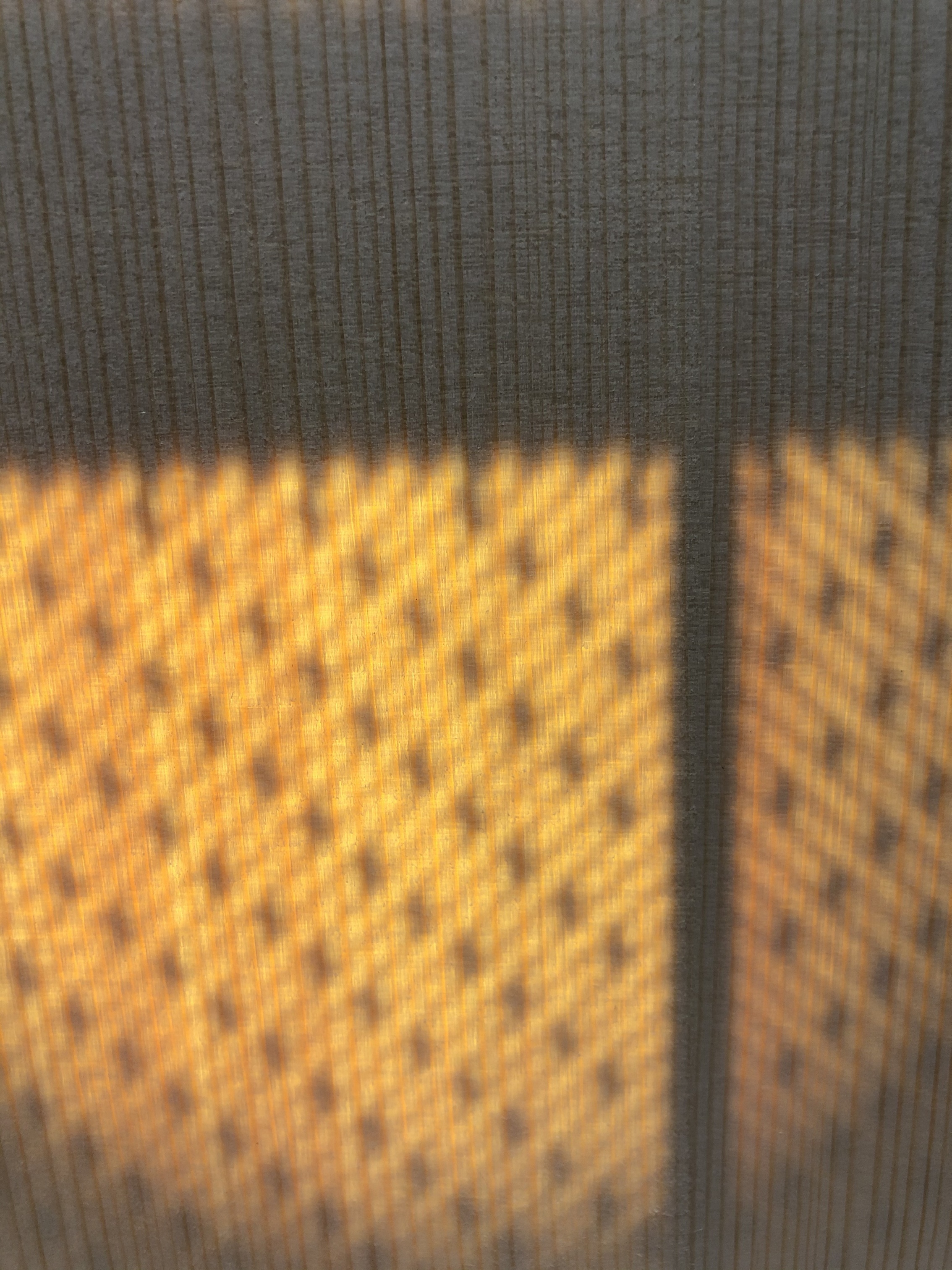

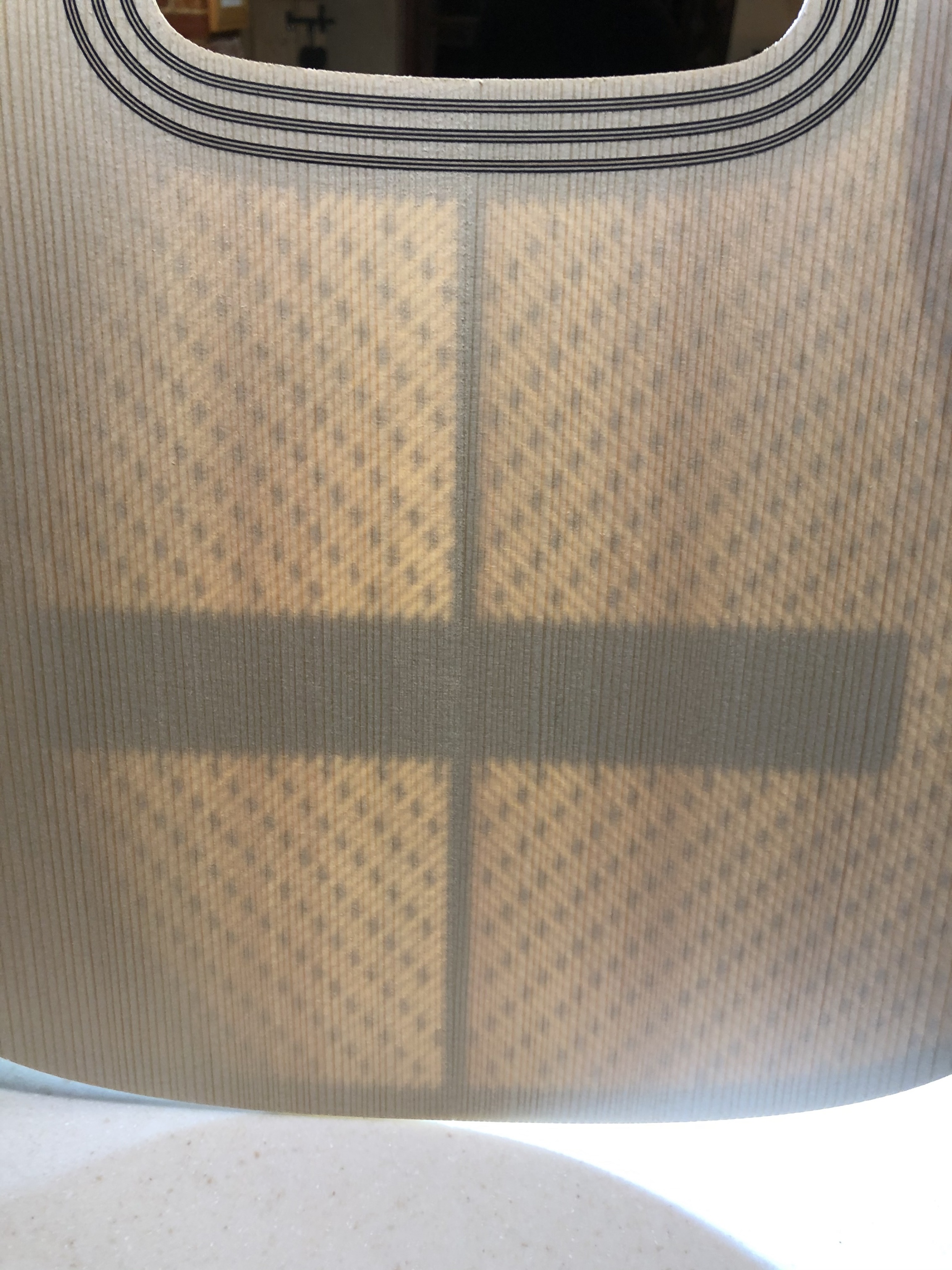

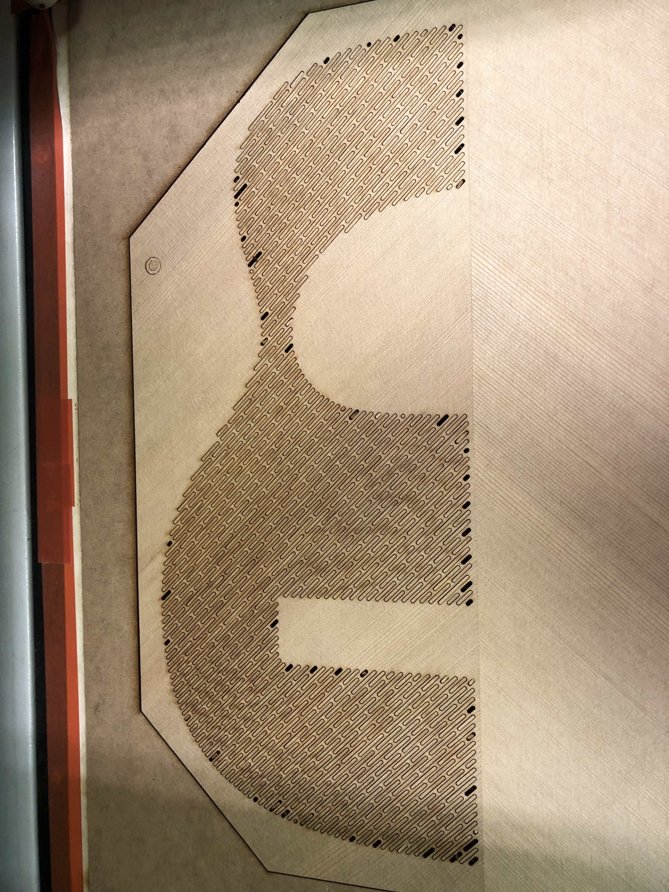

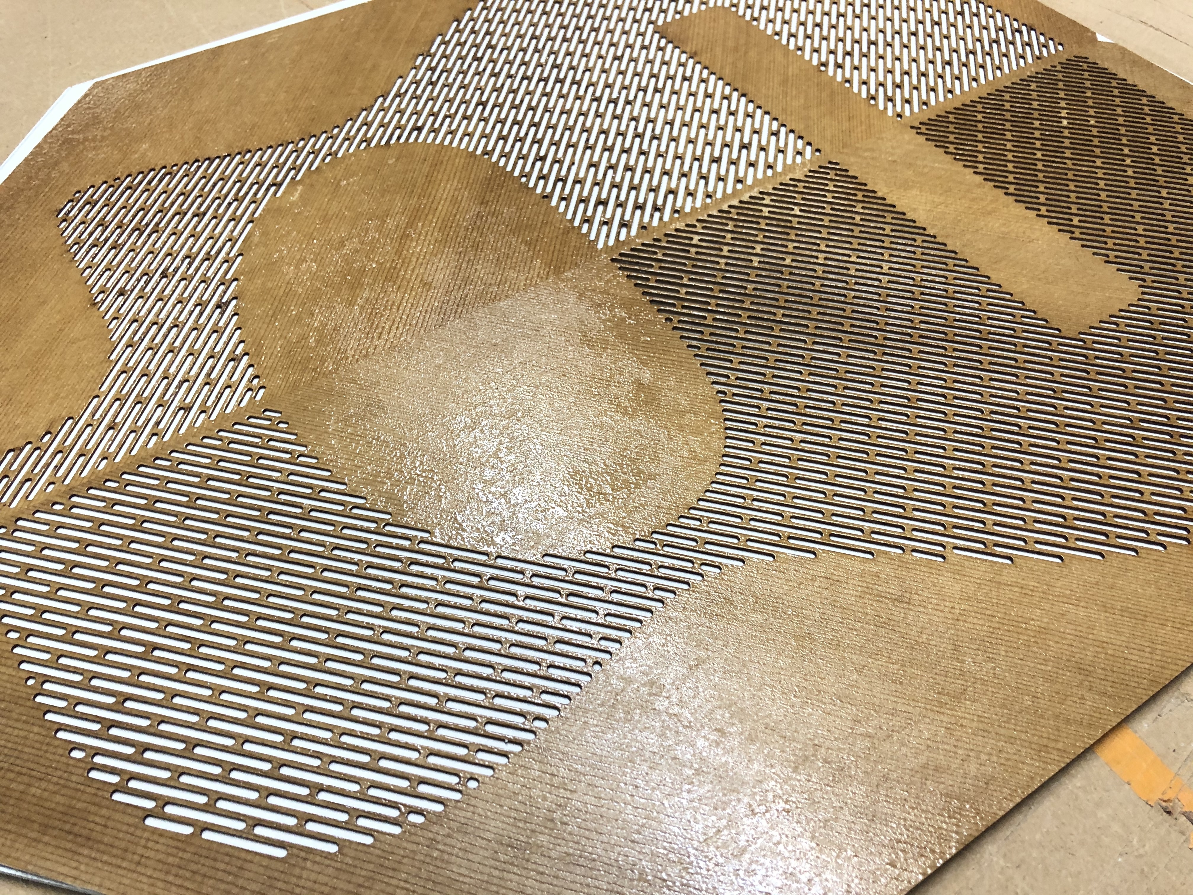

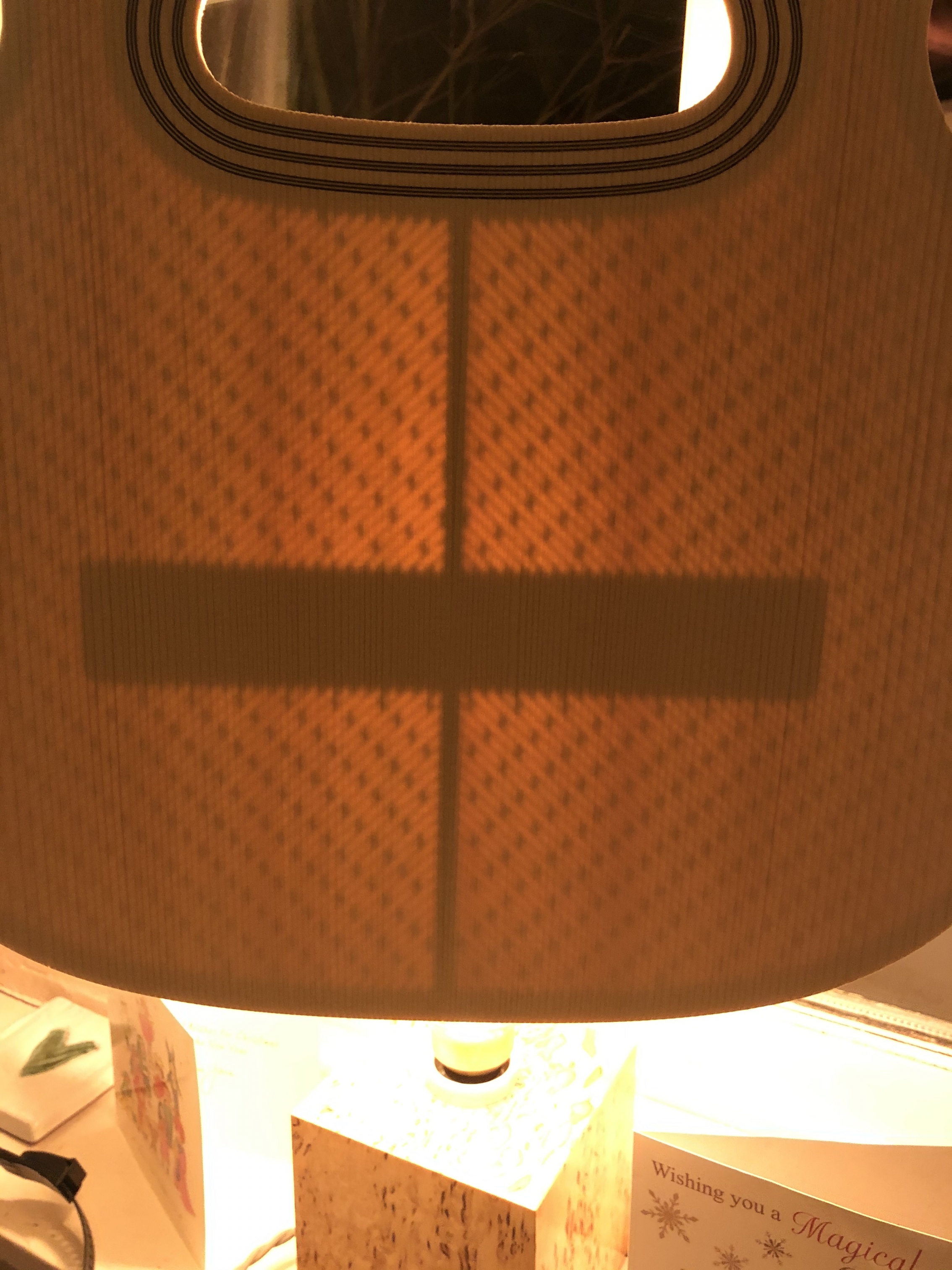

    Interesting, and hopefully my post can resurrect some buzz around this topic. I have just started to experiment with making double top soundboards but I have, so far, explored using a laser cut central layer of 1.5mm cedar veneer instead of Nomex. After gluing the core layer veneers they were then sanded to 1mm and sandwiched between the outer skins. I have angled the grain of the inner layer and the three layers were all bonded using a UF resin in a vacuum press. I have two soundboards glued up, one with cedar outer skins and the other with spruce. The cedar one I have taken down to just over 3mm and the spruce one to about 2.9mm. Of the two the cedar is by far the most resonant and sustaining, possibly because it is the same species of timber throughout. Hopefully I will progress with this guitar build over Christmas and I'll post some updates as soon as I have further news and if there is any interest.
