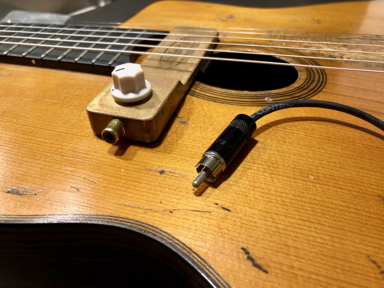

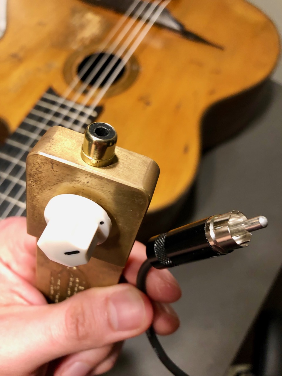

    4 years later! My peche was crackling and cutting out a lot recently so I took it into the shop to get the wiring fixed. I've also asked the technician to convert this into detachable cord with RCA jack, which he was able to do.
    So here's what the old pickup looks like with the modification, it worked well.
    The price was $3 for parts and $90 for labor, for a total of 93 USD. If your peche doesn't have any wiring problem and you only needed a jack installed probably the labor should be cheaper. The shop was Avenue N Guitars in Chicago.
