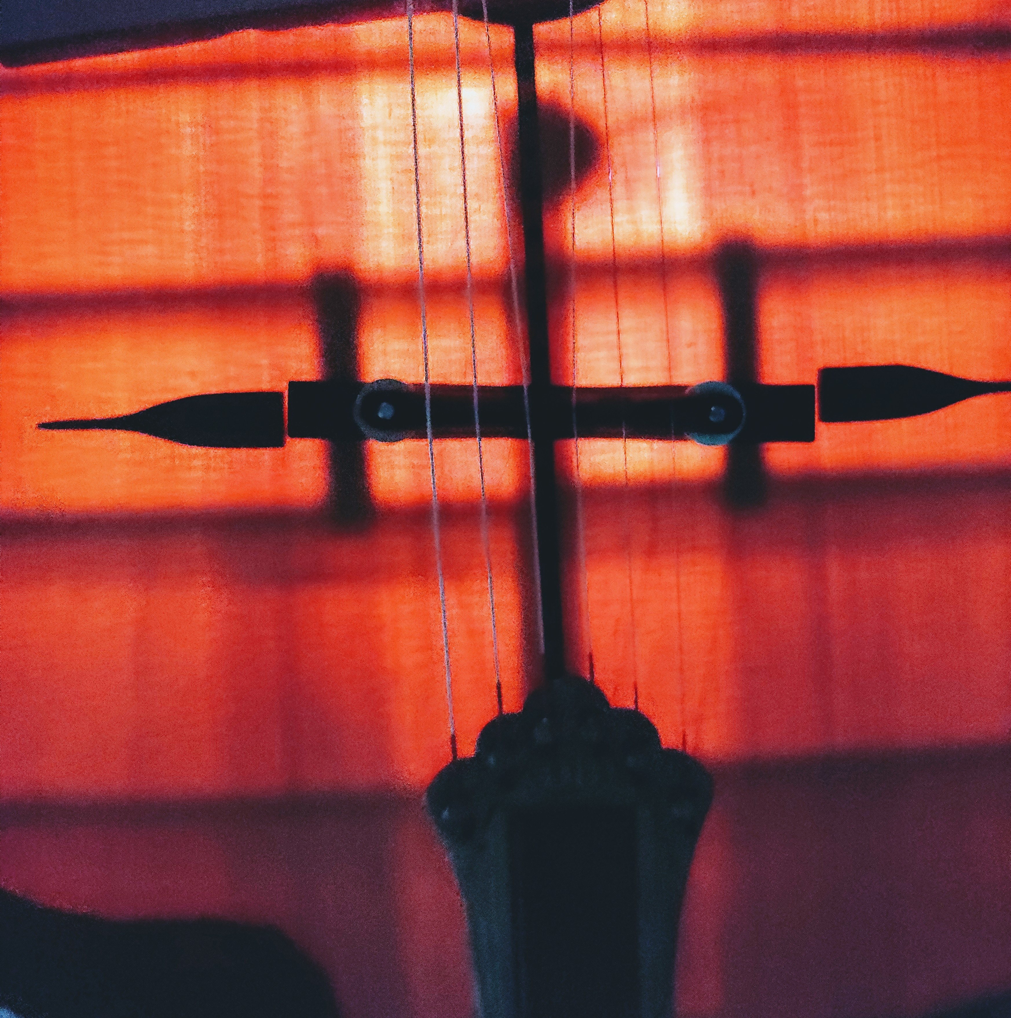

Hello. I bought a Carlos J. CS sensor and I simply don't know where to put it. I followed the manual and tried to find sweet spot on the top outside. But I want it inside and when I tried it in the same places there were brances or the sound was different...much worst. Lot of hights no bass or boxy sound. So I tried different places and I'm desperate. In every try I have to loosen the strings and tune it again and find somebody with small hand. Feel pain for strings and neck. And M3 sticker doesn't work after few try. So my question is: Is there any safe place, some tip? Is it that big difference between putting it outside or inside? I have typical selmer oval with brancing similar to the picture. Thanks a lot for all your advice!

    I don't have a CS sensor but this is where Manouche Mic on my guitar is mounted internally. The black dot towards the top of the picture is it. Just above is the end of the soundhole.

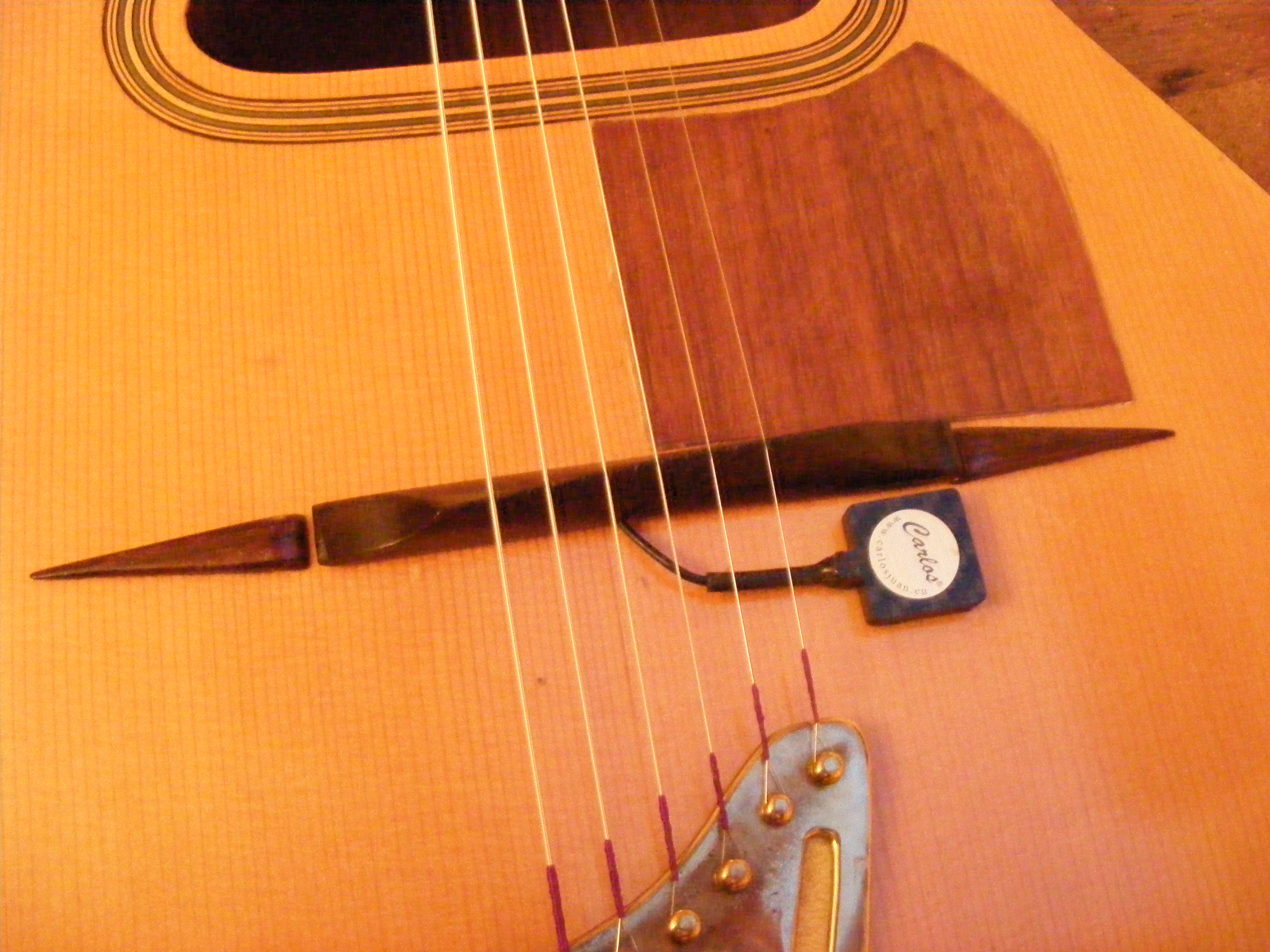

    Hi there. I recently installed a CS sensor onto my Alex Bishop. I had to mount it externally as the braces didn't allow me to fit it internally. My guitar is a Dhole so access to inside is easy but I have very small hands and can even fit my hand inside a smaller oval hole model. Anyway, I found the sweet spot relatively easily but I found the black dots or squares included didn't stick that well however it was good enough to locate the sweet spot then I marked off the edges of the cs sensor with some masking tape so when I removed the protective cover from the sensor it would be placed just where it needed to be. Here's a picture of where I placed it on my Alex Bishop.
