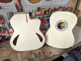

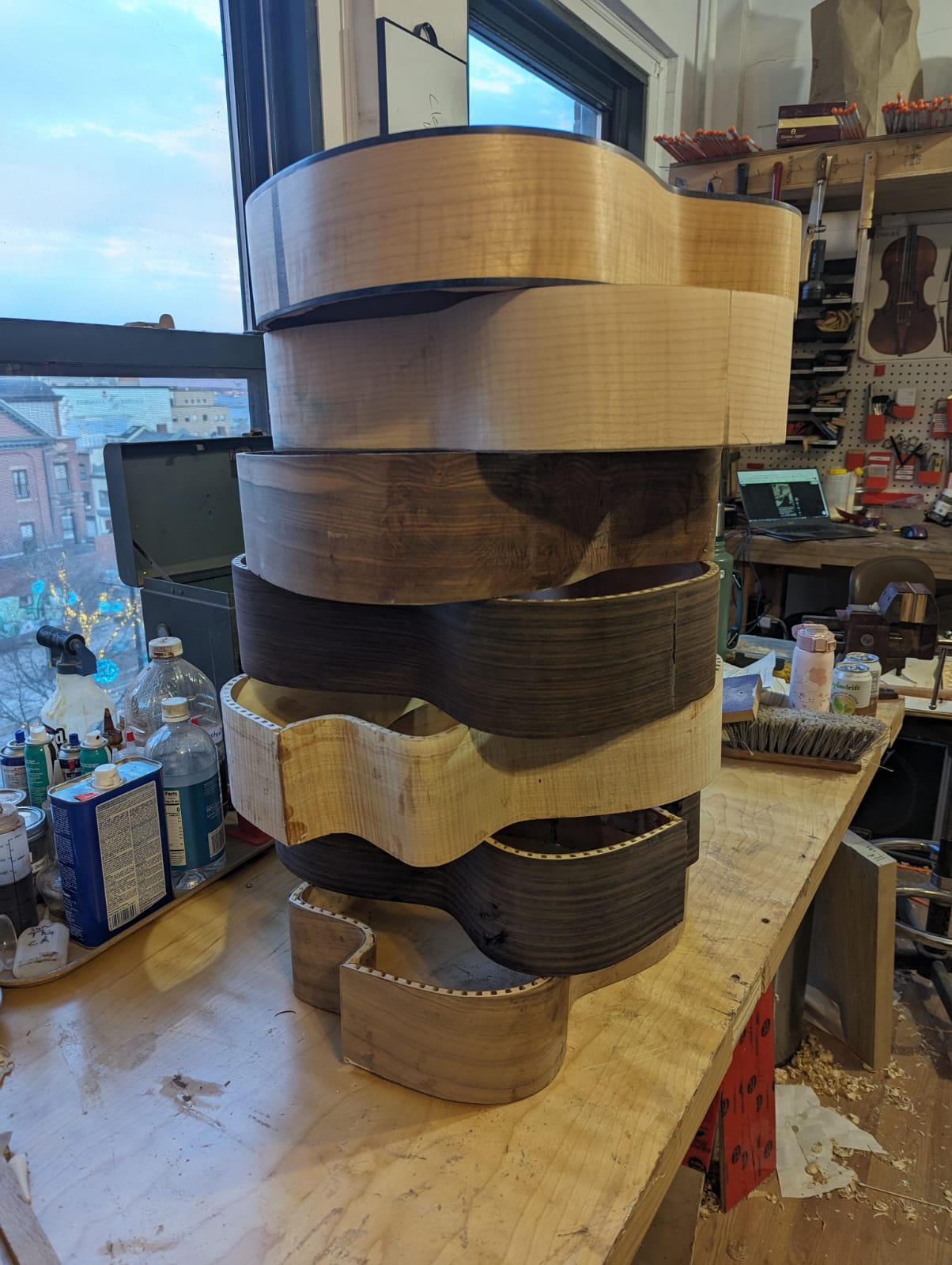

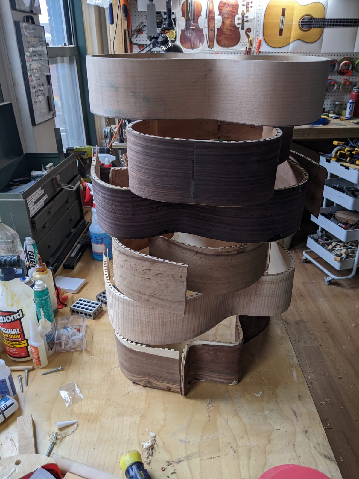

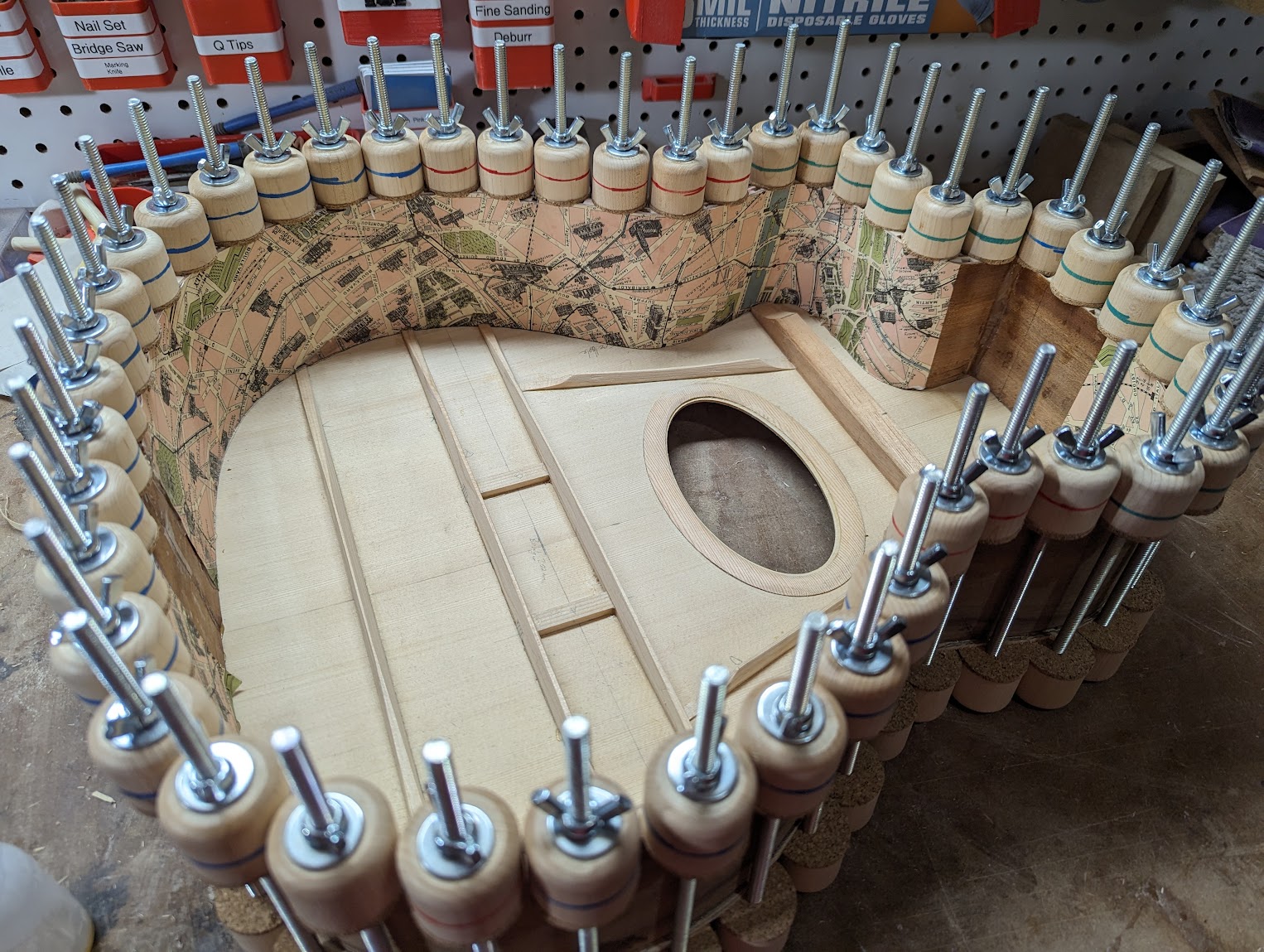

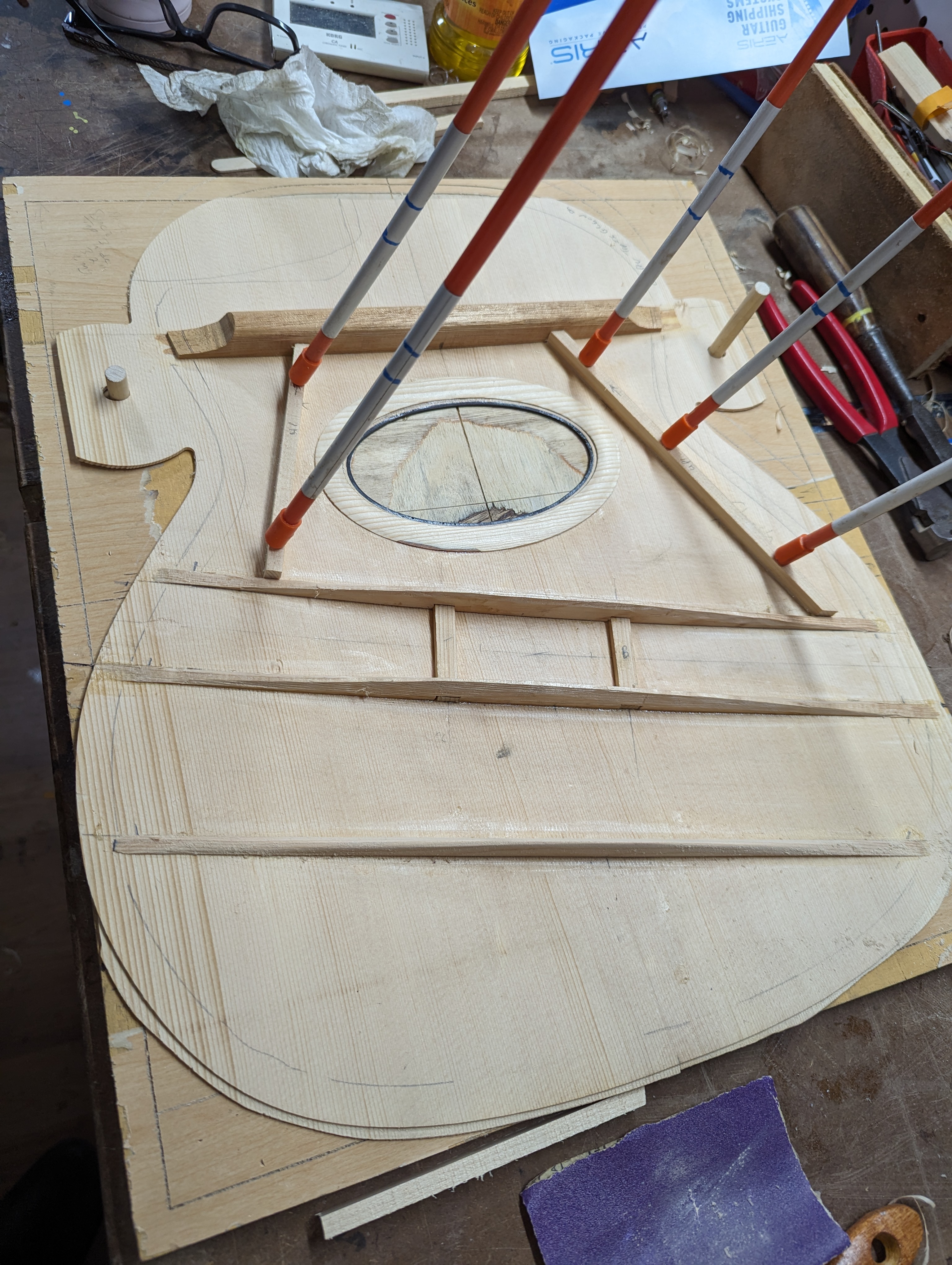

I was going to post some pictures of what I'm working on in my shop this Spring. I have 4 Gypsy guitars in process. I'm hoping to have them all finished by Django in June, we will see.
The Current plan is

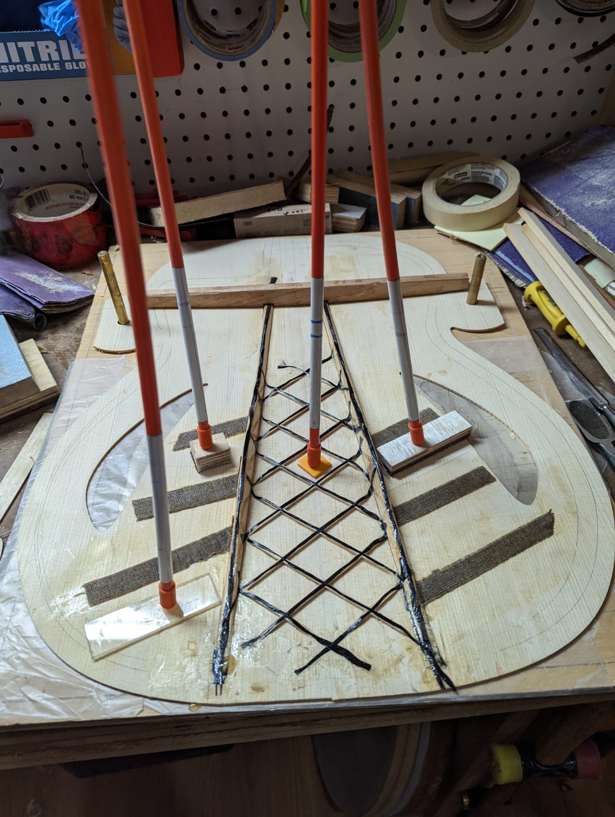

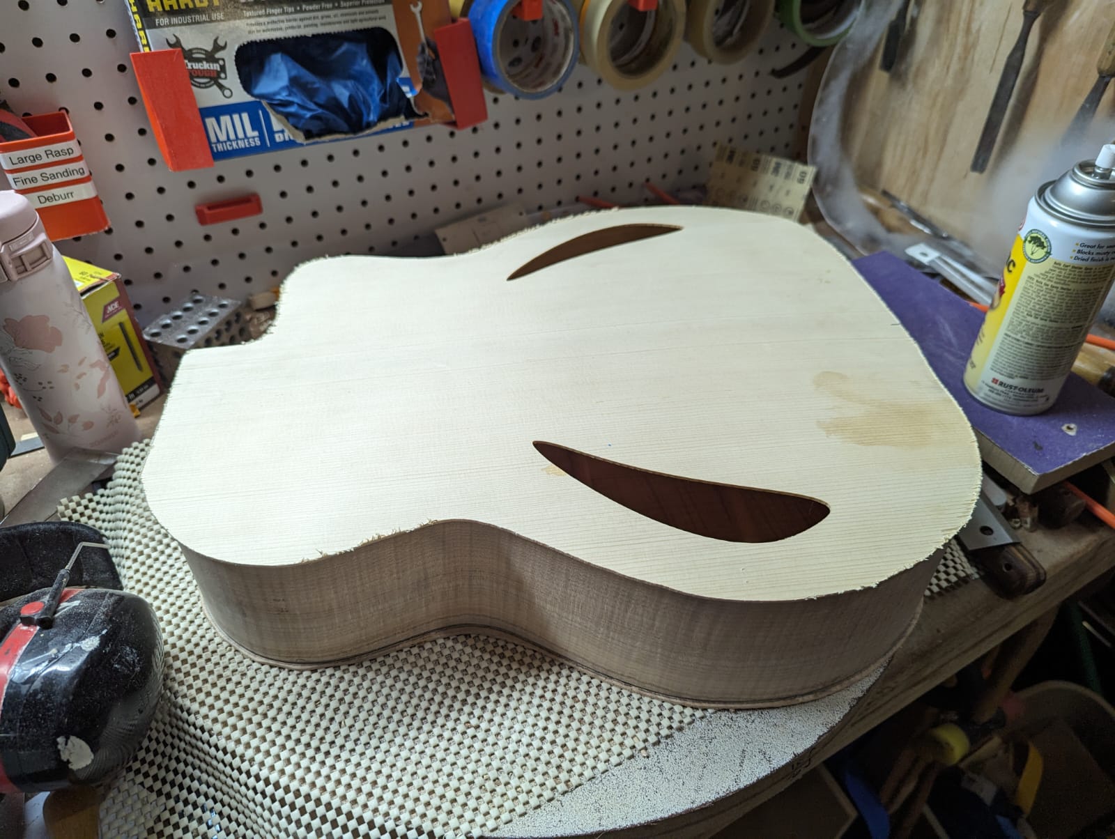

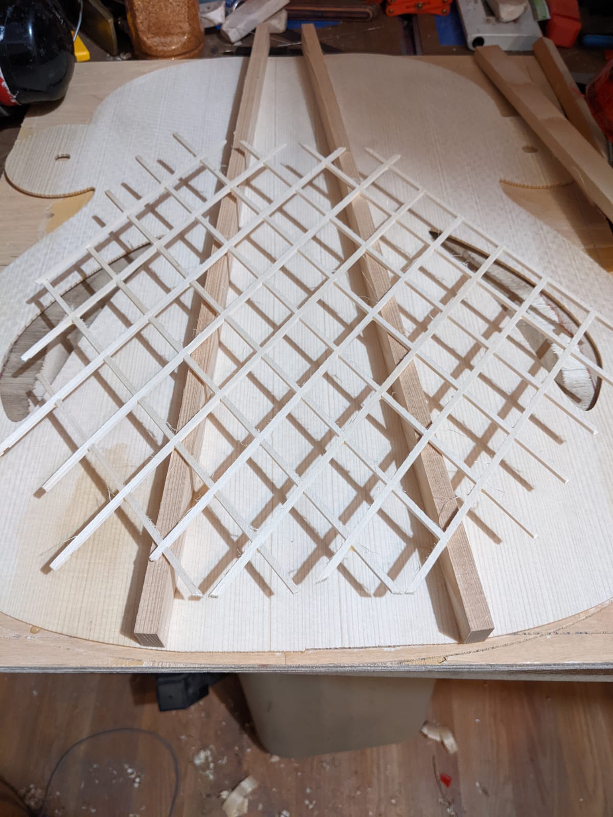

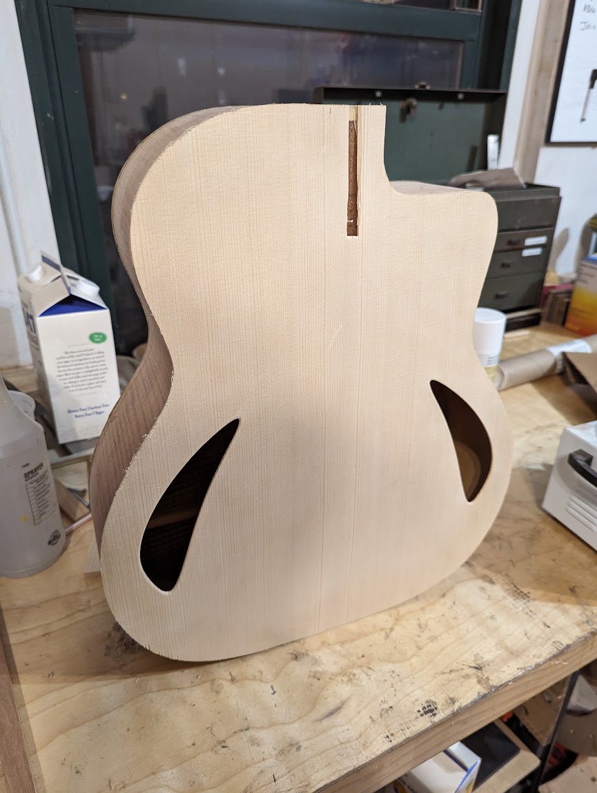

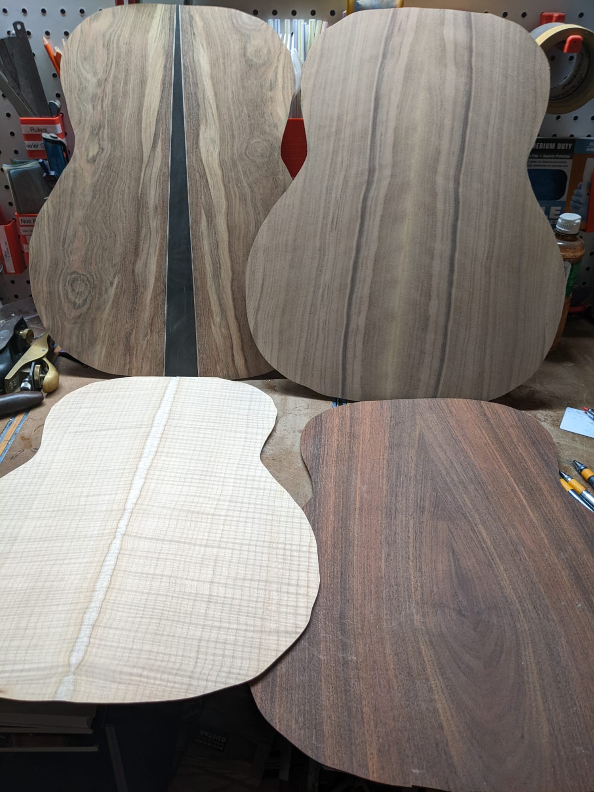

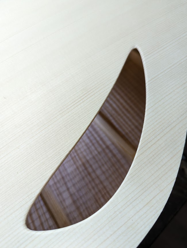

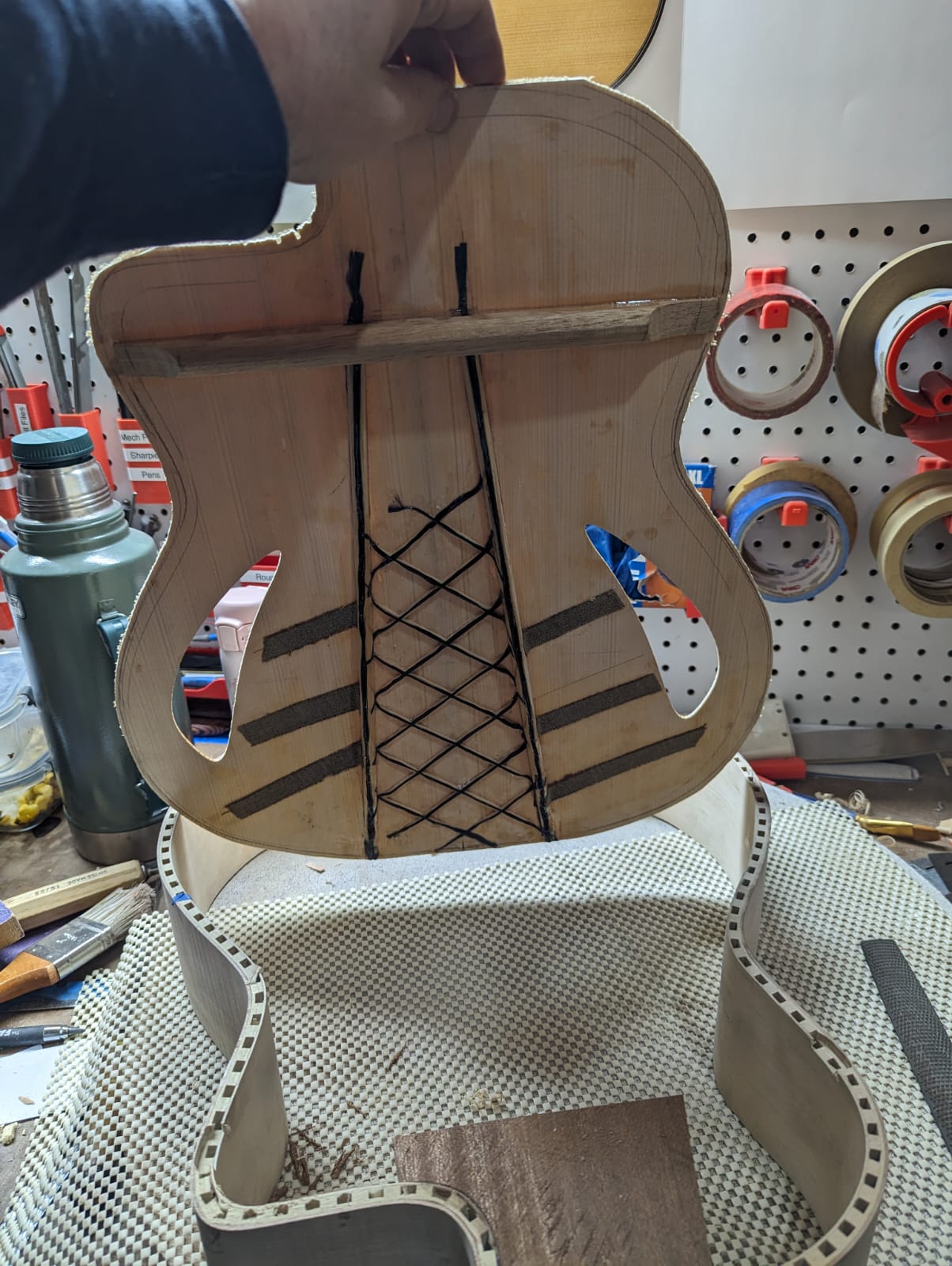

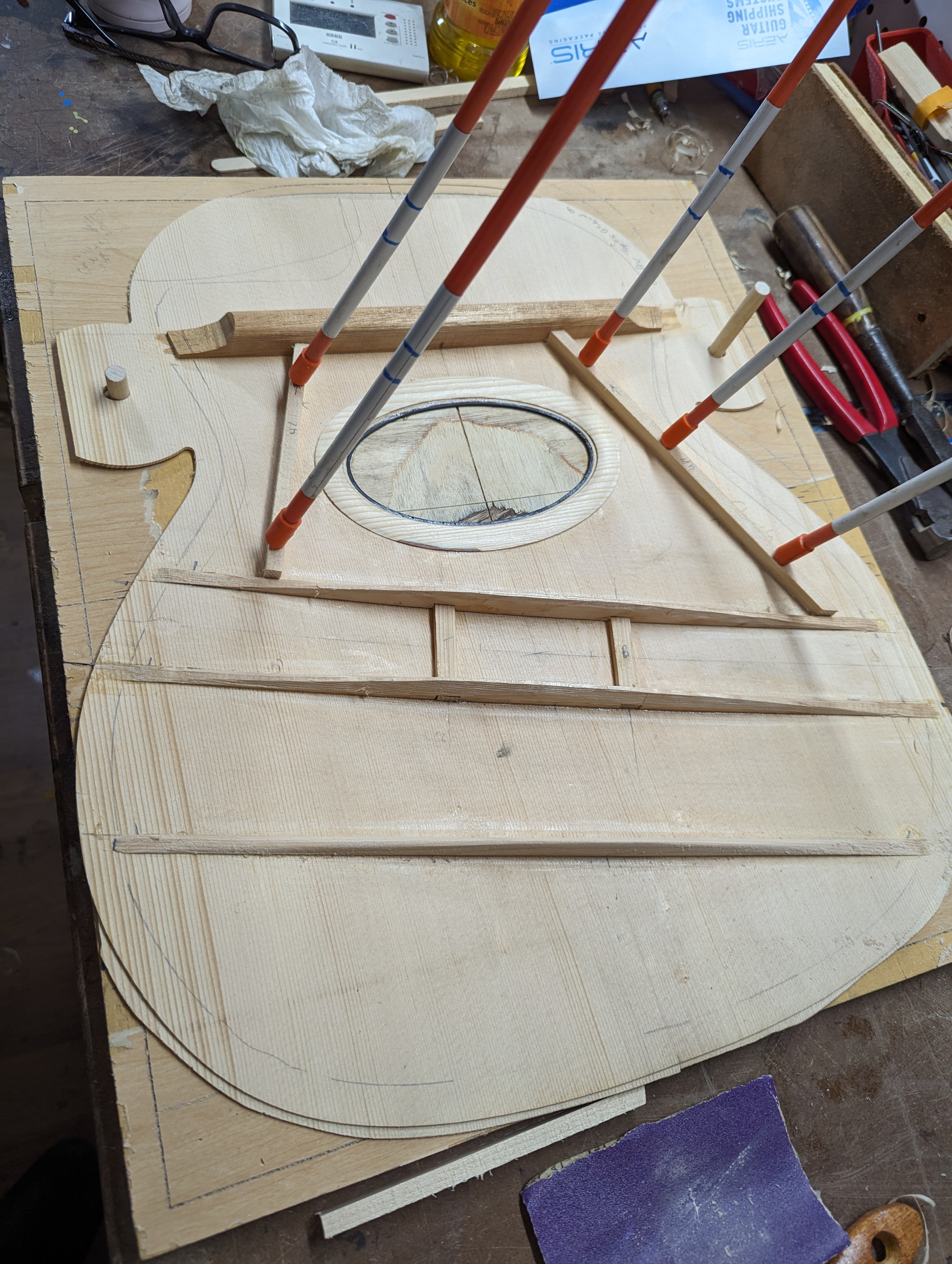

1) Maple/Spruce guitar that's a mashup of a Selmer body shape with D'Aquisto Centura style sound holes and visual style. Because of the sound holes I went with vertical bracing like an archtop. There's a carbon fiber/spruce lattice reinforcement in between the bars to maintain the arch. This guitar is a total experiment but something I've had in my mind for a number of years for some reason. No idea how it will sound, I'm hoping at least that it sounds like "a guitar" and I assume it will.
2) A Chechen/Spruce "Big Mouth" guitar based on the one I made last year
3) A Walnut "Big Mouth"
4) A Rosewood Petite Bouche with traditional styling

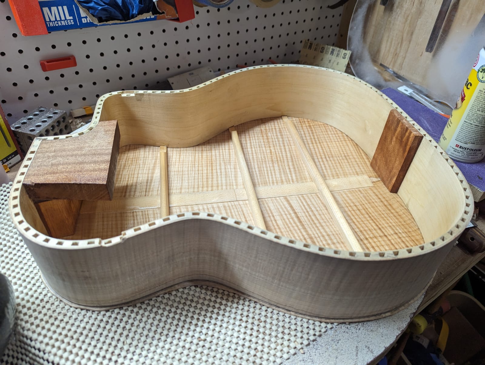

All of them will have cored/structured sides and adjustable necks. I may do a mild multiscale on one or two of them as time permits. I may do some carbon fiber bracing reinforcements also, I haven't figured that out yet.

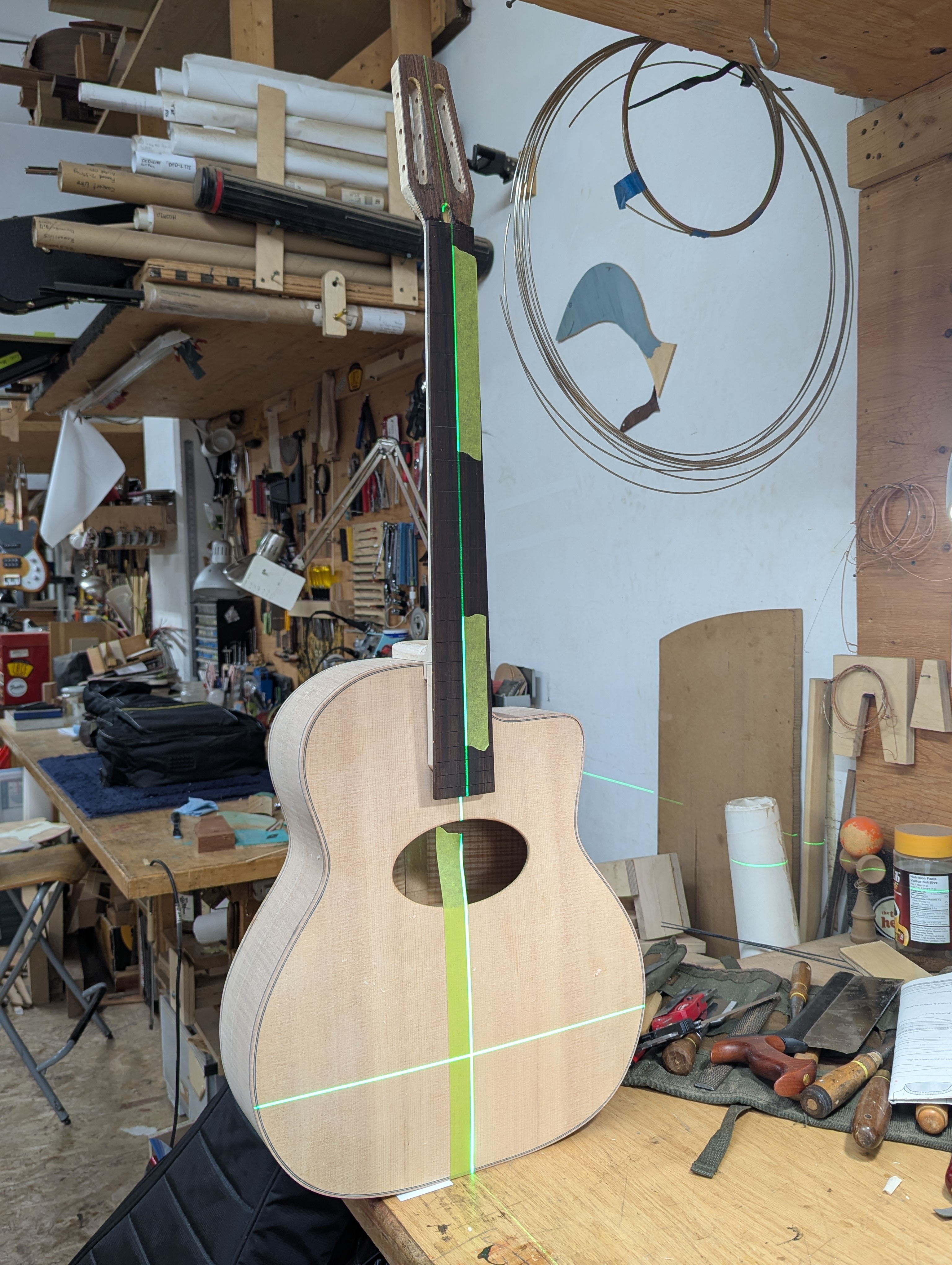

    That's awesome, Paul! Are your adjustable necks based on the Stauffer system?

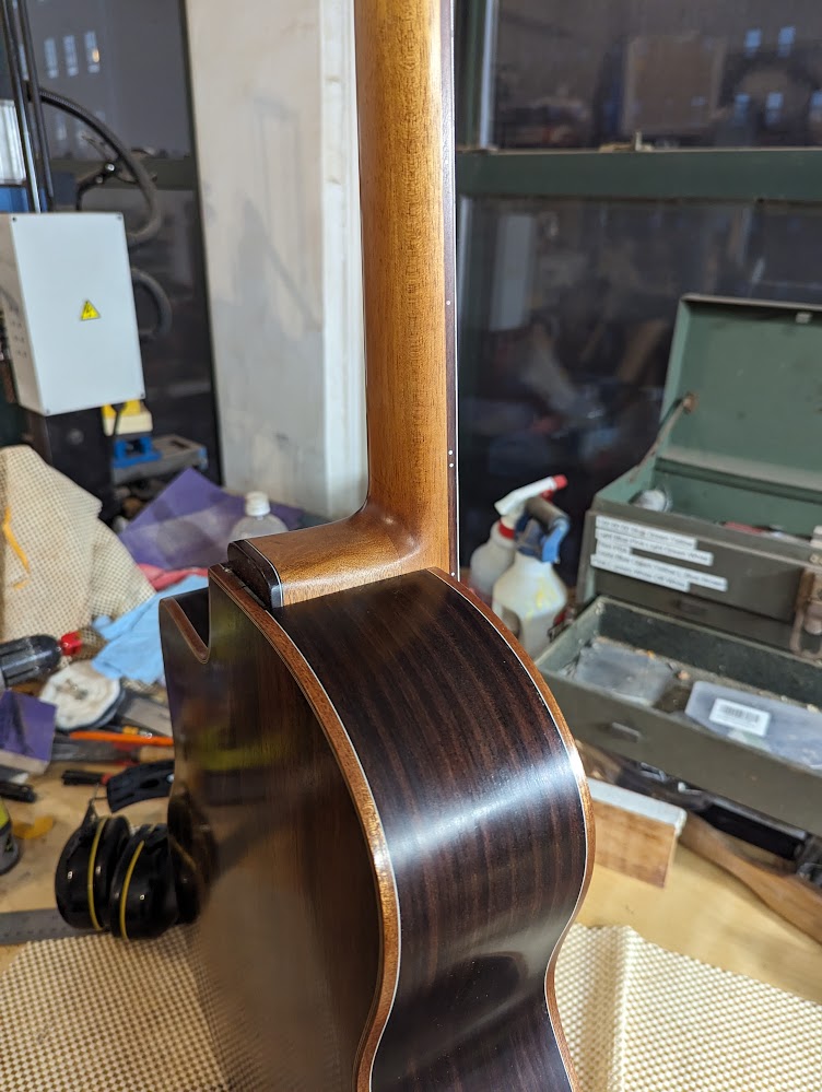

    My neck joint is based on an idea that's floating around that I found out from Trevor Gore (kind of modernist/scientific guitar maker and author). I don't think it's hugely different from the Stauffer system but to be honest I've never seen one in the flesh.
    There's some pictures here, including some of the first guitars I did it on, and it's still evolving. Regardless though it's a simple system, there's a slot in the neck heel that rides on a tab in the guitar. The strings pull the neck downwards and there's a set screw in the fingerboard to adjust. The strings hold the neck on. I used to put a restraining bolt in, because if you take all the strings off, the neck comes off. But there's (to me) no reason to do that, so I stopped doing it. One string will hold the neck on and if you want to take the neck off (and put the guitar in a suitcase, for instance) you can do that. It's a very simple design. Thus far I have had zero issues with it.
    https://photos.app.goo.gl/xjNawya1rFZ6itC29

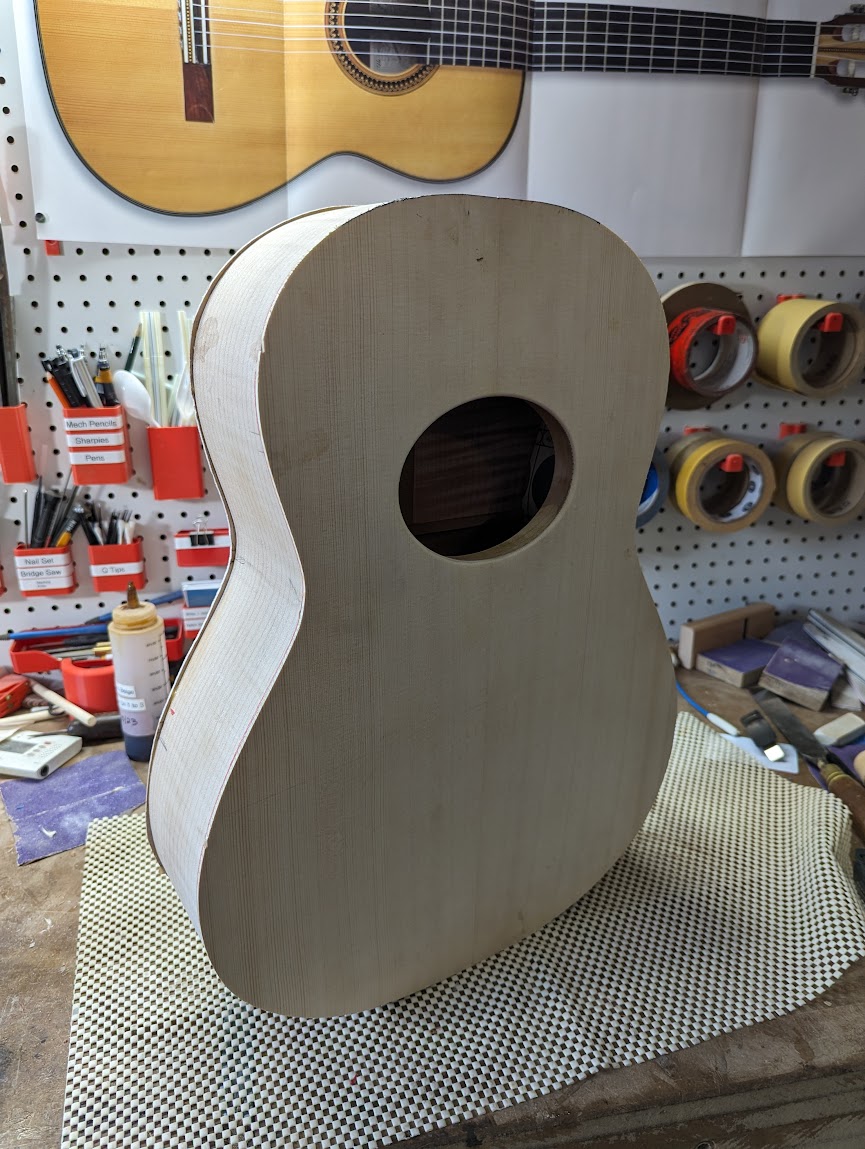

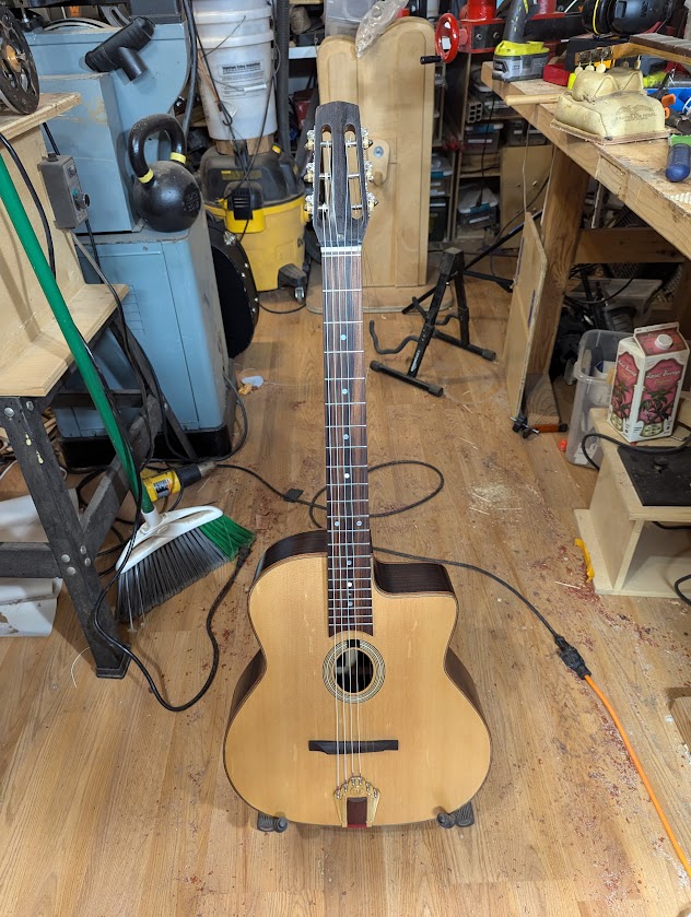

    My big mouth guitar was another experiment. I wanted to make a sort of Petite Bouche shape bit with a bigger hole but then the hole got too big to go vertically. On the prototype the CNC decided to punch through my rosette so I had to improvise. It is not a beautiful guitar (to my eyes anyway) but it turned out sounding very very good. One of the loudest if not the loudest acoustic guitar I've ever heard.
    So I will be working on somewhat more traditional versions of that guitar.
    It's cheating but here's young Sam Farthing ripping it up on that guitar.
    https://www.youtube.com/watch?v=L-ILVuVawPc

    Apologies if I asked this before, Paul. What sort of bridge and tailpiece will you use on #1? Will you side more towards the Selmer style (i.e. HSC and moustache) or the larger wood tailpiece a la the D'Aquisto?
    Keep the photos coming. Love to see the insides of these and the makings of the projects. I might just get to DiJ to see some of these.
    Posts: 960
    Good questions.
    Bridge will be sort of Selmer Style in construction but without the moustache and styled as much as I can to fit somewhere between D'Aquisto and a Selmer. Tailpiece wise, neither I think. Something like a violin tailpiece on a peg, I like the idea of a floating tailpiece. I haven't really figured out how the geometry of that will work yet. Appearance wise though it will be more like the D'Aquisto.
    I really have no idea if this guitar will make any sound whatsoever...it's totally something new. But I'm enjoying the experimentation.

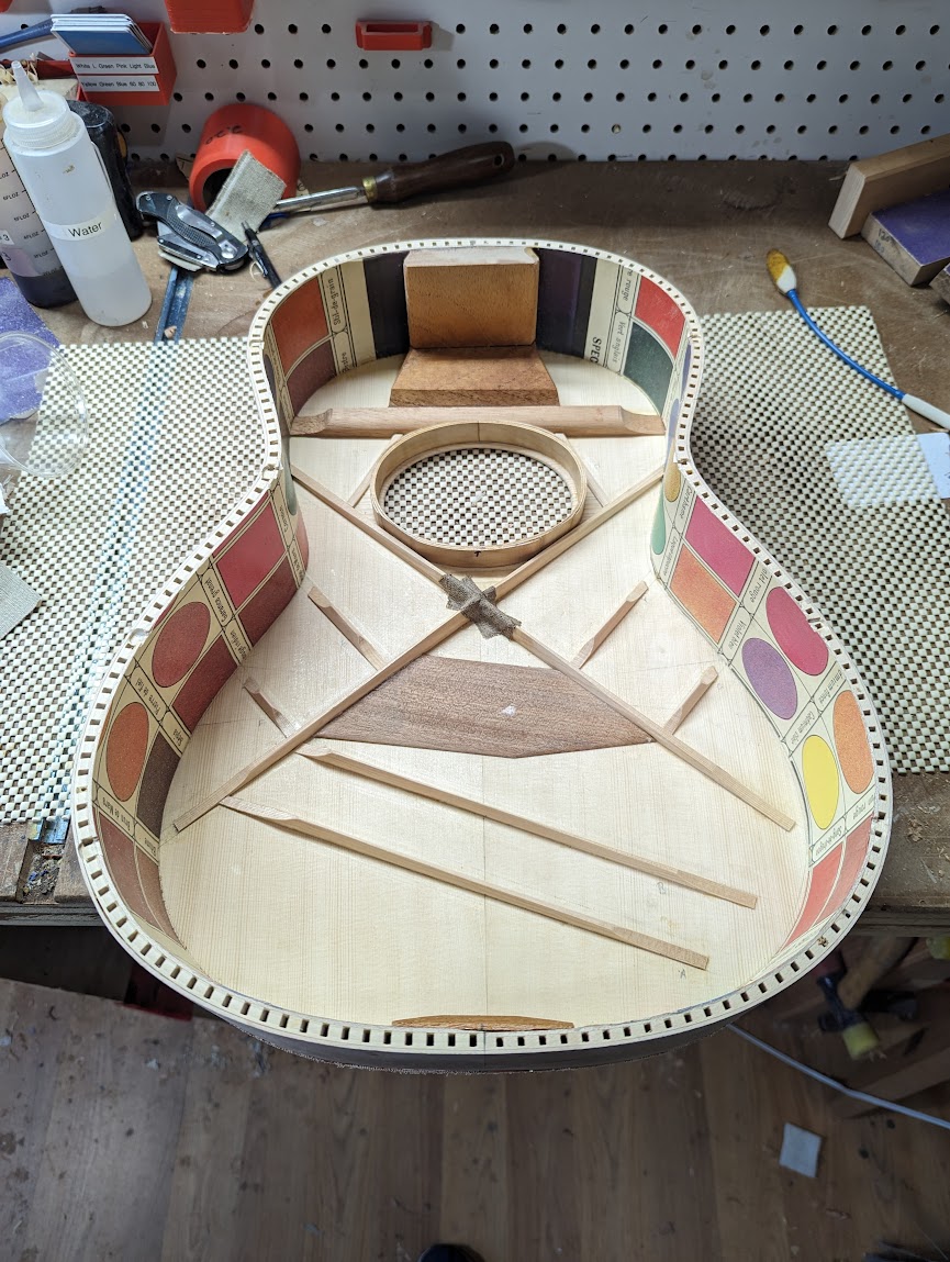

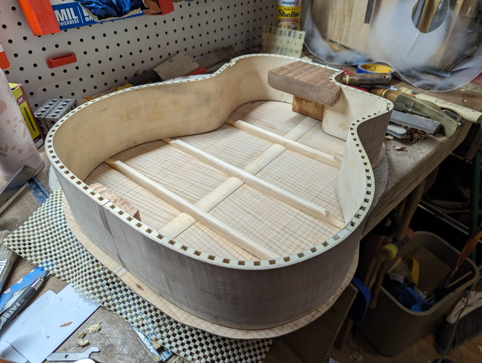

    I got the back glued on today. Only four more tops/rosettes/braces to go! Oh plus blocks. then necks.
