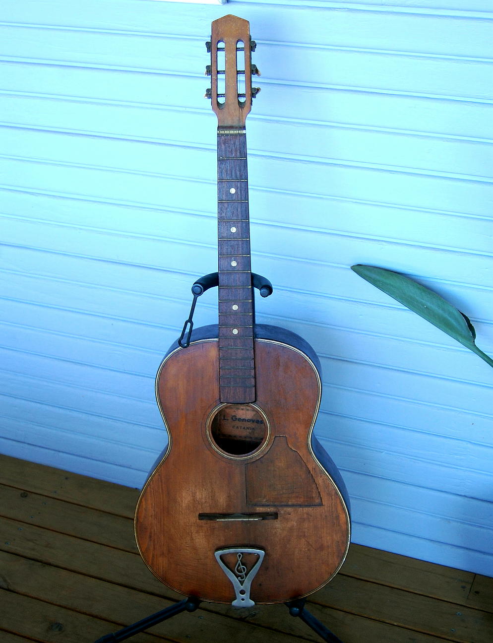

    There have been questions about this kind of tailpieces:
    https://www.galerie-casanova.com/portfolios/petite-bouche-jazz-anonyme-c-1940/
    Maybe Jerome Casanova can tell more about it?
    djazzy
  • ChrisMartinChrisMartin Shellharbour NSW Australia✭✭ Petrarca, Hofner, Burns, Kremona Zornitsa, Fender, Epiphone
    edited December 2021 Posts: 1,034
    Well I can take a guess about that guitar (as could anyone else).
    Certainly the body shape, soundhole and thirteenth fret join all suggest Busato,
    It has the yellow button tuners by Delaruelle common to many Paris made guitars, but the bridge with its white trim detail is typically Italian.
    The neck meanwhile has a Di Mauro shape headstock, again a common enough design but I notice it also has that little felt strip behind the nut which nobody has ever been able to explain but I have only seen on Di Mauro guitars.
    Until I posted recently about finding a small. parlor size. guitar by Luigi Genovesi with the same tailpiece they had generally been seen on guitars labelled, or more often, branded as Sonora. Sonora was a wholesaler or retailer but not a luthier, possibly Italian. Some of us are still looking for more clues to the Sonora story. It has long been known that Busato did indeed make guitars for Sonora, to the point where some would like every Sonora guitar to be a Busato if only for financial gain.
    So that is my guess, a hybrid Busato body with a Di Mauro neck and bought in hardware assembled for Sonora but escaped the branding iron.
    Anyone care to take another guess?
    Here is the Genovesi:
    And a Sonora I sold a while ago which also has a thirteenth fret join and the same bridge:
    WillieAndyWBillDaCostaWilliams
    Posts: 151

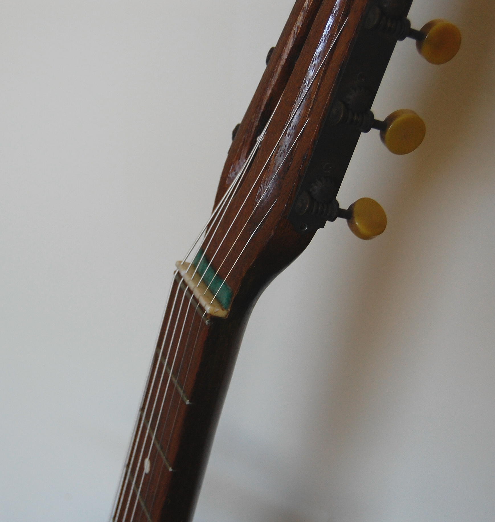

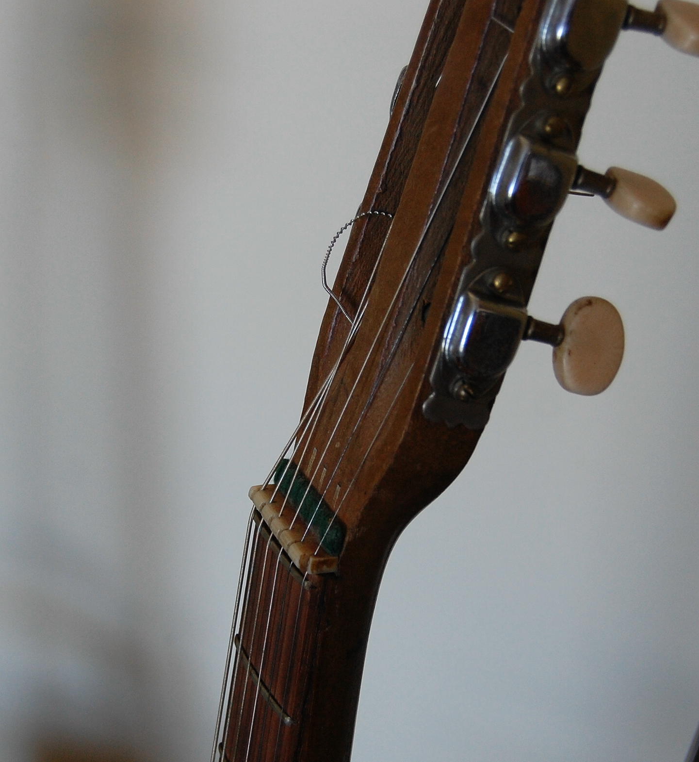

    “it also has that little felt strip behind the nut which nobody has ever been able to explain”
    The guitar appears to have single-routed tuner slots (as opposed to the common, and trickier-to-do, double-routed tuner slots, the purpose of the latter mainly being to allow for the strings not to touch the headstock between tuners and nut). The felt may be there to keep the strings from rattling on the headstock face and otherwise damp the after-length of the string between tuner and nut.
    Check out how the G and D string exit the tuner channel- they clearly touch the headstock, at a fairly steep angle. If you damp the strings with some felt, you’re less likely to hear any weird rattling/ringing from the strings above the nut.
    AndyWWillieBillDaCostaWilliams
    Thanks for the suggestion Gouch but I can't see how that makes any difference. Yes, the D and G strings touch the middle strip of timber on my St Louis Blues although on the Modèle Django they do not (looking closely it is possible someone removed some more of the centre strip on that one) and both the high and low E strings on both of my Di Mauros do touch the end of the slot due to the sharp angle from the tuner to the nut and not enough timber routed out, but the felt is nowhere near that point and well clear of the strings.
    I had asked this question on here a few years ago and got no definitive answer; the theories about damping overtones being the most believable.
    You can clearly see how far away from the strings it is on my St Louis Blues here:
    And likewise on the Modèle Django here:
    Posts: 730
